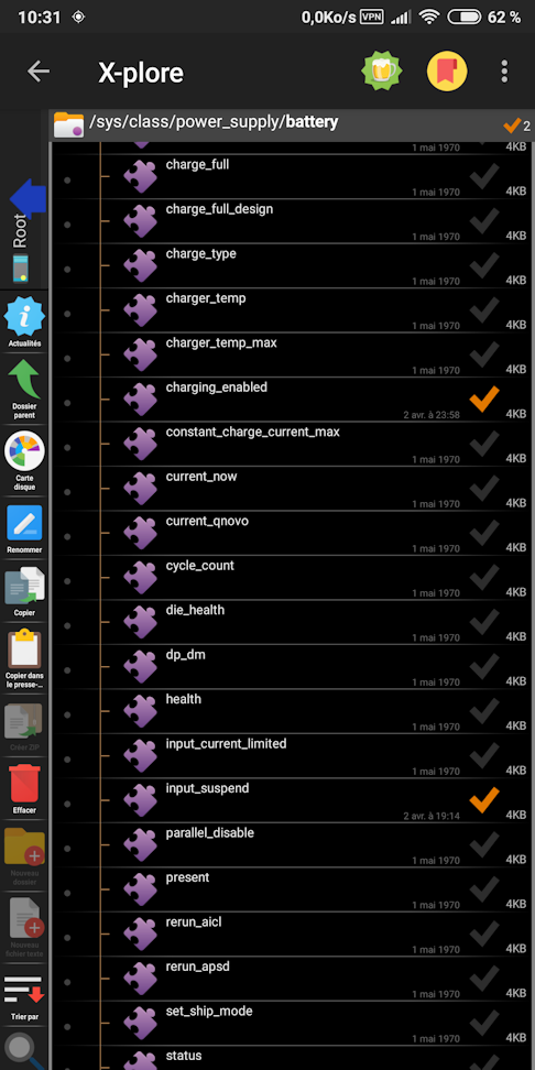

My Redmi Note 5 Whyred got a charging issue with this rom but I have no clue what it comes from: Android 9, the rom, or some bad installation (I could have missed some wipe).
My purpose is to limit the battery charge at 80% to make it to last longer.
The app Battery Charge Limit worked fine up to the previous beta rom (Android 8.1, MIUI 10.3, 9.3.14).
With this rom (Android 9, MIUI 10.3 9.3.28), it can't stop the charge any more.
I tried to set manually the content of the control files (0 in charging_enabled and 1 in input_suspend), but the system always override it with its own value after about one second. This explains why Battery Charge Limit can't stop the charge.
Am I the only one to face this issue?
Is there any way to stop the battery charge with this rom or, at least, to prevent Android 9 to override the content of the control files as soon as they are modified?

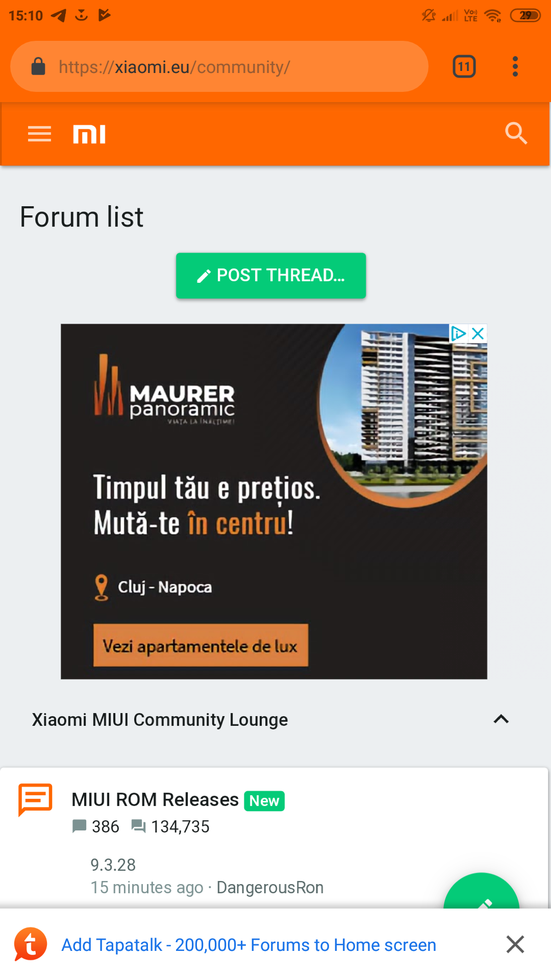

I have 29% battery. Why it shows that I have more than a half battery?
