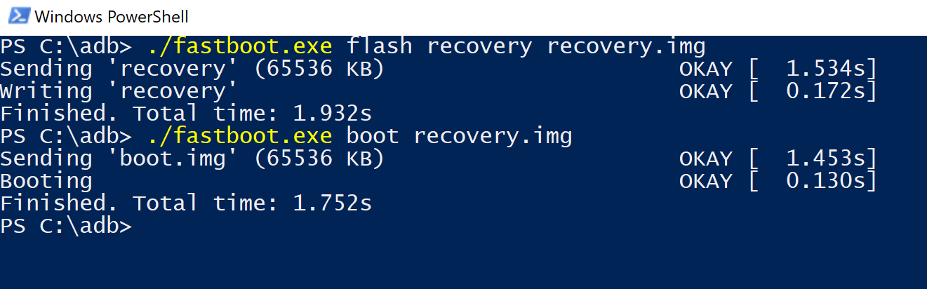

Hello. Just unlocked my mi9 and trying to install TWRP and the eu rom. When I try to boot into TWRP the phone just boot into MIUI.... Why can I not boot into TWRP?
Use the volume up and power button after flash don't do boot recovery from command line. See if that works.
Adb reboot recovery ...
