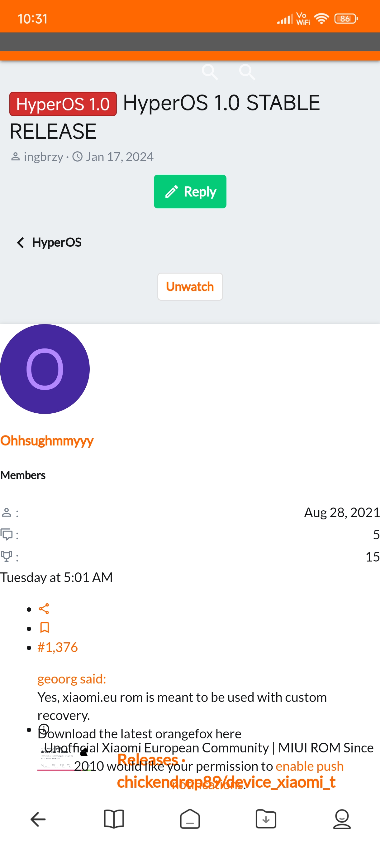

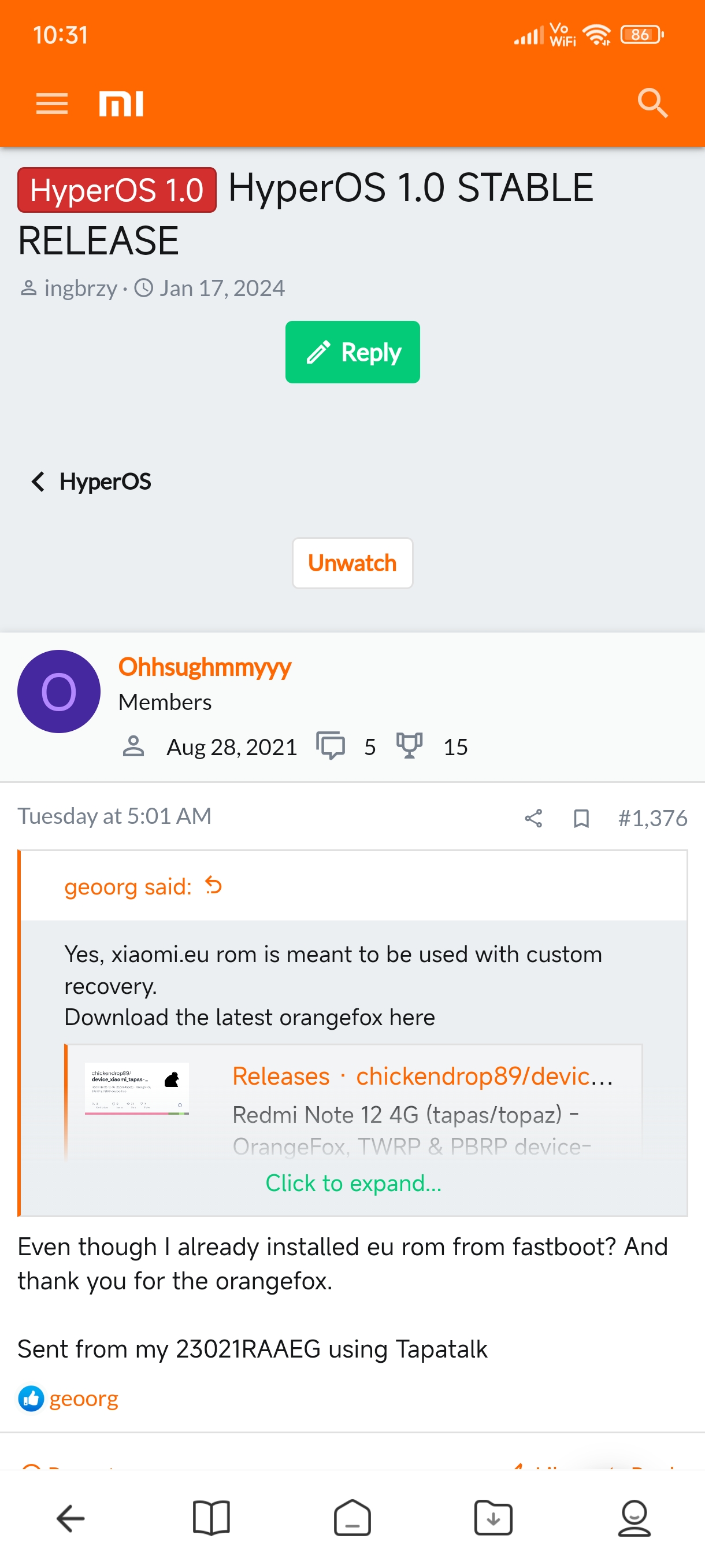

Yes, xiaomi.eu rom is meant to be used with custom recovery.
Download the latest orangefox here
Even though I already installed eu rom from fastboot? And thank you for the orangefox.

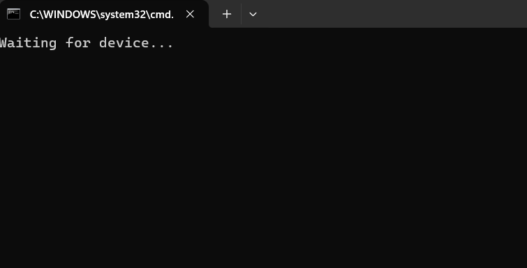

I have installed this successfully and rebooted the system, yet the cmd for fastbooting still says "waiting for device". I'm also executing as an admin and tried different USB cables.
I do get a "bleep" when I connect and disconnect the phone, as the computer understands the phone is there, but the cmd for the hyperOS doesn't.
