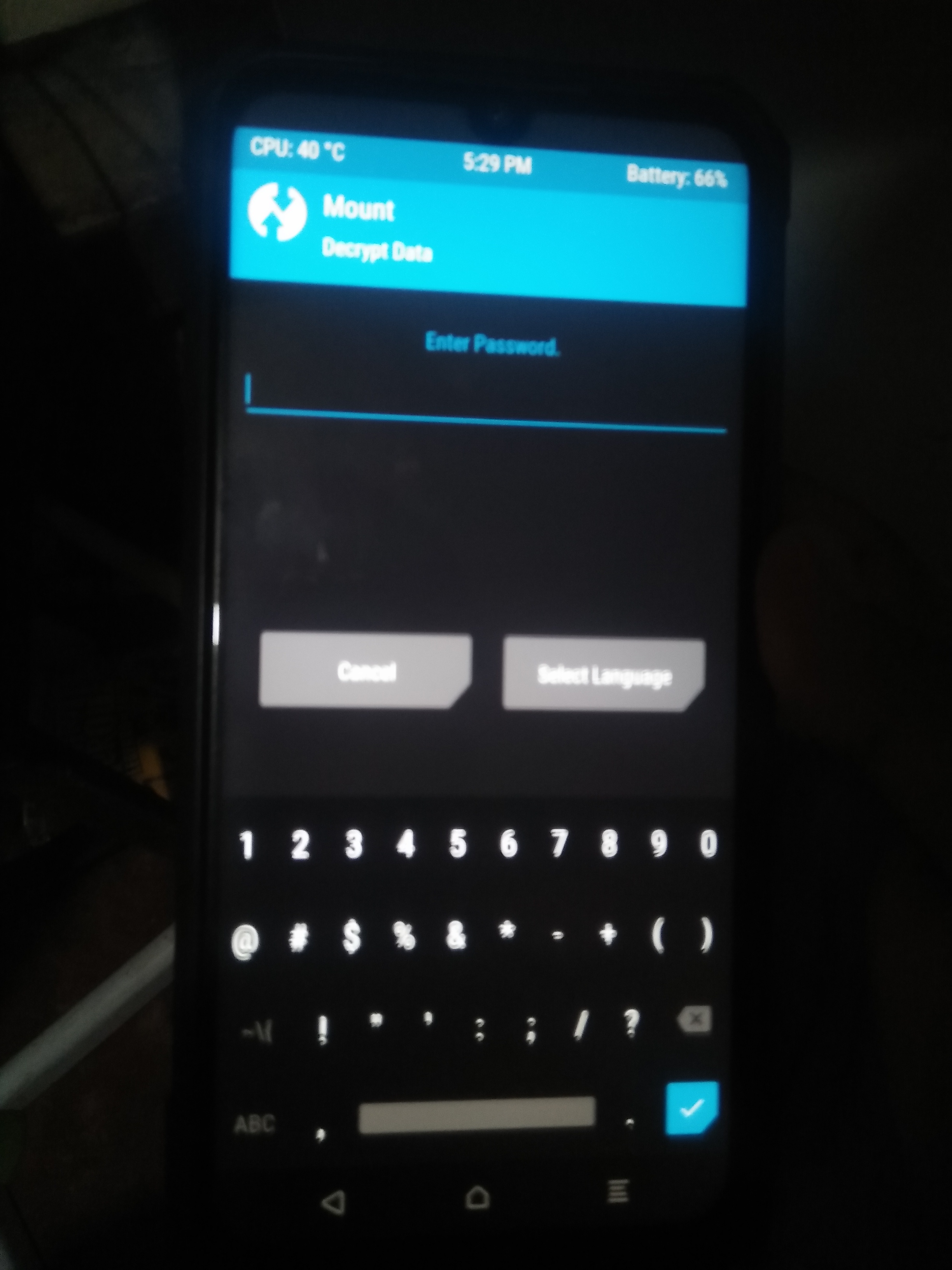

Redmi Note 7 6gb Variant Everytime i flash MIUI 11.0.1.0 on my device may data is always encrypted how to fix this problem "
