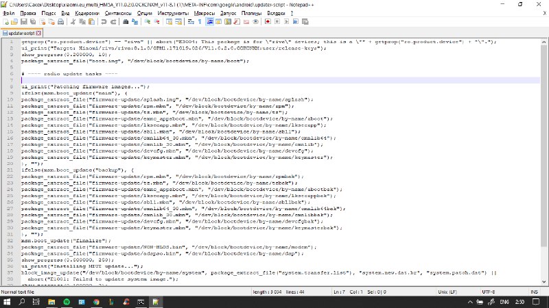

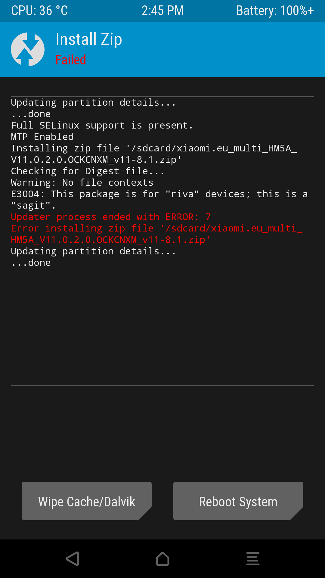

Error 7
There is no "assert" to delete, but i deleted the only one "getprop"
"getprop("ro.product.device") == "riva" || abort("E3004: This package is for \"riva\" devices; this is a \"" + getprop("ro.product.device") + "\".");"
and it didn not work
help please!
ui_print("Target: Xiaomi/riva/riva:8.1.0/OPM1.171019.026/V11.0.2.0.OCKCNXM:user/release-keys");

Error 7
help please!

Seems you have no idea what you are doing..
You have MI5, not HM5..
