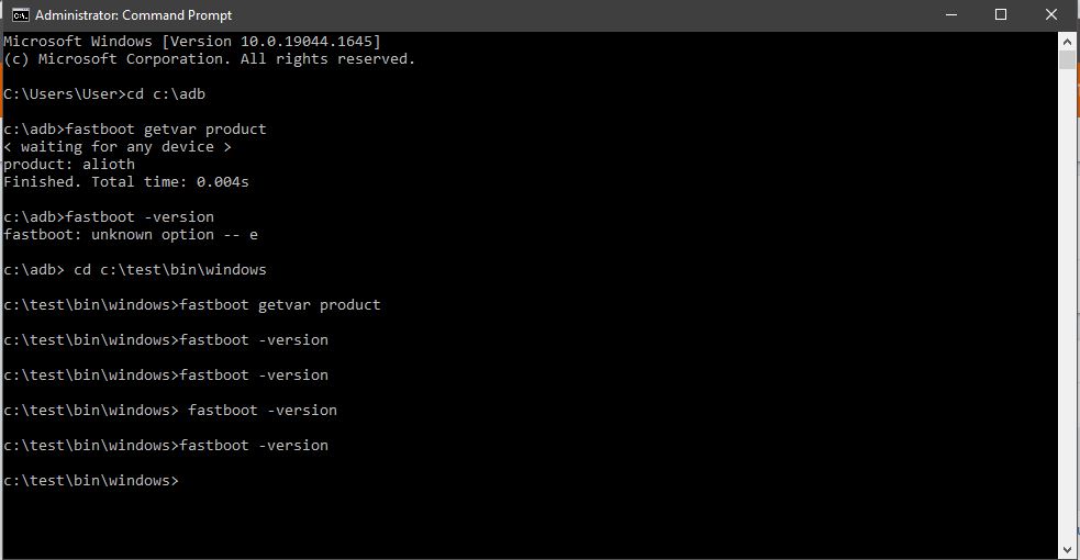

Before we delete something... Please can you check something. There must be a rootcause - some users have this problem
I think you have installed "adb&fastboot" in "c:\adb" and you have extracted the rom in "c:\test"
If you didnt install it in this pathes change the following pathnames to your directories
# cd c:\adb
# fastboot getvar product
# fastboot --version
-> give us the output
# cd c:\test\bin\windows

is delete link 7 and 8,and test result like this

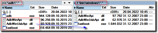

in the fastboot rom is a version of fastboot that dont recognize your device
I have missed a "-"
But it doesnt matter. You have two options:
1.) copy the fastboot files from "c:\adb" to "c:\test\bin\windows"
2.) delete these lines in the fastboot*.bat file and save it
-> delete: for /f "tokens=2" %%D in ('%fastboot% %* getvar product 2^>^&1 ^| findstr /l /b /c:"product:"') do set device=%%D
-> delete: if "%device%" neq "alioth" echo This package is for "alioth" devices; this is a "%device%". & exit /B 1
Good luck :emoji_shamrock:

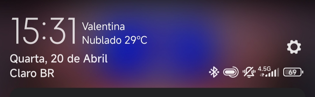

Poco F3 Europe, Working Fine 4.5g (4g+) with miui 13.0.5 and "Claro" telecom
Yup, someone replied the same thing to me the first time i posted about it, but im on a 4G+ area in Mexico with "Telcel" company, yet once i upgraded to MIUI 13 it stopped connecting to 4G+ and sticks to 4G only, once i flashed a different modem it worked again, i have tried going into settings, reboot, nothing works, its not a huge problem and i know the "solution", just mentioning to the other user that posted a similar "issue" with a different device.
