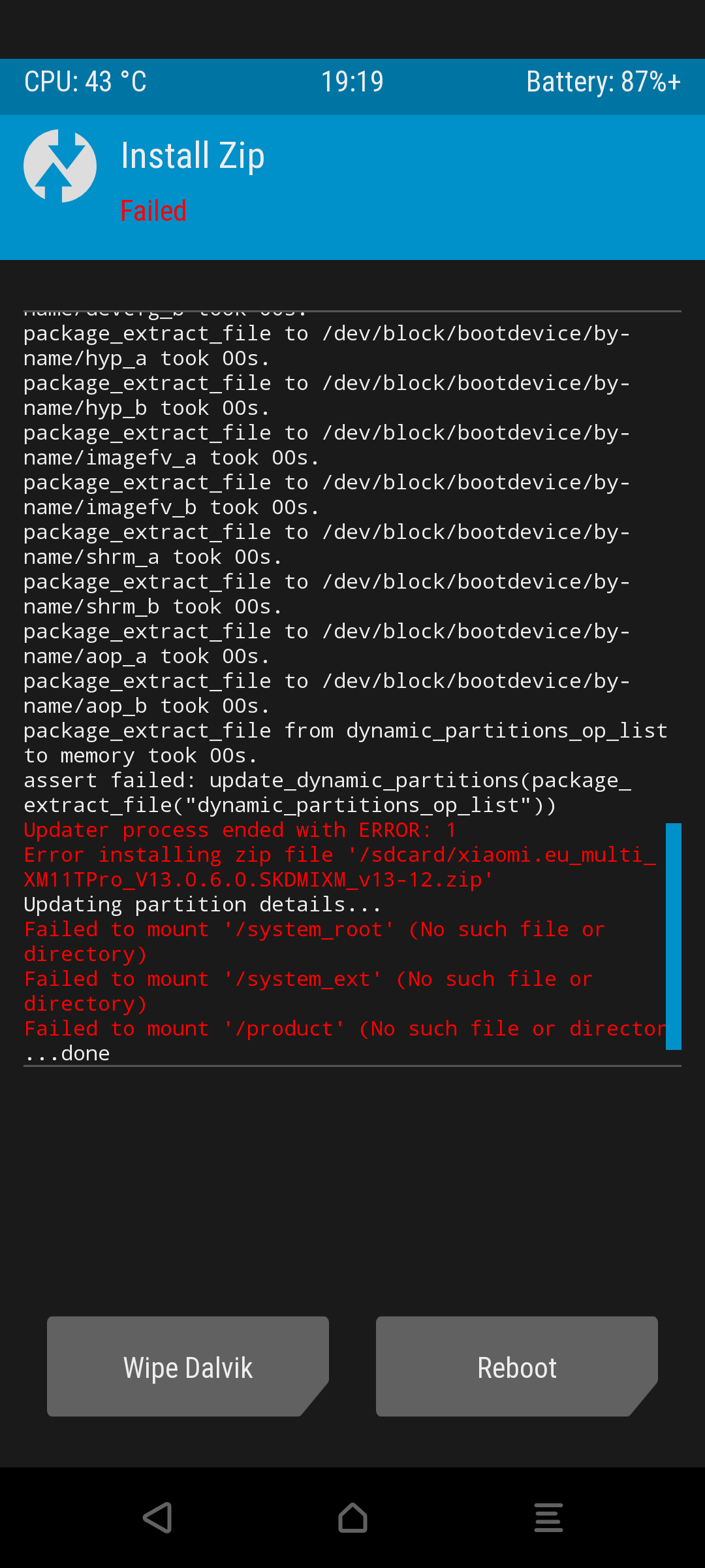

I'm having an error installing the latest version of miui on Redmi Note 10, I'm getting this error: assert failed: update dynamic partitions op list to memory, I've tried with orange fox and with this version of twrp-3.6.2_12-0- mojito-Nebrassy, and both give the same error, I'm doing it in that order, I restart the phone in recovery, data format, wipe, and I try to install the rom (I tried to restart after formatting but I also get the error message), does anyone know how solve?

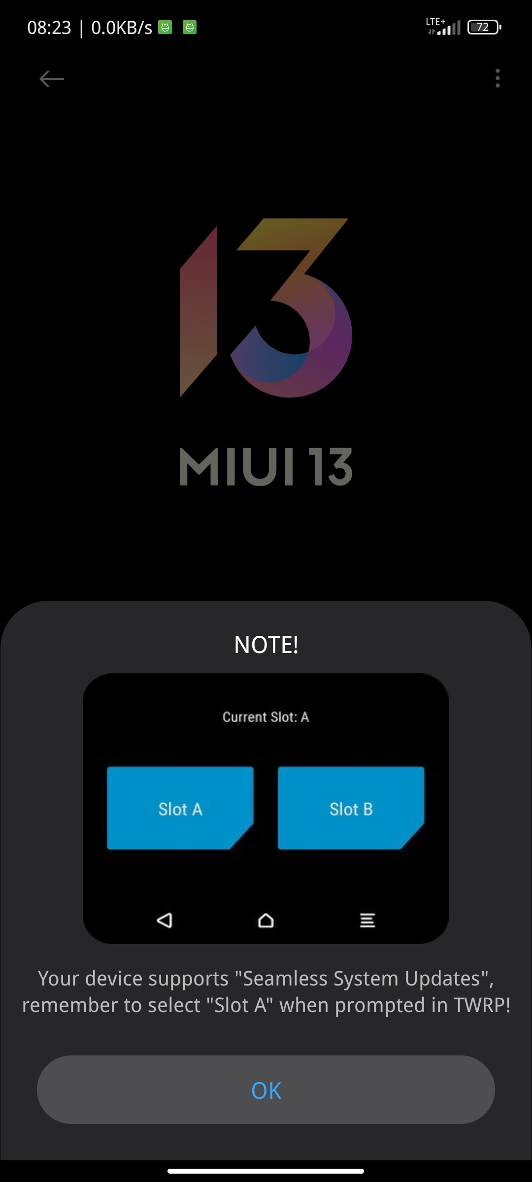

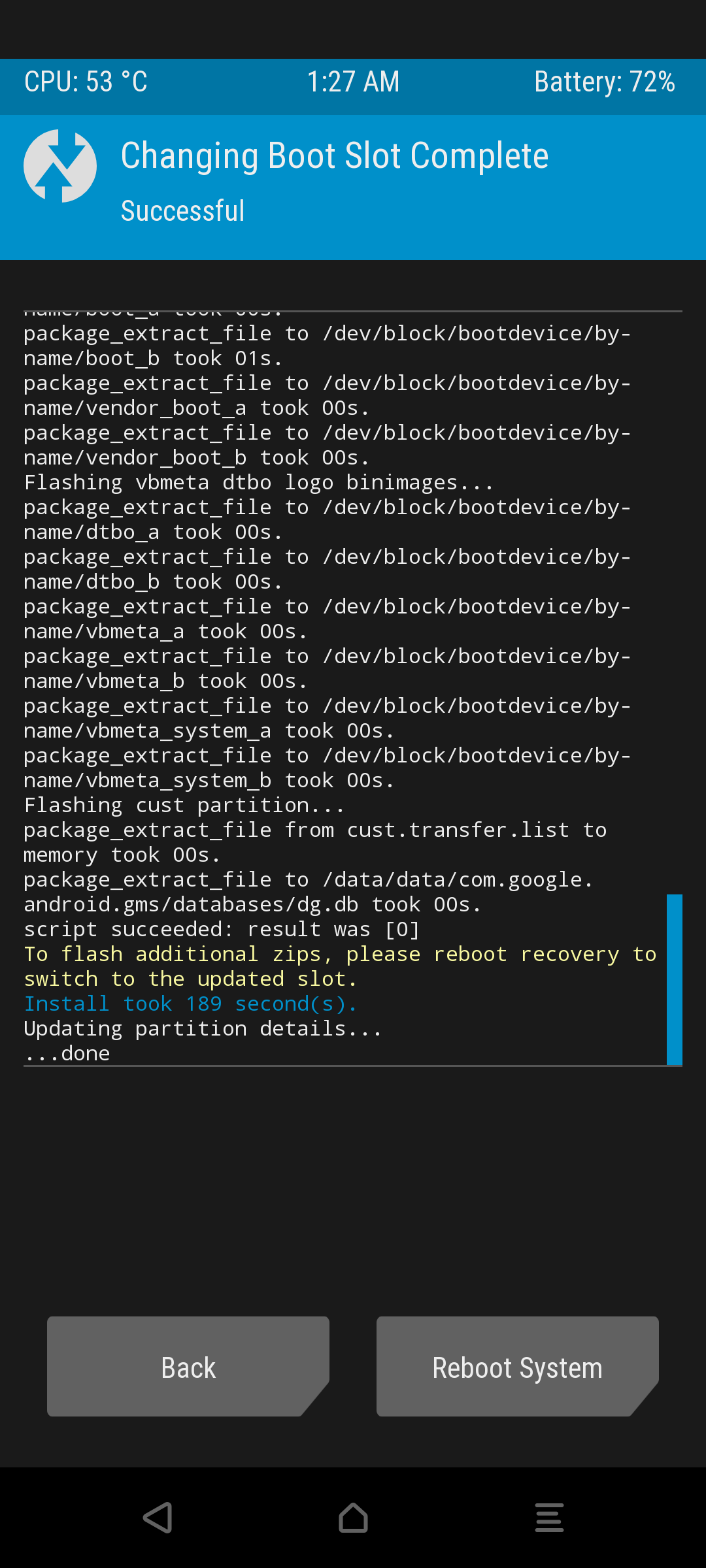

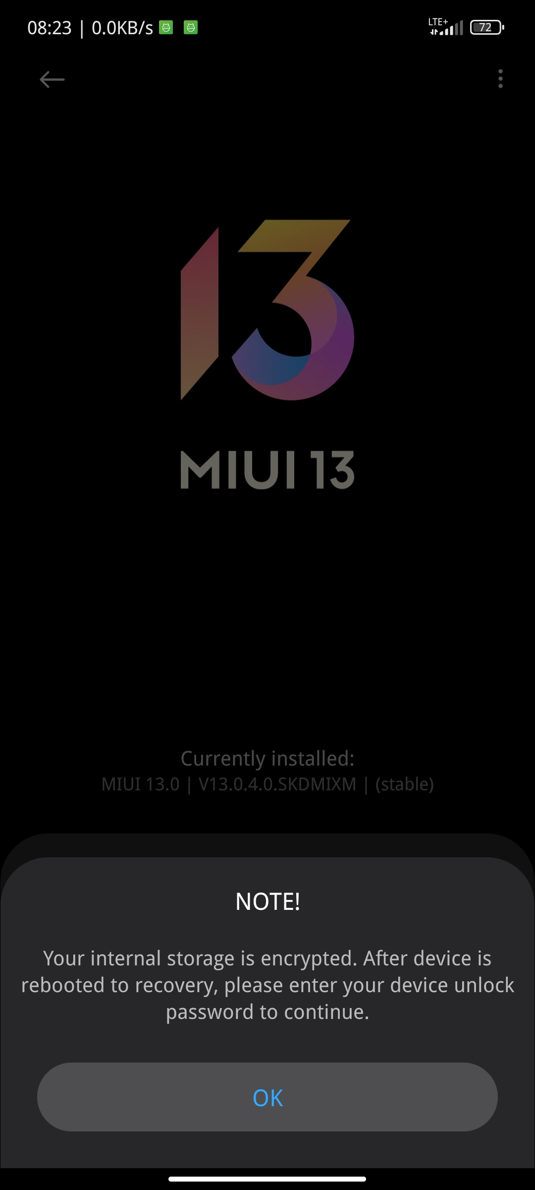

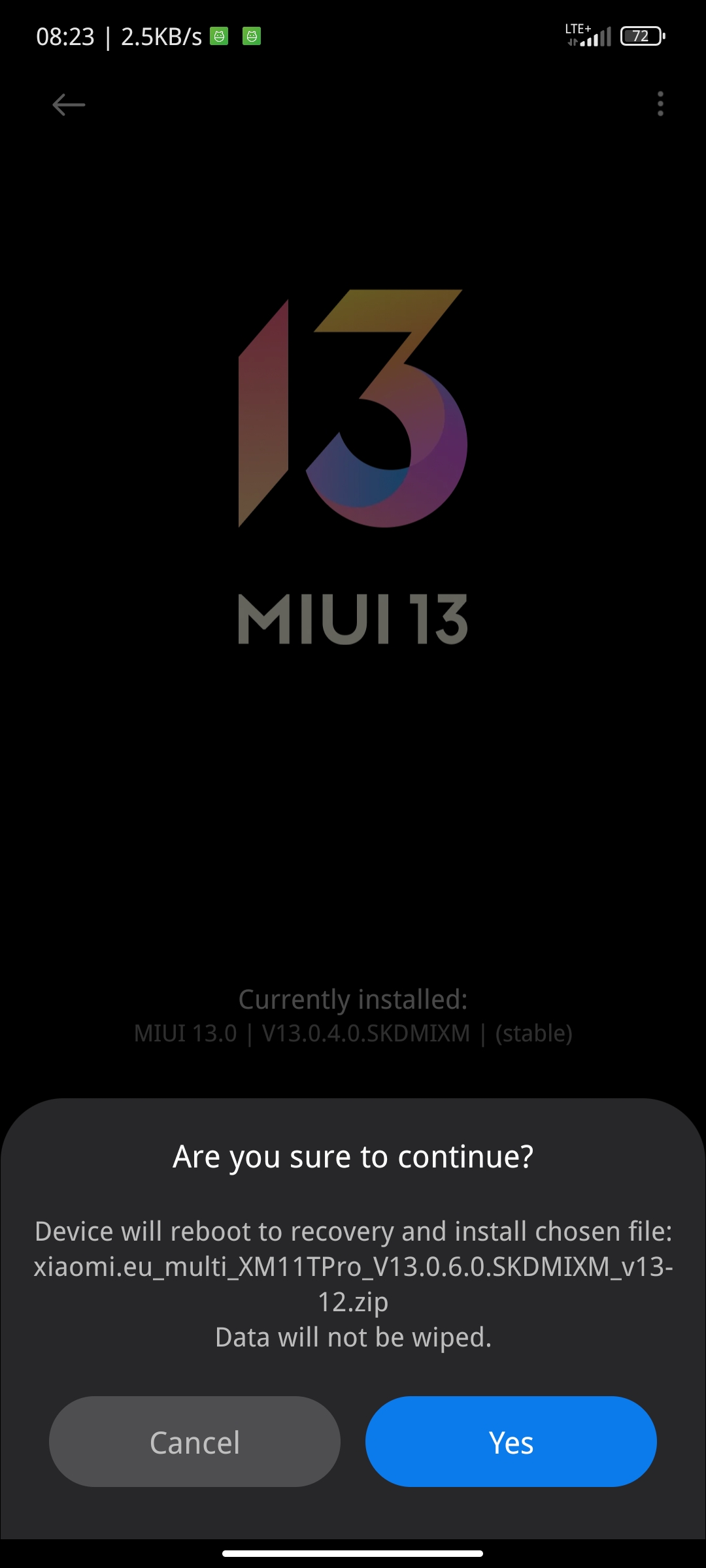

Ok... Since the Xiaomi 11Tpro have A12 TWRP, I just download update .zip file, put it on internal memory, reboot to recovery and flash, after finishing, Before reboot,I was choose A instead B ,to be able system to boot.
