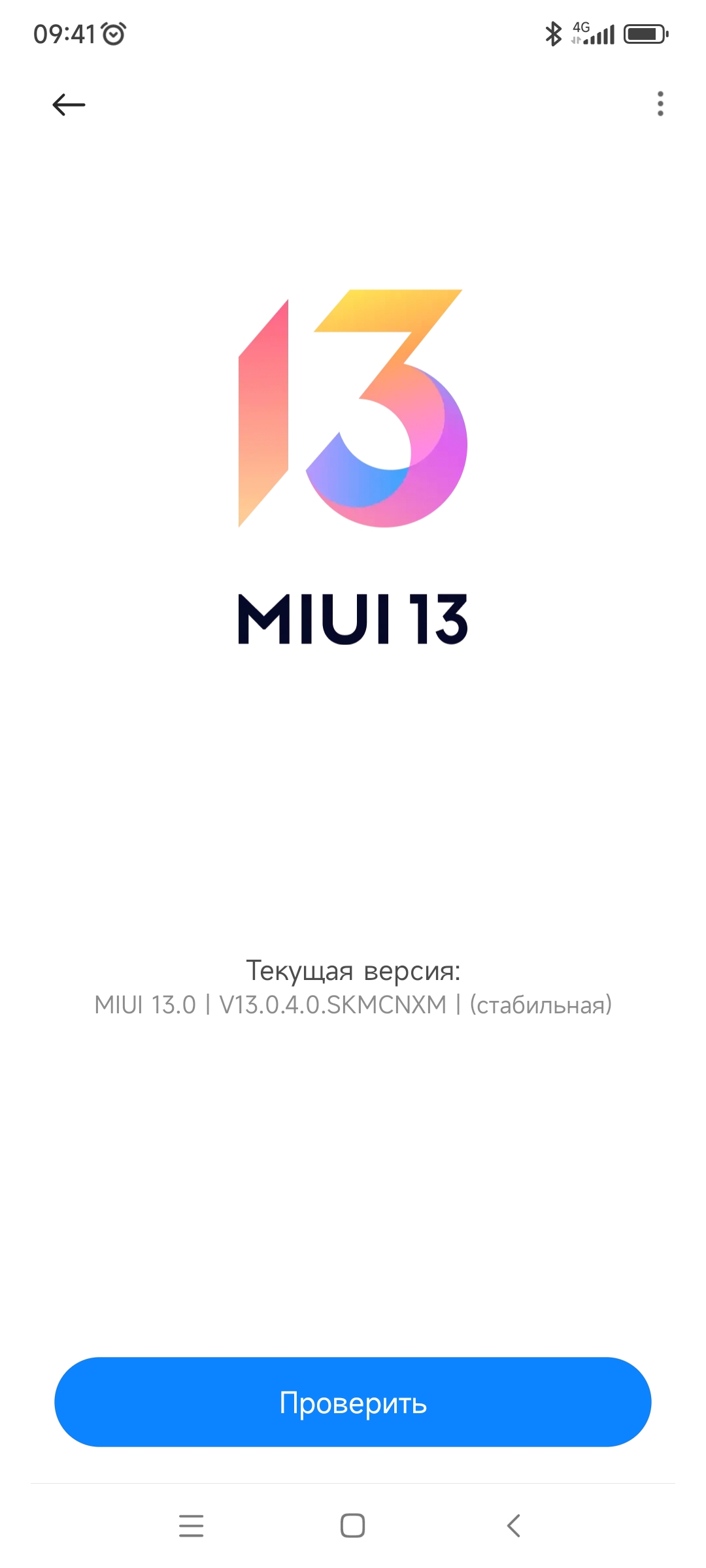

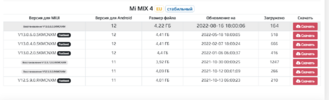

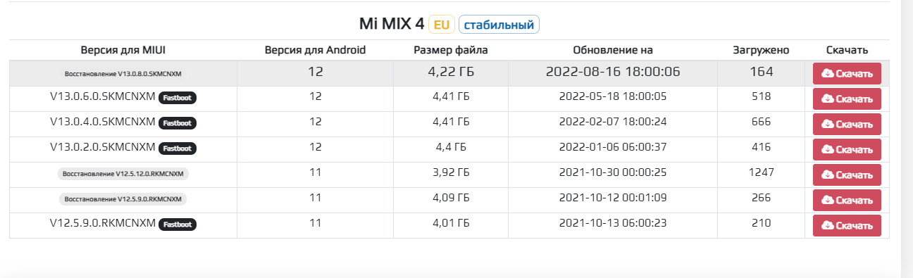

Hello. tell me to an inexperienced person, I bought xiaomi mi 4 with firmware 13.0.4.0. CN. Will it be updated? Can I upgrade myself to 8? My mi apps are not updated. What kind of firmware is this, can I install something else?

Since the last update I understood how to boot on recovery to flash the new rom...
But I really don't understand which file do I have to flash to install the new recovery, if it's possible on the MIX 4.
Describe in words what I need to do. Is my firmware bad? or do I need to change it? Tell me, will my firmware be updated over the air?
