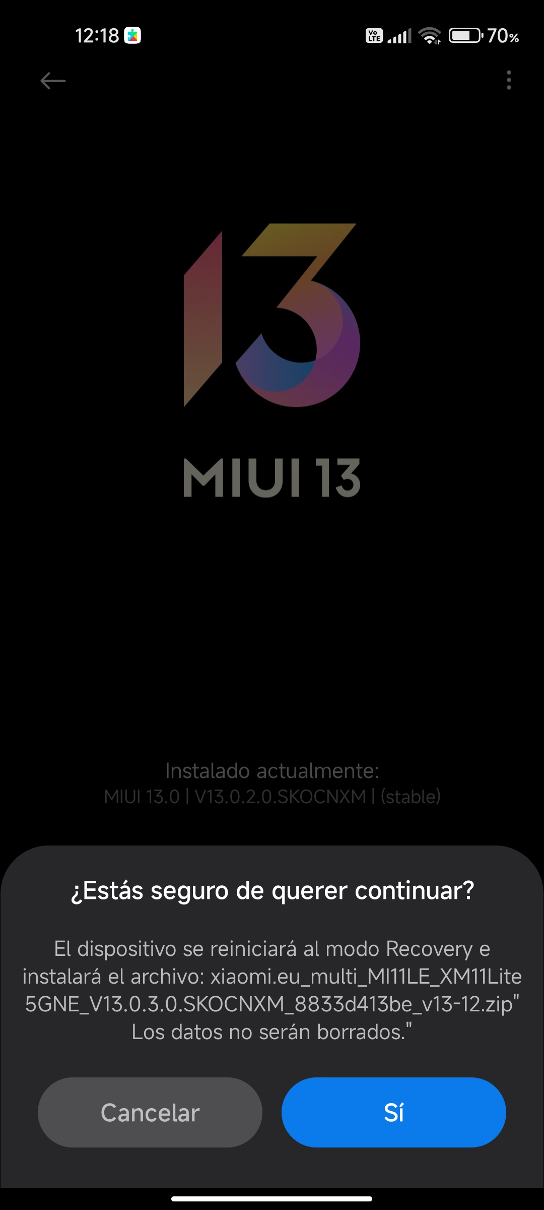

Hi, good morning, i have on my lisa device v13.0.2.SKOCNXM (STABLE) and the next one the MI11LE_XM11Lite5GNE_V13.0.3.0.STOCNXM_8833d413BE_v13-12.ZIP follows up. When i tried to download the next message shows up.
What i do???? i have stock recovery with open bootloader. If i click yes will brick de devce??
Thanks a lot.
