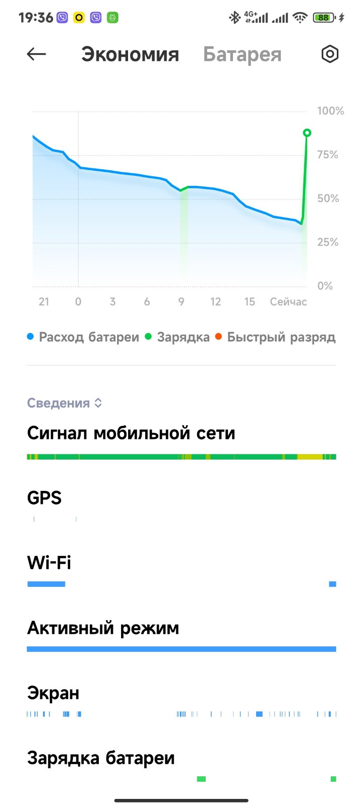

Hello. Phone POCO F3. Updated via fastboot on miui 13.0.2. The phone doesn't sleep. The battery compared to 12.5.19 is twice as bad. On 12.5.19 it was enough for 48 hours, now for 15-20 hours. Because of this, I want to go back to 12.5.19.
The phone slept after the firmware, but after an hour or two, the battery discharged and the phone stopped sleeping ..
.1. With what it can be connected?
2. Could it be the fault of the root of the law?
3. We saw DEV 13.0.2.1.1 (Chinese) released on POCO F3. When can we expect from eu? can they fix it?
4 How can I return to 12.5.19? (First load TWRP for A12, make the date format, then download TWRP for A11 and flash 12.5.19?
while writing a post, the phone was charged up to 98% (min 10), it's probably very very fast .... on 12.5.19 everything was fine, and charging was slower
1. No idea. We don't modify anything related to battery, device sleep, kernel or firmware.
2. I'm not familiar with that "law".
3. It's the new format for Public Beta, not Stable. Not relevant to this thread.
4. I would just flash a fastboot ROM of official China 12.5.19 first (with data format and without locking bootloader), then boot to TWRP and flash Xiaomi.eu.

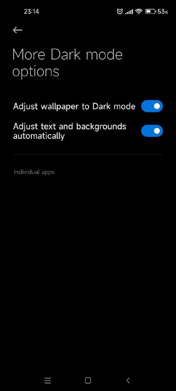

Hi, how do I force apps to be in dark mode with this ROM? "Individual apps" list seems to be empty, is this a bug?
