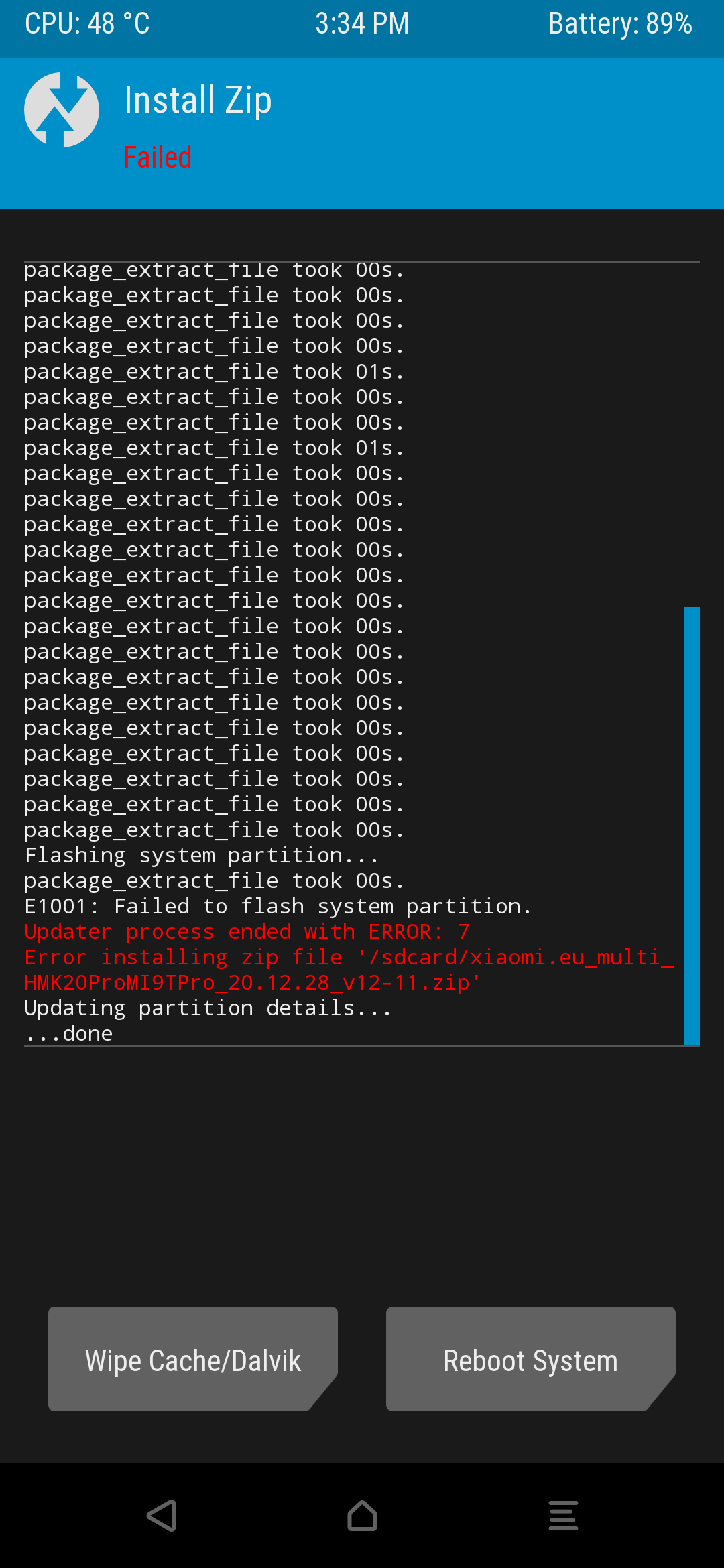

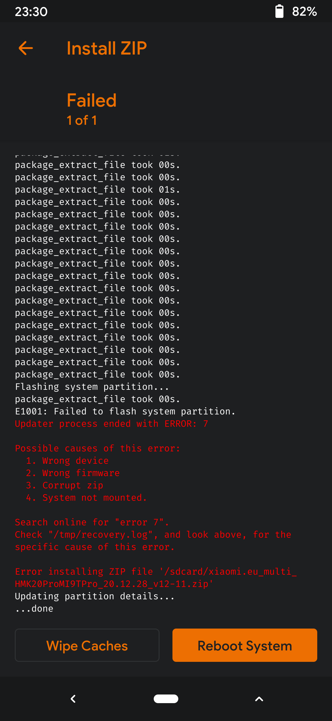

Can't install on K20 Pro Premium via TWRP 3.4.0-1
Anyone knows how to pass this problem?
Previously installed -- xiaomi.eu_multi_HMK20ProMI9TPro_20.12.9_v12-10.zip
Trying to install -------- xiaomi.eu_multi_HMK20ProMI9TPro_20.12.28_v12-11.zip
I'm using dirty flash

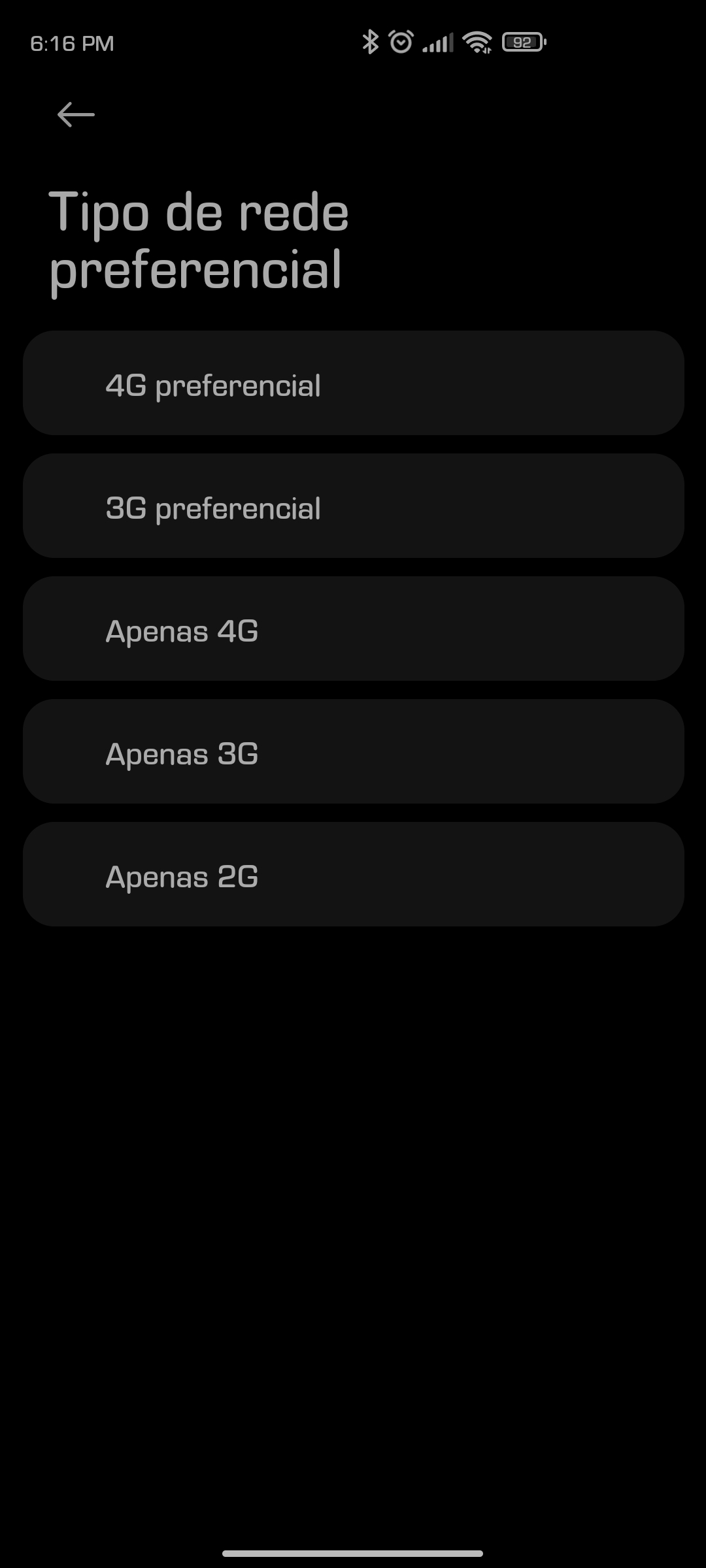

But I have one issue. When I try enter in the "wallpaper and personalization" nothing appears. I try click here and dont go in this thing.
Hi friends. I did a dirty flash in my mi9. The rom works great, thank you all.
i came here to say the same thing, same problem with k30 5g
and when i try through the launcher, it opens the theme store

I think something wrong with the configuration file in the ROM zip
could be, there is some error with the rom too, like in some devices you cant open the wallpaper configs in the configuration.
i googled and found some things, error 7 in different model,
a guy wiped and worked, and a indian guy on yt erased some part of update.script and worked too.
and another tried something with mi flash.
cold be a bug due to shared rom
