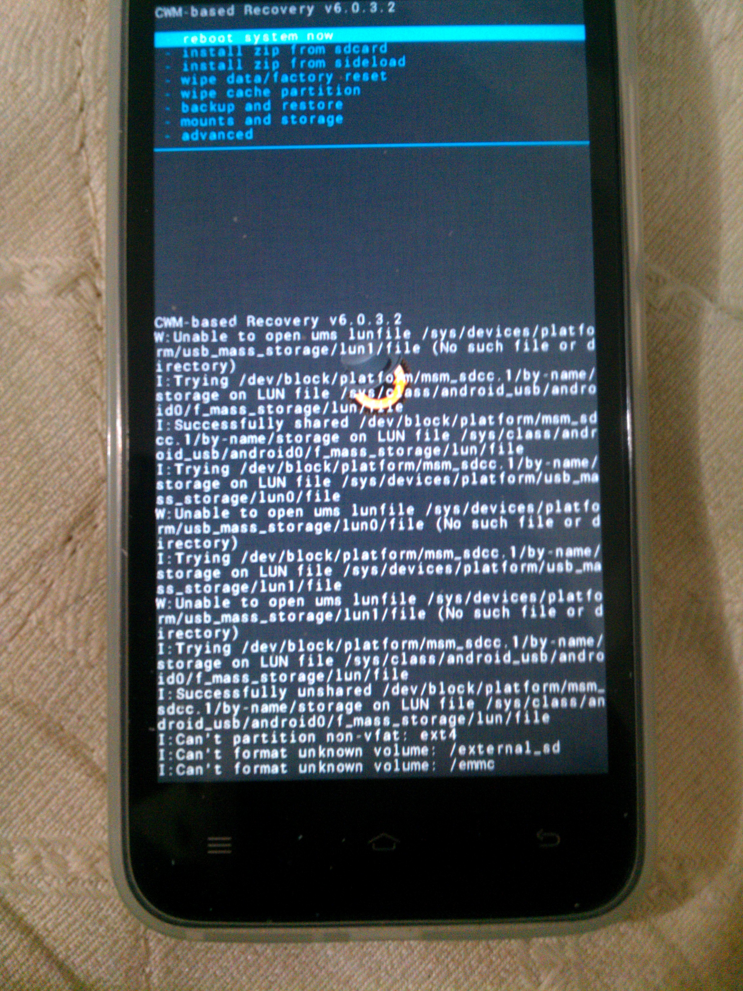

Mount USB not working, even in Ubuntu or Windows
(log attached)
