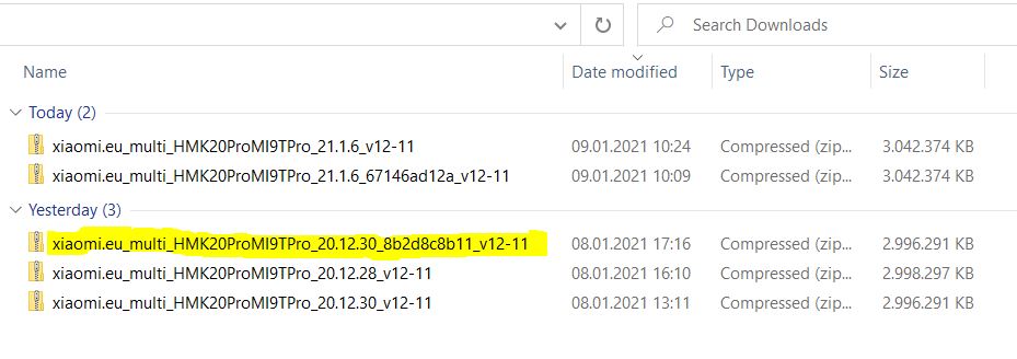

My Mi9TPro/RedmiK20Pro has seen now 5 ROMs over the last 24 hours.
First, I thought, it's just me, but then I saw that many comrades had similiar issues on their different devices.
One of the things I noticed is this message in TWRP right at the beginning of the flash process: Enablefilecrypto_failed
Other attempts ended in error 7. (That's, before I flashed the latest TWRP with ADP fastboot.)
Only one of the 5 seems to "kinda" work. So I had to go back to this highlighted version:
33909
I just flashed it, and the device booted up properly. It took unusually long, though.
I am using this TWRP version, now: twrp-3.5.0_9-0-raphael.
Apparently, the flashing wiped all data and apps, although I did not (!) want to do that. It happened automatically!
So, after restoring my apps from the cloud (again), I will have to live with the little bugs for the time being, I guess.

After wiping the entire device again and formatting everything (again), I was now able to clean-flash xiaomi.eu_multi_HMK20ProMI9TPro_21.1.6_v12-11
onto it.
