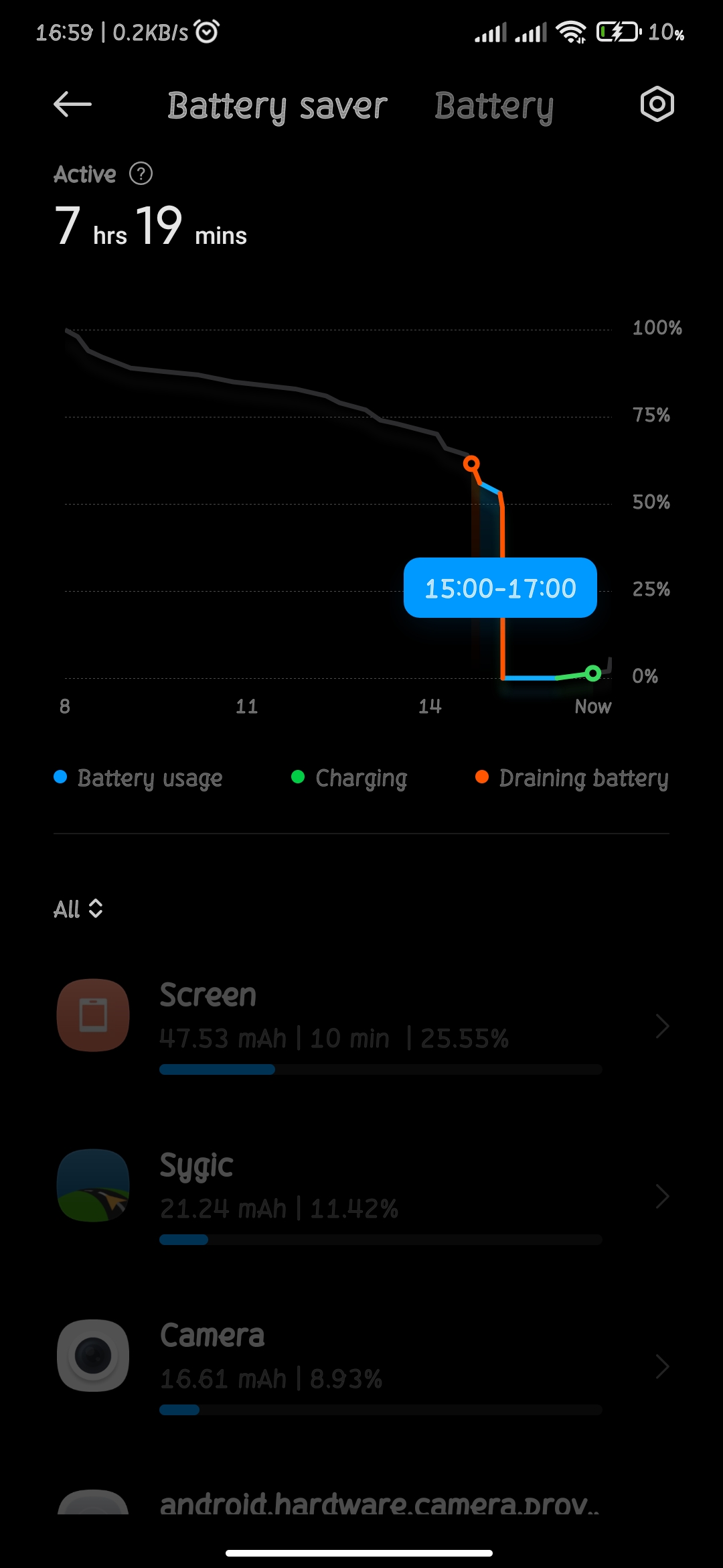

my mi9 discharges the battery and turns off when using the camera for a few minutes
