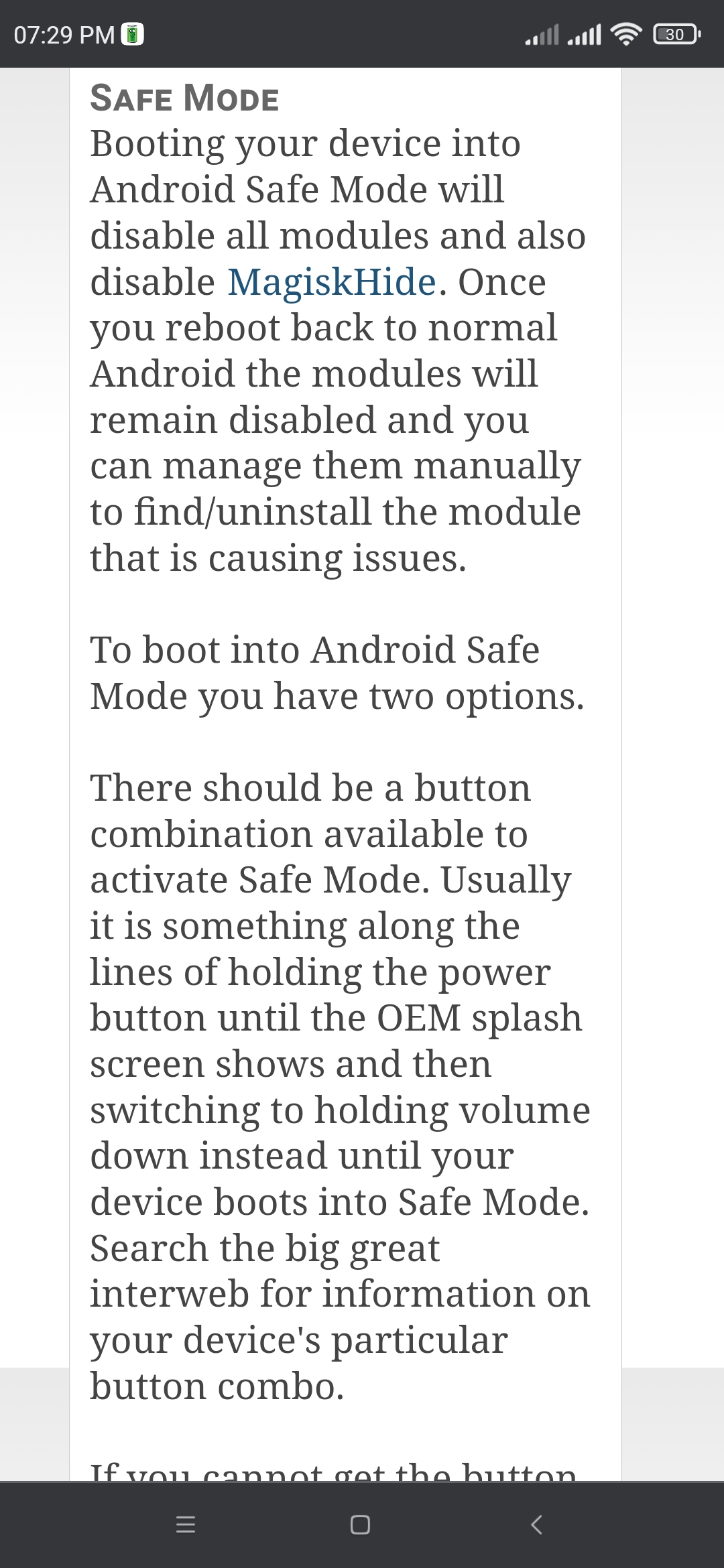

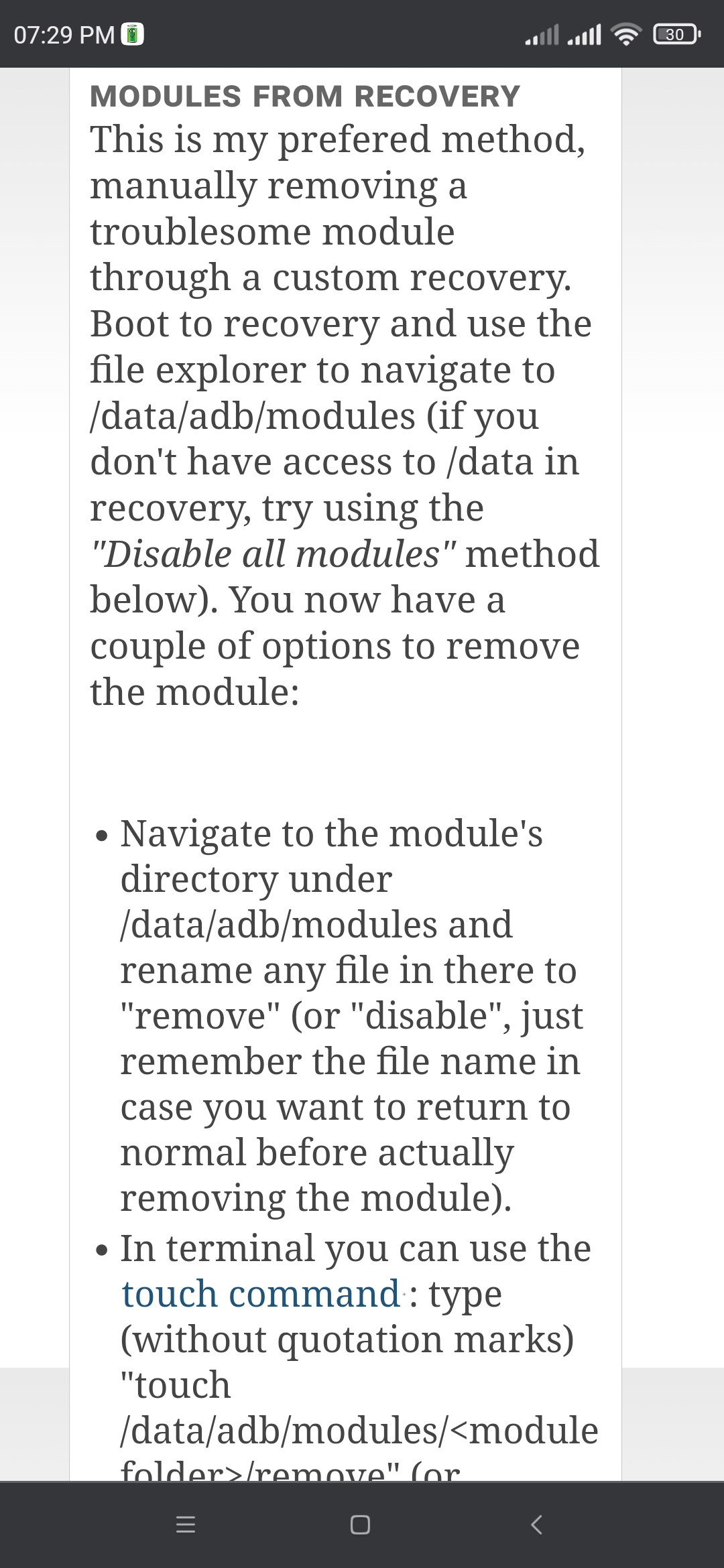

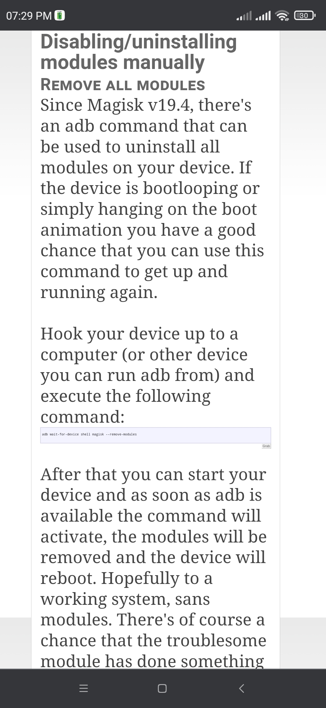

Did everything and tried various magisk versions, but I can not root my Mi9tpro. It always goes back to recovery.
Without flashing magisk, it boots up
Before updating, in future better disable your Magisk modules, and then selectively enable them after updating and reinstalling Magisk
Magisk modules resign in /data/adb/modules, hence updating the ROM (System partition) or installing Magisk (Boot partition) will not affect them and if one of them is not compatible with the updated ROM, it will cause bootloop when you next time boot with Magisk
Now, you have several options to disable or uninstall modules causing the bootloop (TWRP, ADB, Safe mode), read in Magisk Wiki (btw, available from Magisk Github, and therefore simply linked and accessible from the Magisk app):
Scroll down to the section:
Modules causing issues... bootloop...

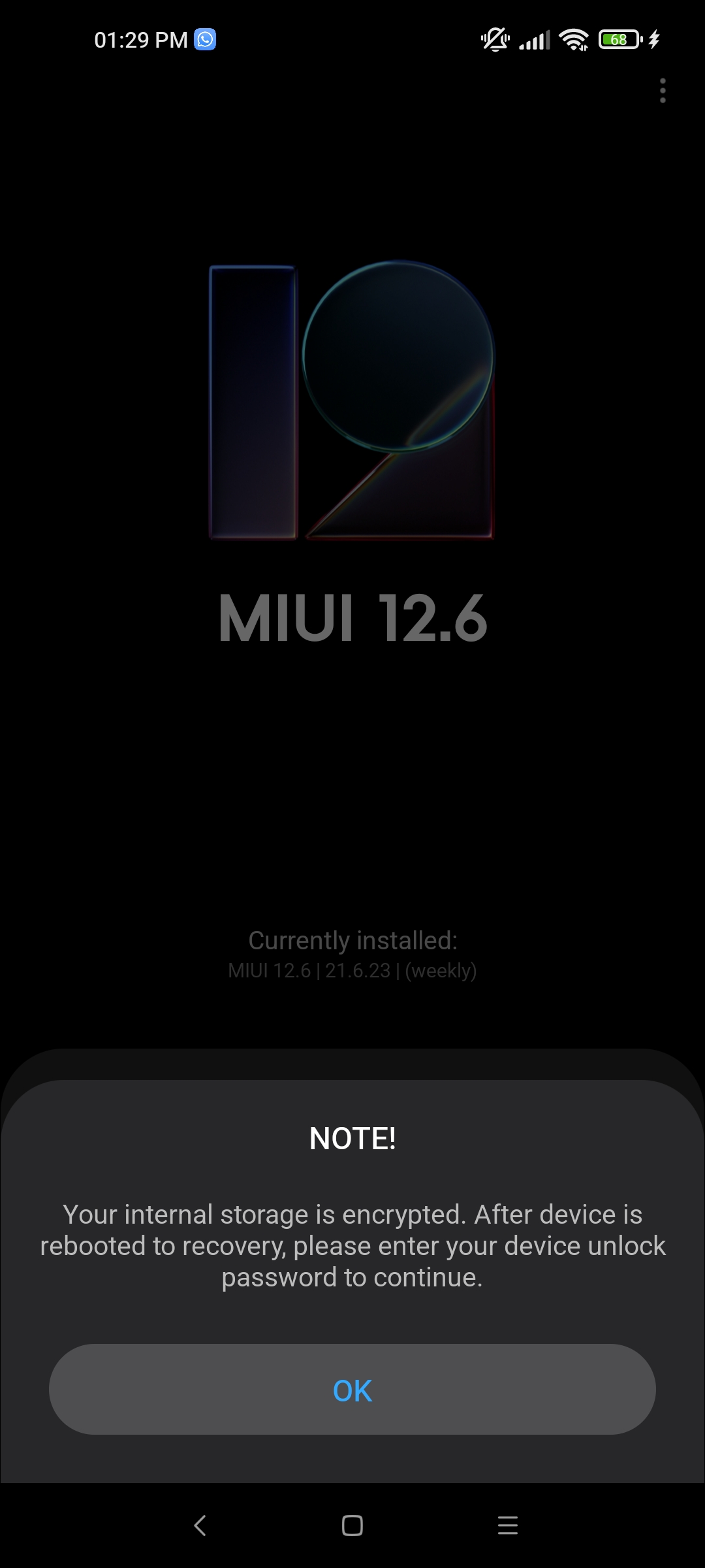

I am having this problem and don't know how to fix it... Is my first time updating via OTA and is asking for a password, which one I don't have knowledge, please help
Better write your device name to have an accurate answer. The message you see is not an error, it's informal only. :)
