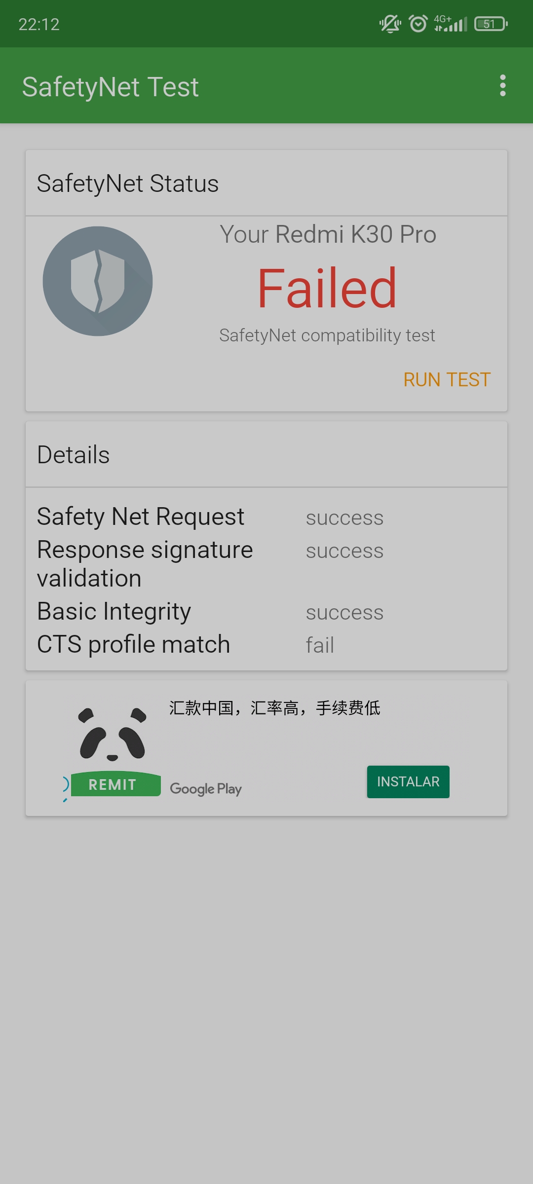

safety net test is not passing with this version on poco f2 pro..

== How to pass SafetyNet "CTS" test (trick for the SafetyNet update of September, 2021) ==
/!\ LSPosed/EdXposed and XPrivacyLua modules are NOT needed /!\
From an info on XDA (thanks @Displax), you can use an old workaround to pass the SafetyNet "CTS" test by simply changing the "ro.product.model" prop of your device!
Here's my Magisk module (it will change the model info to "Xiaomi device") => Fix_CTS_SafetyNet_v1.0-Magisk.zip
UPDATE: Here's my zip version for TWRP (it may only work on old devices chipped under Android 9 and below) => TWRP_Fix_CTS_SafetyNet_v1.1.zip
NOTE: You can also reinstall my zip version for TWRP to remove the workaround. :)
IMPORTANT: Do not forget to clear all data of "Google Play Store" , "Google Play Services" and "Google Service Framework" apps in phone's settings then reboot your device.
