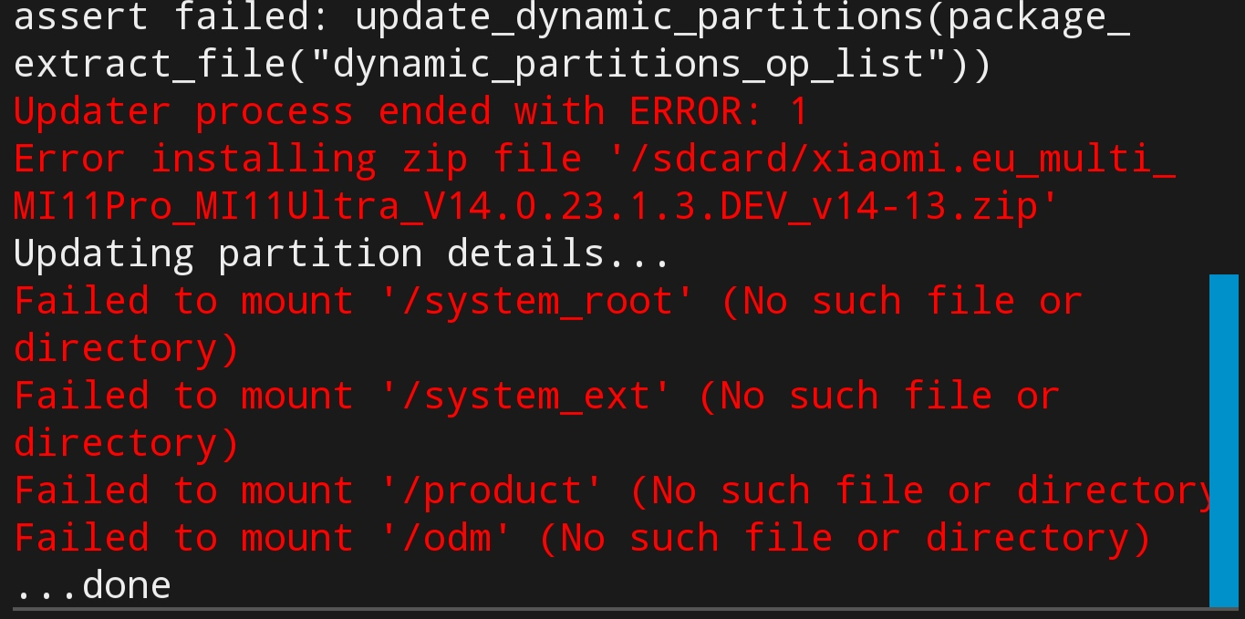

Hi everyone.
On my Xiaomi 12 with 22.12.26, twrp-3.7.0_12-v6.7_A13-cupid-skkk installation is OK.
But during ROM installation the attached error appears. I reboot TWRP and try again, but the error reappears. 2, 3, 4 times.
And phone boot always in fastboot.
Then I must install ROM 22.12.26 in fastmode.

Hi everyone.
You tried only 4 times? I once had to reboot and try again 15 times. It will install eventually, keep trying.

Hi everyone.
dude wrong rom :eek:
