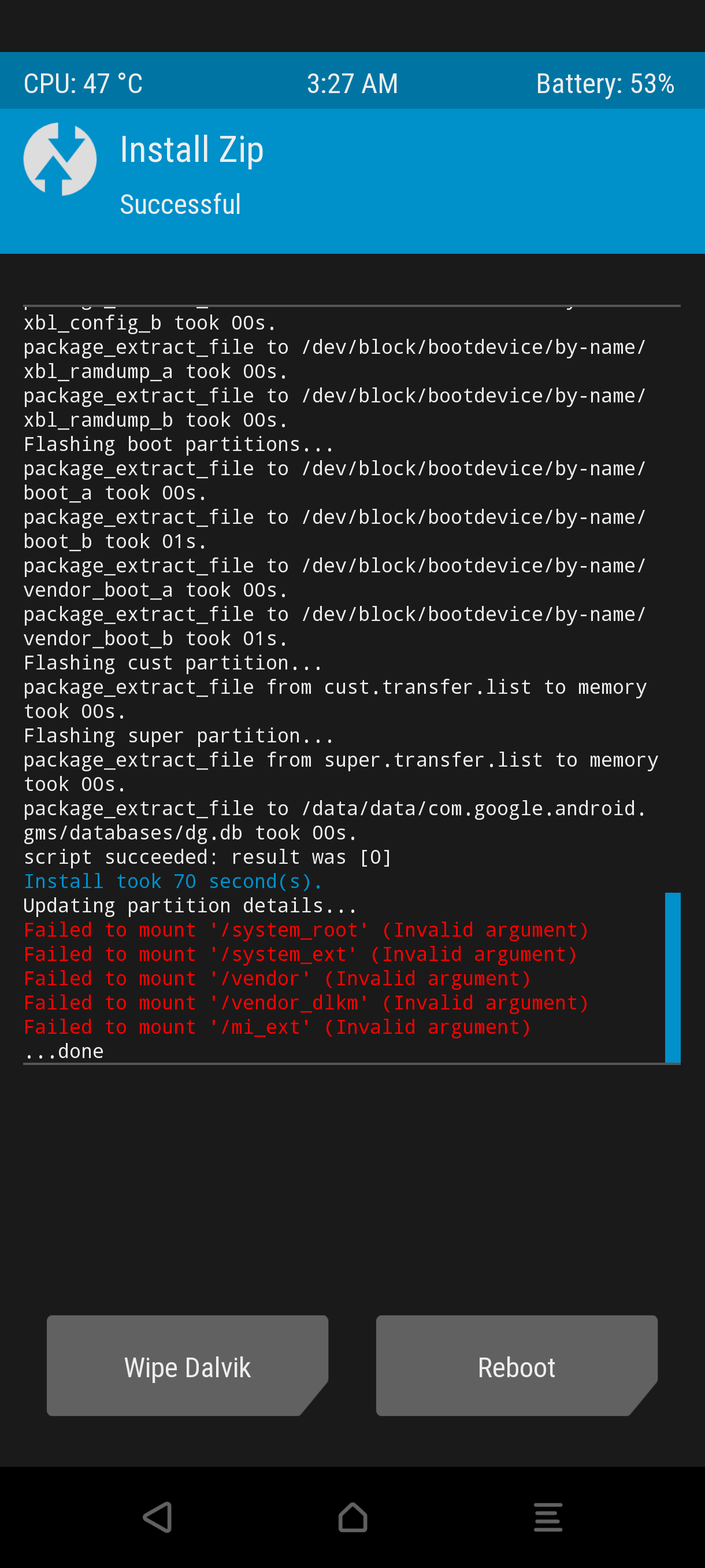

Mounting errors after flashing on MIX 4 as well:
I´ve had these errors too, after rom update with TWRP 6.7. I could reboot the system and the new rom was installed. But with the red point, that i have to update the rom. When i tried to update, it shows, that the newest version is on my device. So i´ve installed TWRP 6.8 (Advanced/ Install recovery ramdisk) and installed the weekly again and all was fine. I thought, it depends to the right recovery. 6.7 is removed from sourceforge in the meantime.

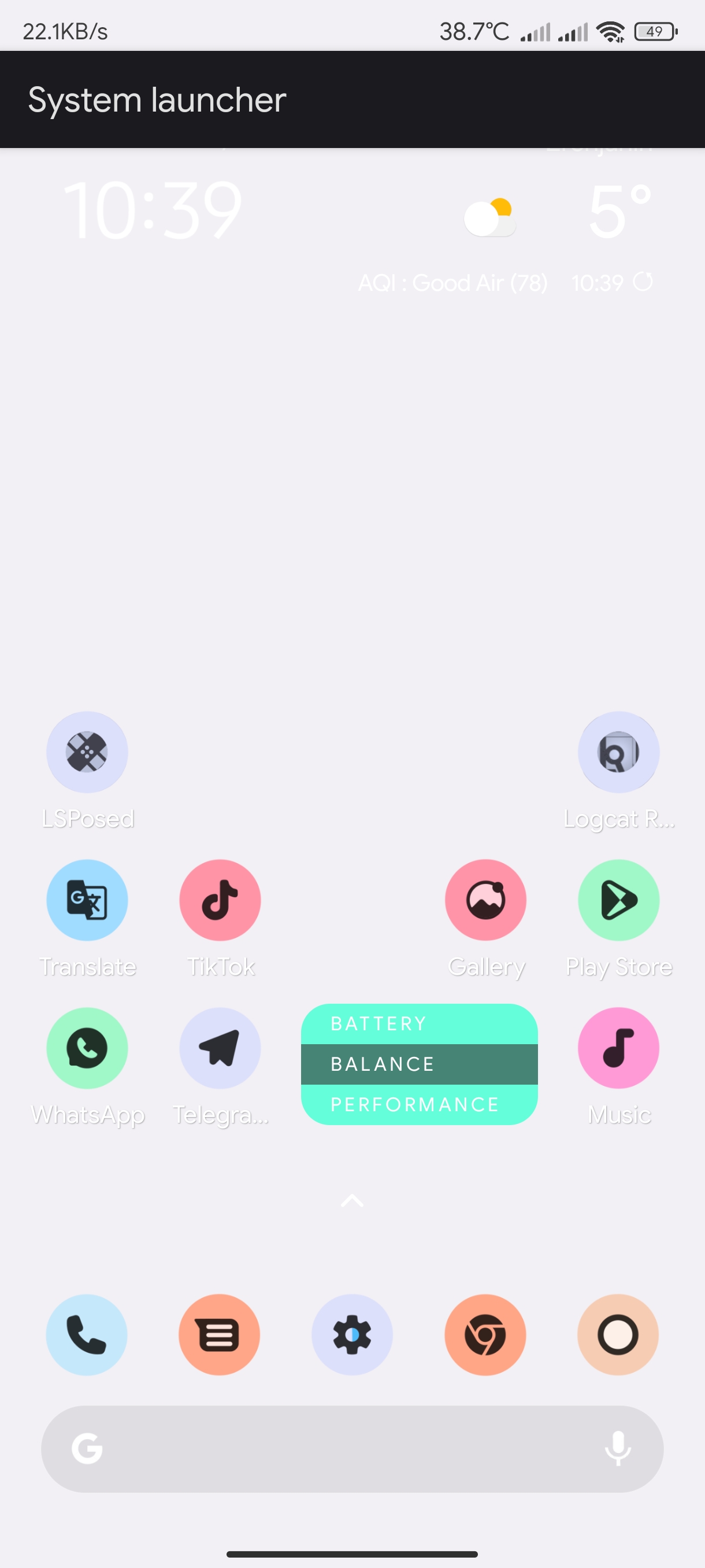

Another bug with launcher , Diting

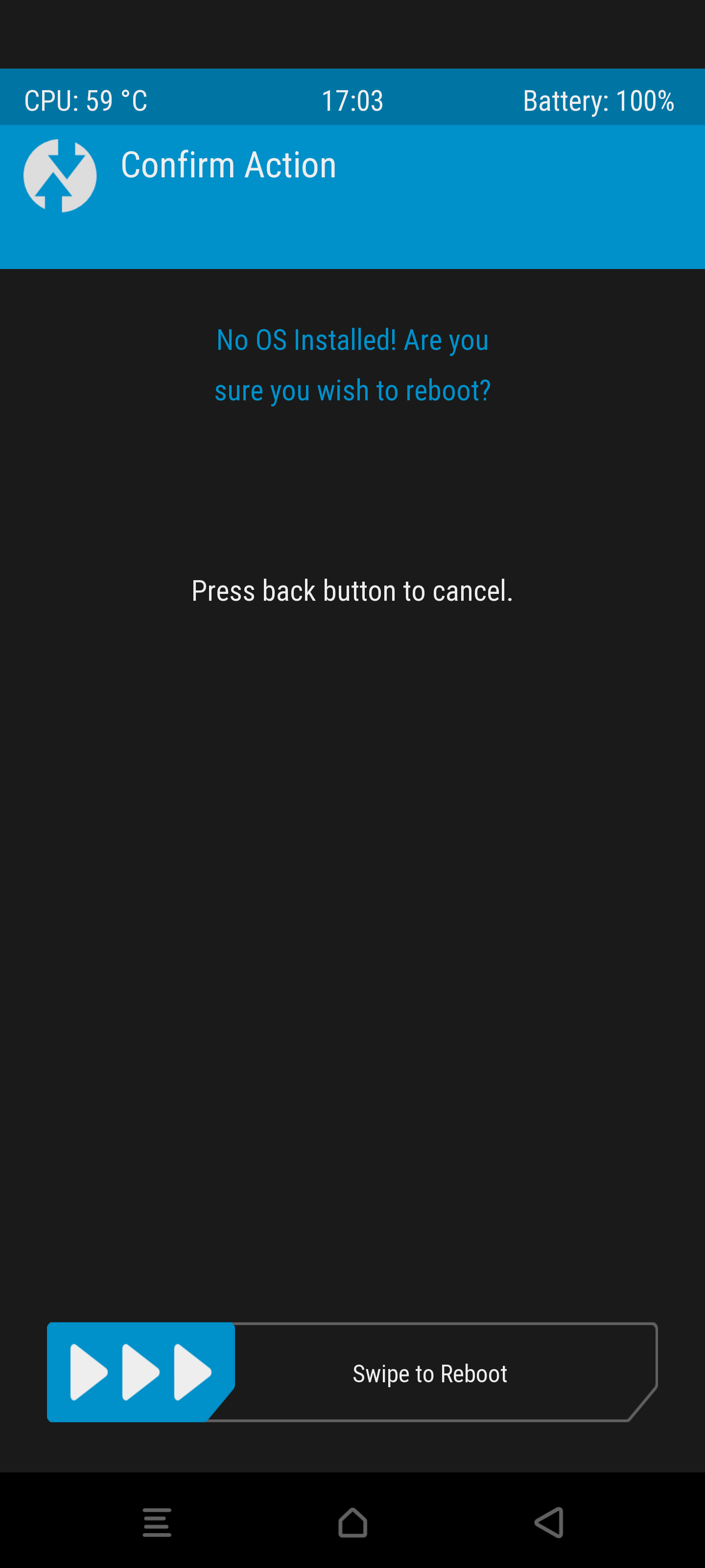

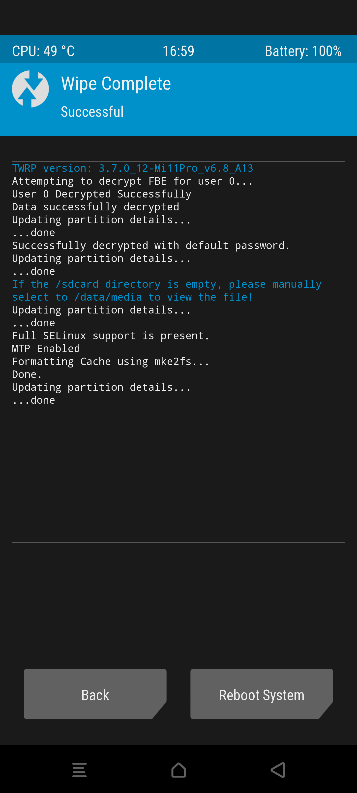

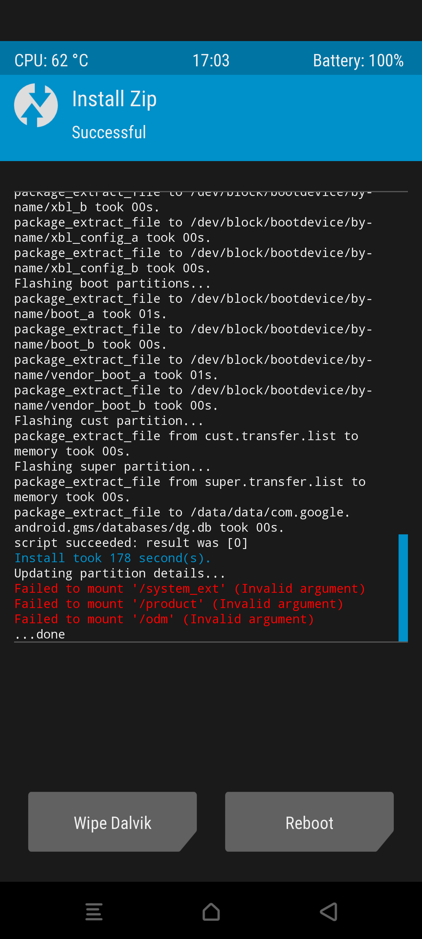

Update from 22.10.26, TWRP 6.8.
The first attempt ended with an error and a message that there is no system. The second attempt was clean, but the system did not start - bootloop.
Looks like it won't work without format...
