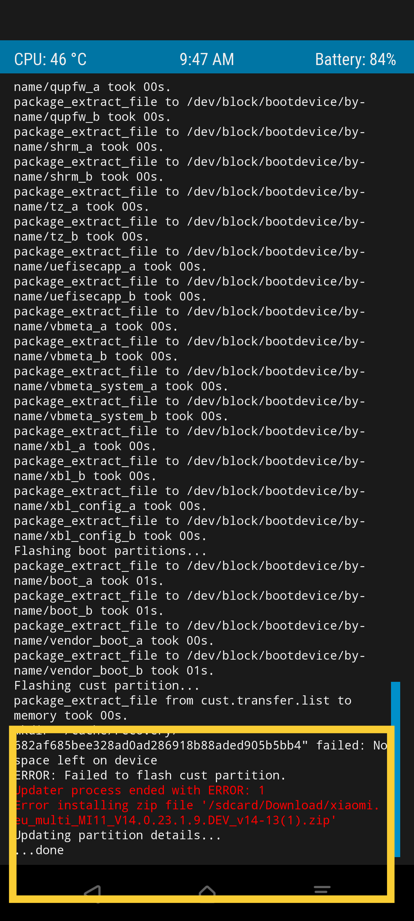

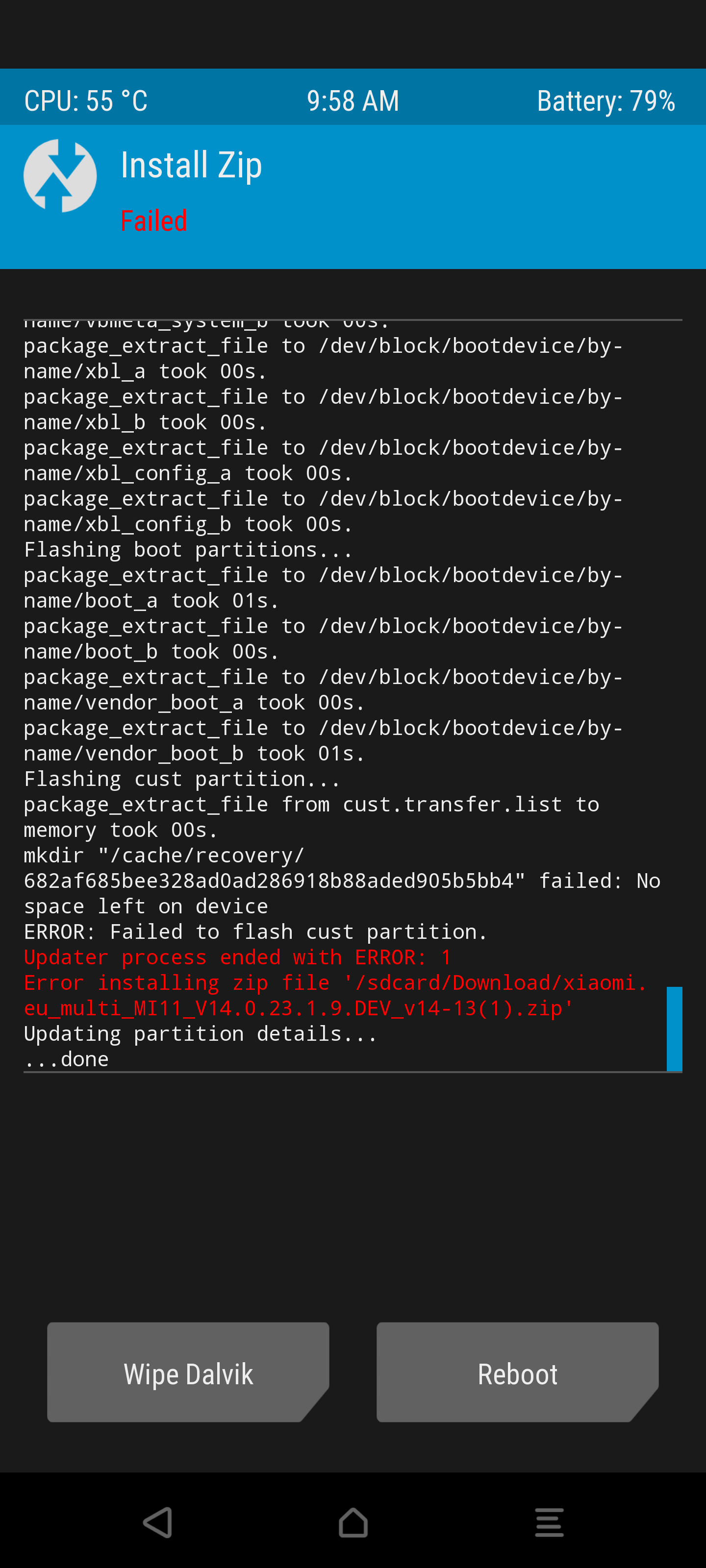

Installation shows "script succeeded: result was [0]" (0 is status code for "no error")
What's failing is the "Updating partition details" step which has nothing to do with installation and has more to do with TWRP behavior.
There is no problem. Just reboot and ignore the "No OS installed!" nonsense.
Remounting issue is known for a long time and was a common issue in previous ROMs during earlier steps of installation which prevented the ROM from installing until you reboot to recovery a few times. It's just now that those errors appear after the ROM is already successfully installed, which doesn't matter.
We can't fix TWRP for you.
If you're trying to install Magisk immediately after flashing the ROM, and you get these errors, just reboot to recovery again and flash Magisk.
Reflashing the ROM is not necessary.

I CONFIRM this same mount error when updating the Poco F3 for the first time with TWRP 6.8 by SKKK already installed.
After reboot and manually installed the 14.0.23.1.9 .DEV a second time none log errors.

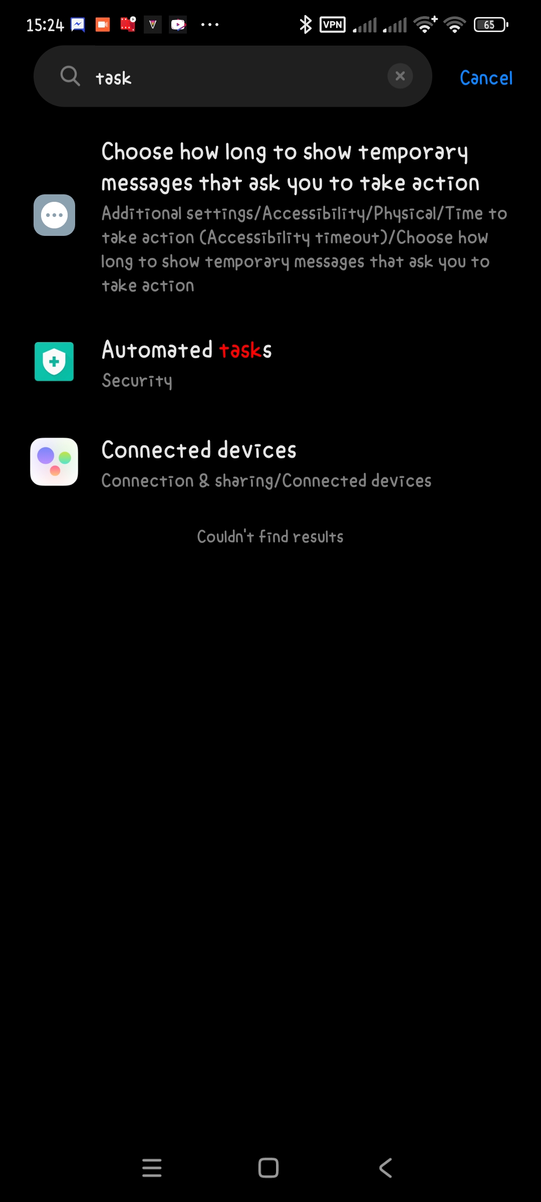

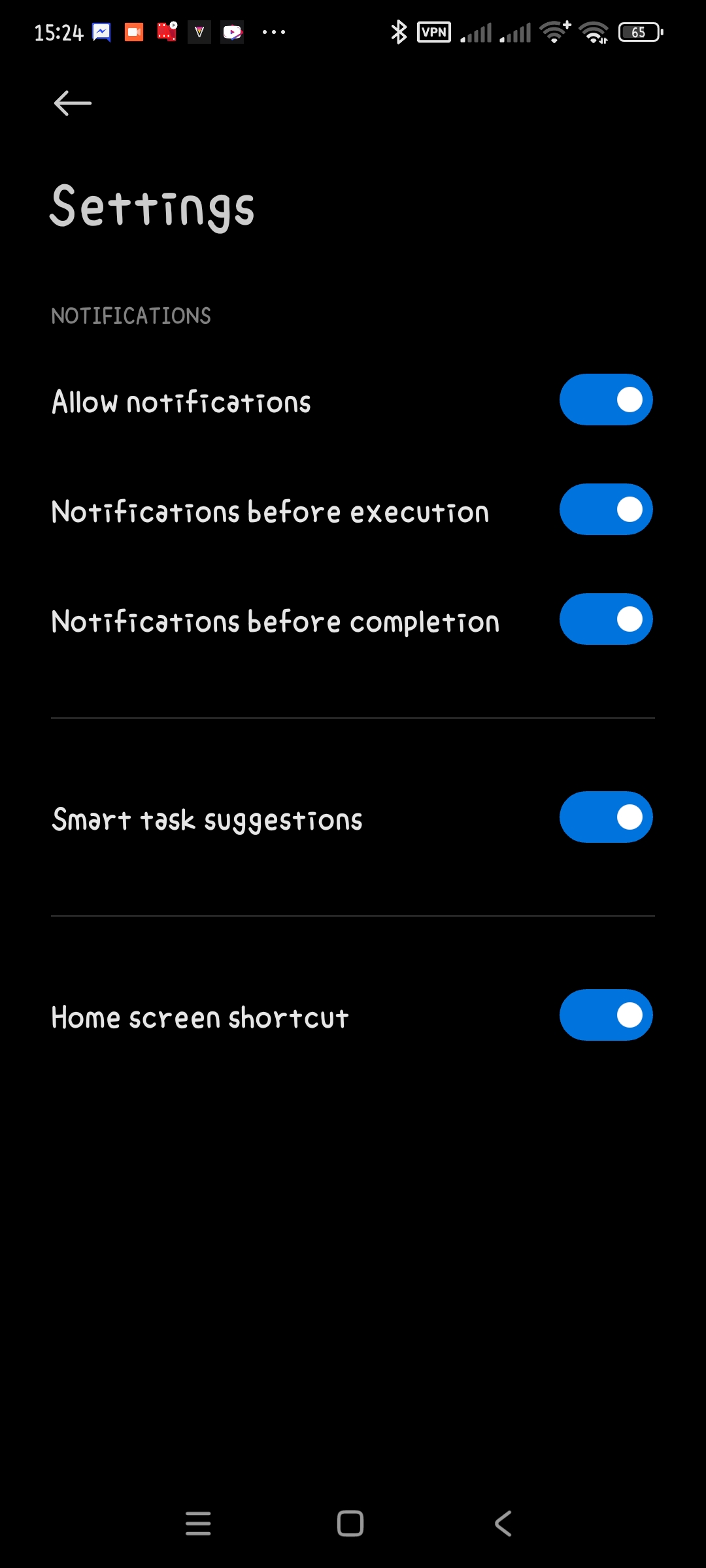

so sorry, I couldn't find the conditional triggers funcation any more.
It's gone.

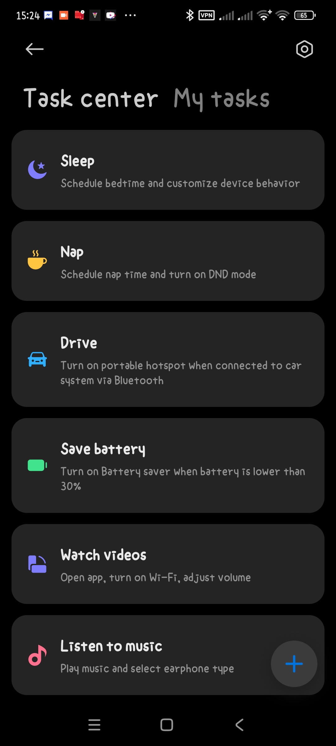

Do you mean this (img1)? Search settings for 'tasks' to find it (img2). You can add a home screen shortcut from the cog/settings icon in top right (img3)

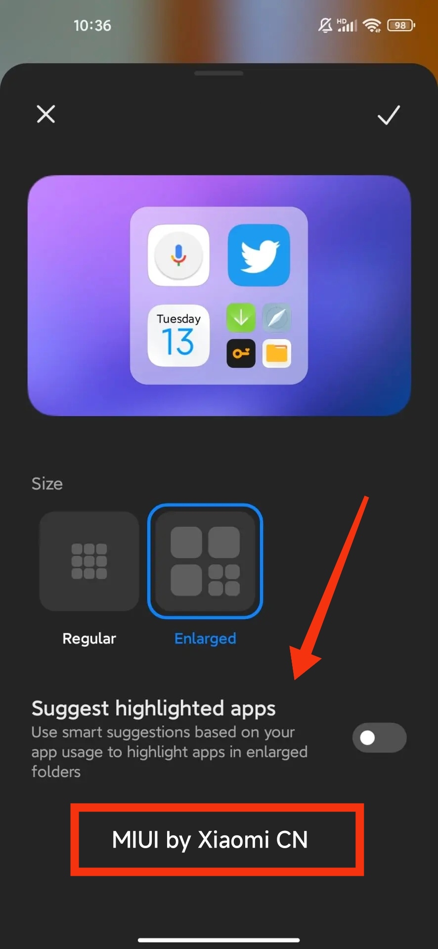

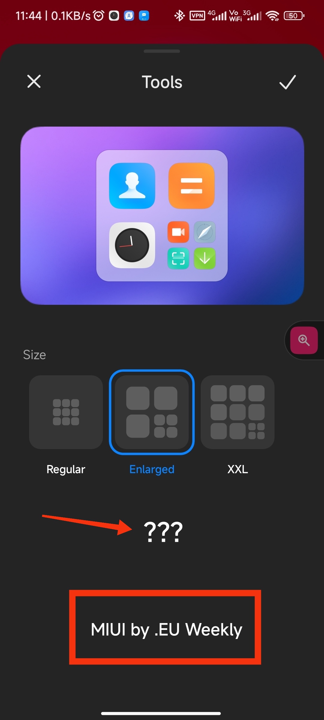

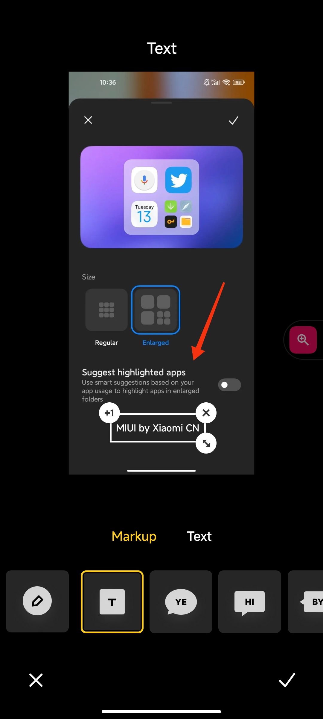

Thanks for your confirmation feedback.
Your UI lacks the "Suggest highlighted apps" feature like mine. (annex)
In the MIUI 14 (CN) it's possible to enable it.

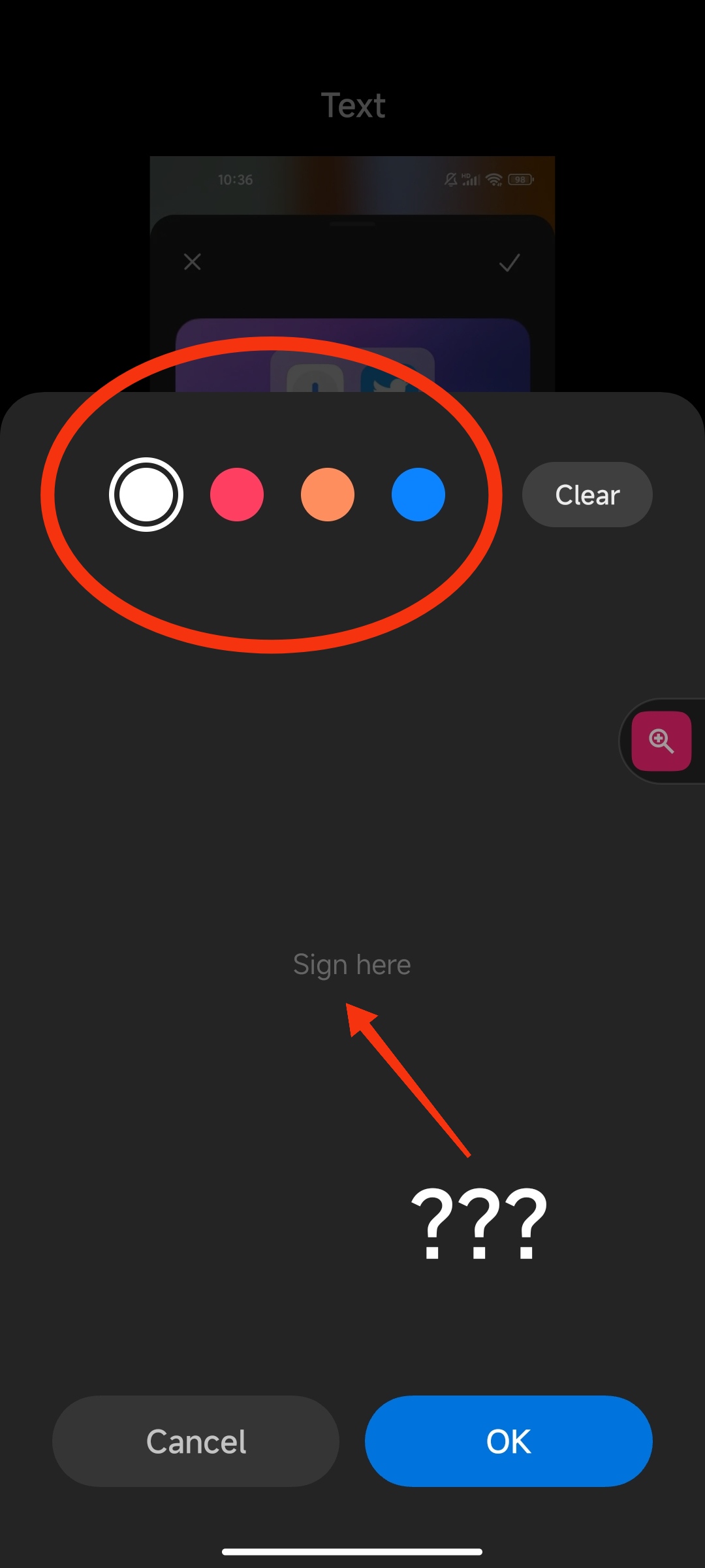

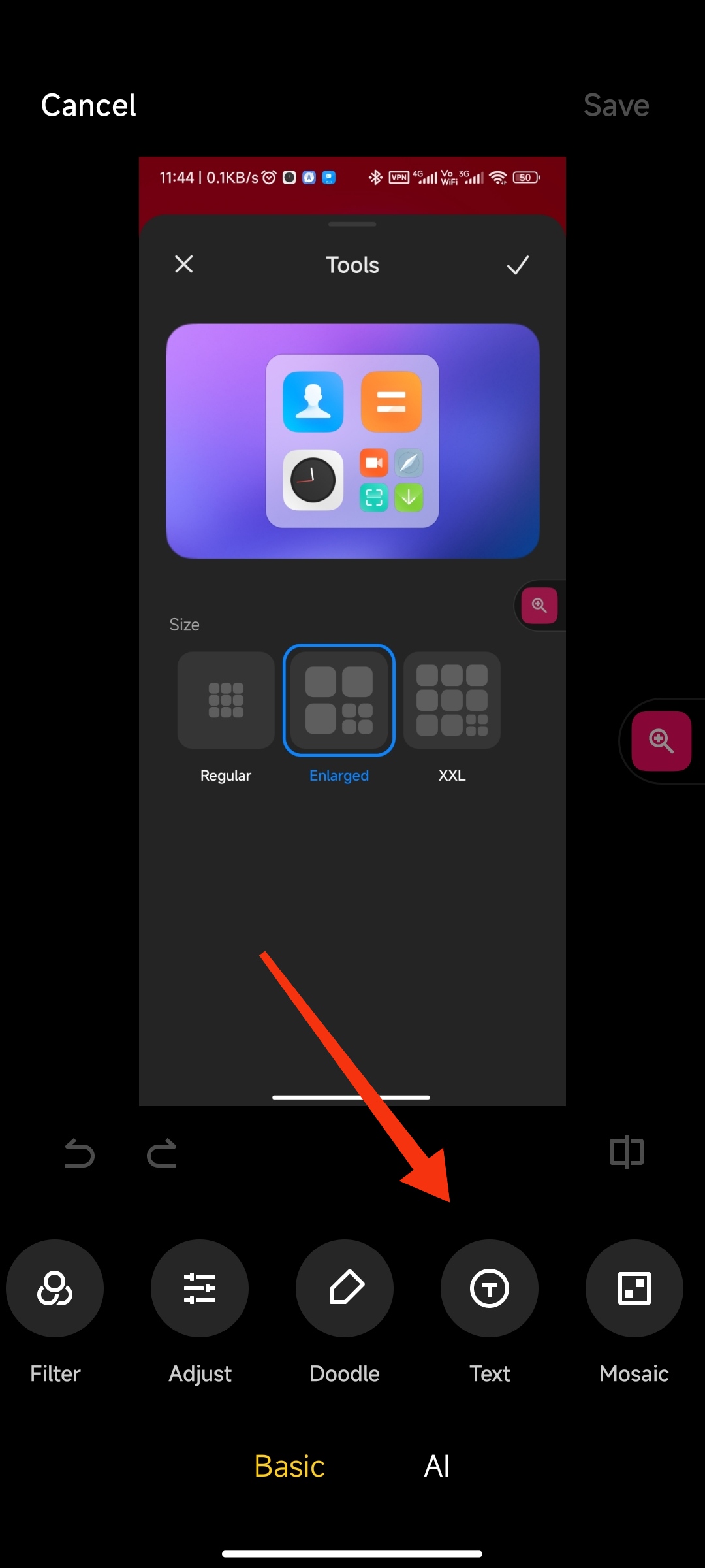

Issue/Bug Report on Poco F3:
In the new Gallery app the option to change text colour when editing doesn't work anymore. (annex)
Please check.

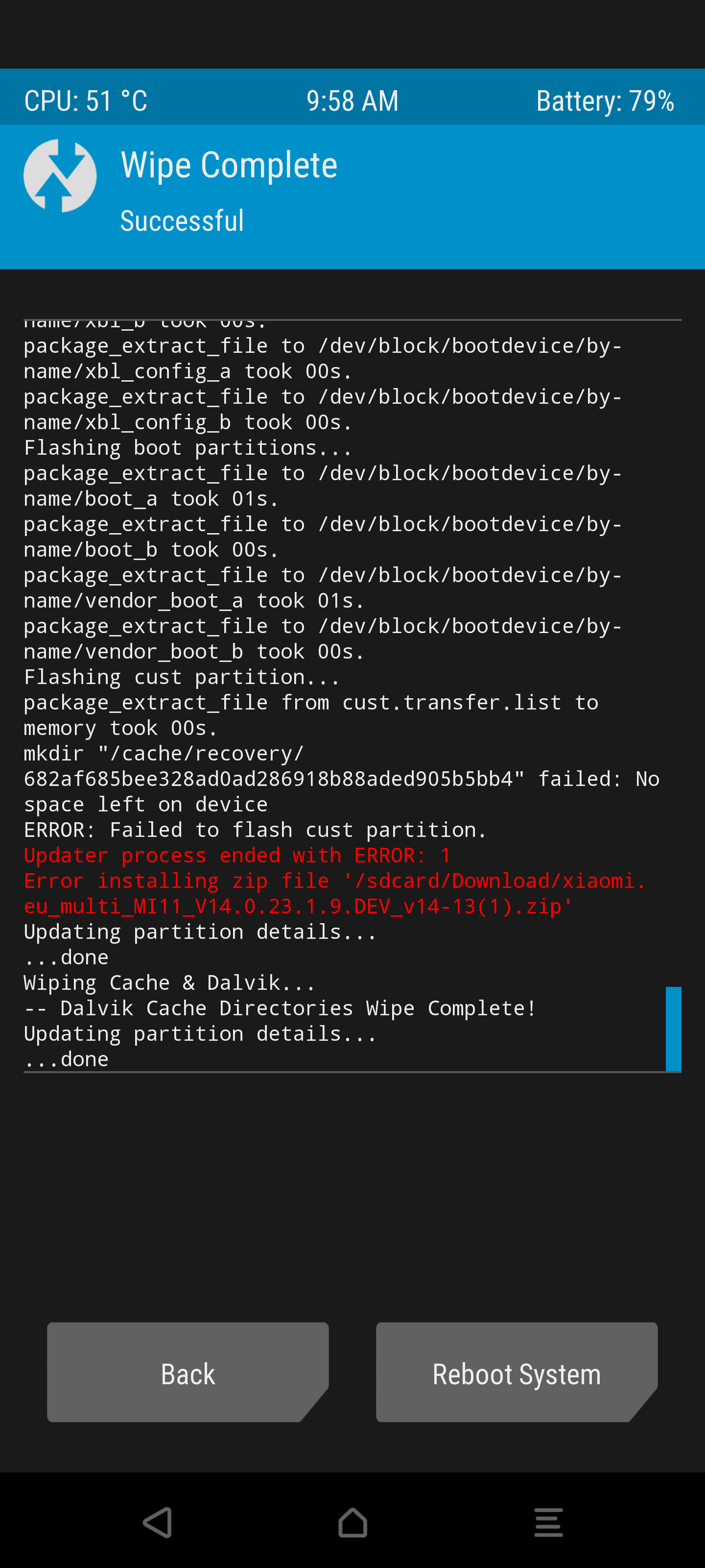

Good afternoon, does anyone know why I get the "cust" error?
wipe cache partition..
It remains the same, the first time I installed it, although the error came out, I am updated with this latest version
