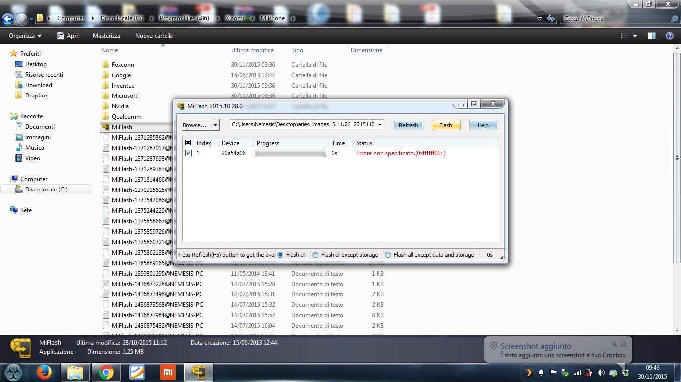

Thanks a lot for your guide, But I have a problem.
My Mi2s is without merged data, but the system si merged. At the moment the phone works fine except for my internal storage that is completly missing.
I followed your well done guide, but I have the following error in MiFlash "non specified error (0xffffff01: )", see the attached immage.
Could be because MiFlash does not see an internal storage where to copy the files?
Do I have to change something in advance settings?
Please help!!!!!!

First try to Wipe SD and Wipe All Data via MiRecovery and then MiFlash...

Done, but same problem, always error as before.
any other idea?
Strange...MiFlash method should work in any situation (it worked for all other users to fix lost internal storage). Try another USB cable or try to enable USB debugging too in developer options
Debugging is active,
changed 2 cables
same result!!
HHEELLPP!!!

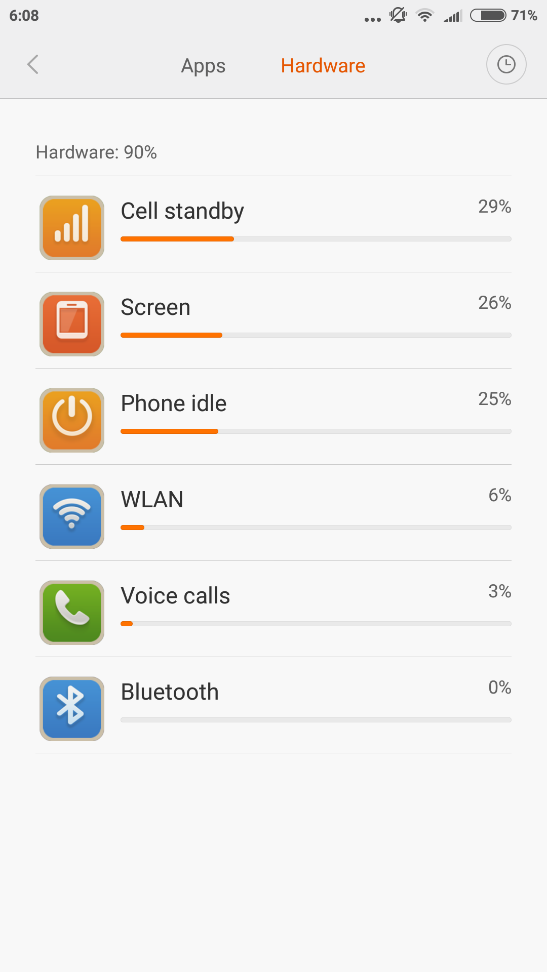

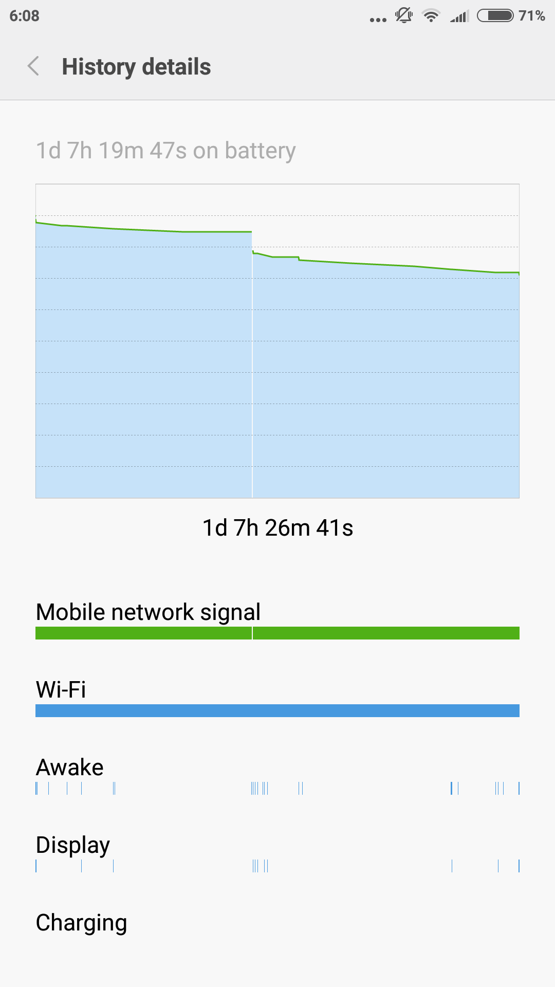

Screenshot_2015-11-30-06-08-03_com.miui.securitycenter.png Screenshot_2015-11-30-06-08-31_com.miui.securitycenter.png Hi, On my RN2 have noticed that when I switch off my phone overnight, the battery shows WiFi and mobile signal remain on, is this a problem or a false reading? See attached.
I had the same problem, it's not miui related: go to settings-wlan-advanced setting and turn OFF "scanning always available"
