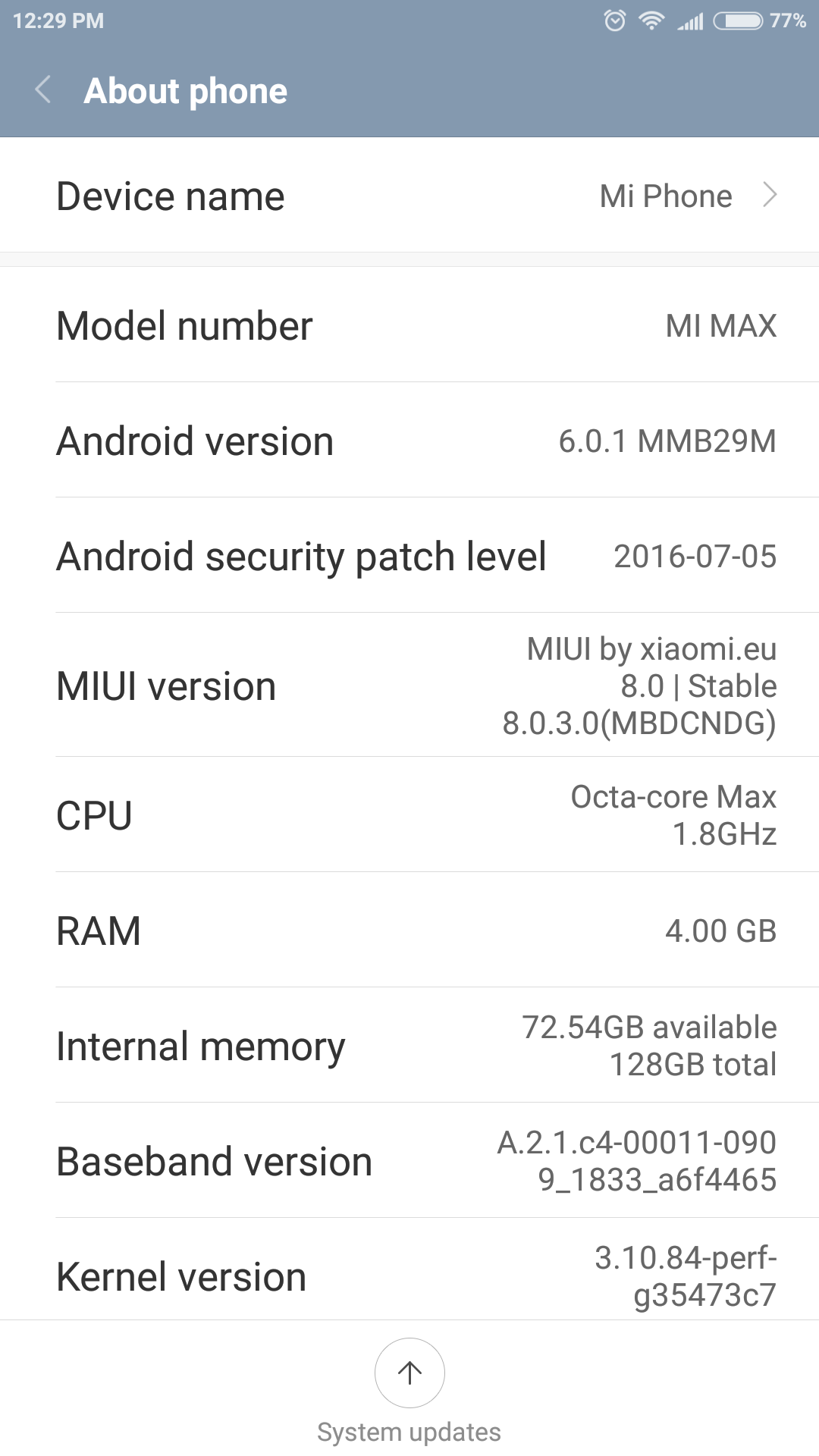

Just installed the new rom through TWRP. How to know whether the Rom installed or not? Refer attachment.
