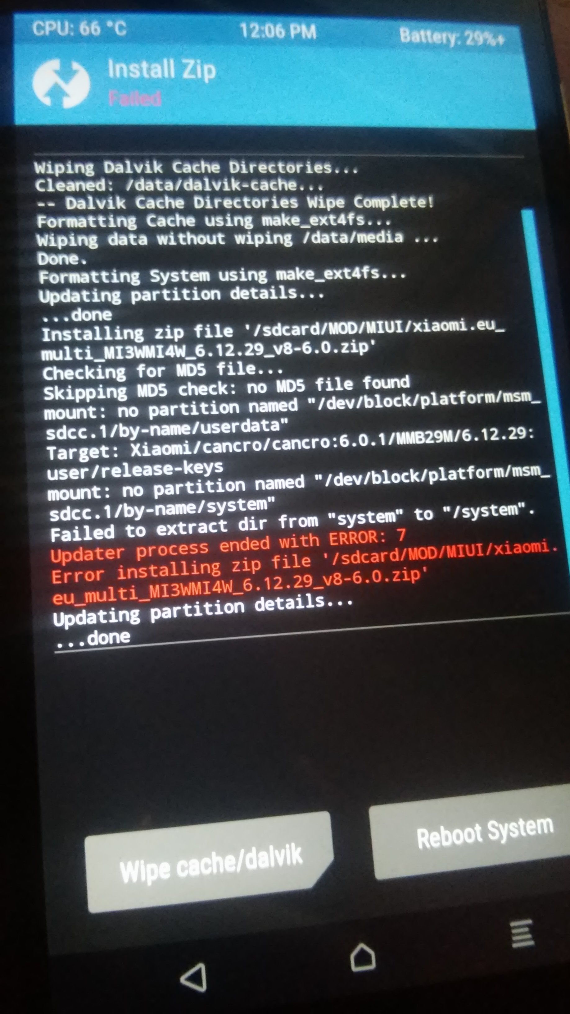

Hello, what's going on with this roms? I can't clean install this roms. It always shows me an error. I've tried muultiple versions.
When I install it us update it tooks 30-40mins every week to install rom and another 30 mins to boot up. When I try to upgrade or clean install it shows me errors like posted image
(errors with upgrade and plus error 7 on clean install)...
I just made wipe /data, /cache, /dalvik, /system.
After that I have to restore my twrp backup.... ouhhh yeaaaaaaaaaaaaaa

you have to merge your system partition by fastboot install of china/global ROM via flash_all first..
as you are on still on 4.4 and wants to move to 6.0...

After you get that error 7 message (due to wiped system) then just reboot to recovery and install ROM again without wipe the system and it will be fine...
Edited:
If you still don't have merged system partition, then follow Ingbrzy instruction above ofc...mine is just general solution against that issue...

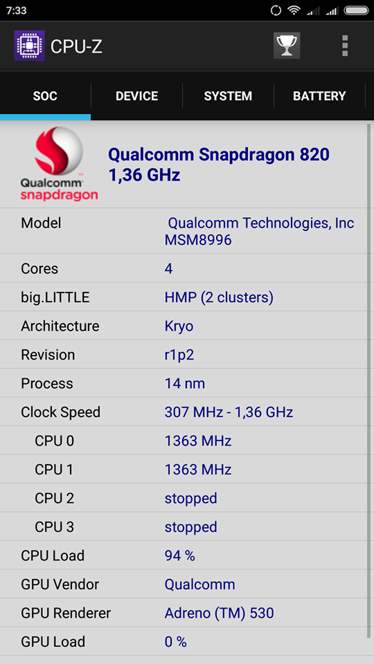

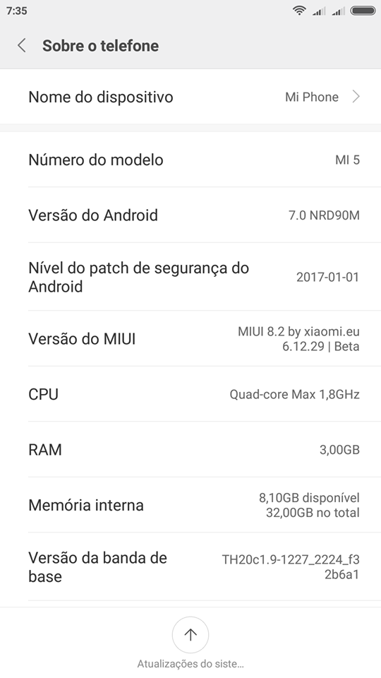

Hi! I am using MI5 32gb with xioami.eu 6.12.29 nugat and agter~10-12 minutes phone put 2 cores to sleep and only 2 lower cores are running. I restart my phone and the issue continues. I runned games and videos to try to see if the cores come back to work but not worked. See the pics. So I came back to xiaomi.eu_multi_MI5_6.11.10_v8-6.0 and cores are working correctly.
