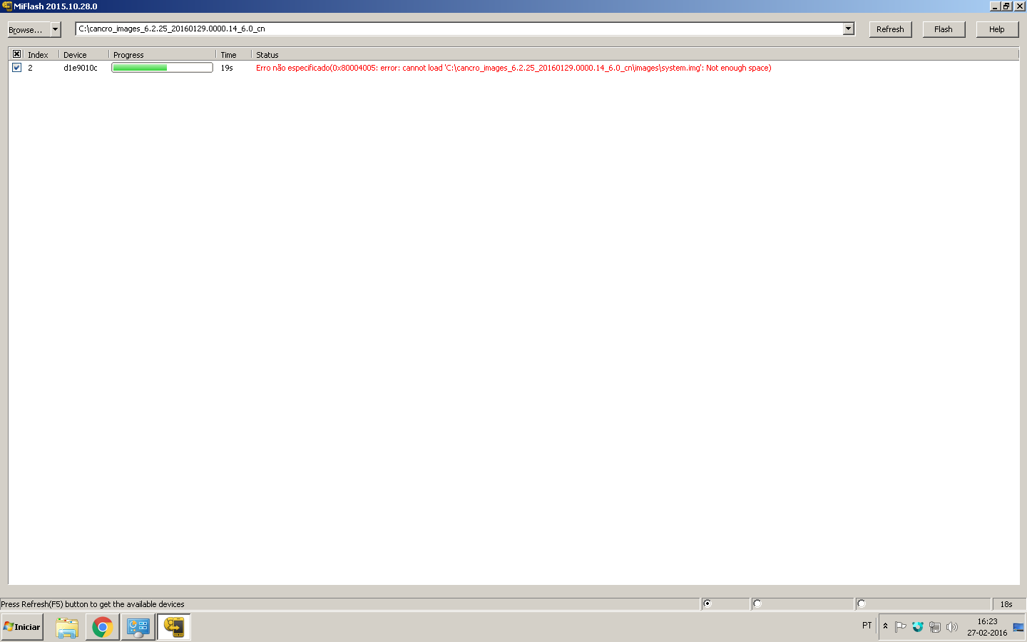

I tried doing it like you said but this happened:
I went to my phone, got into the TWRP and in the partitions it sais that the system has a 0 MB size. Should I resize it ? If so to what value?
