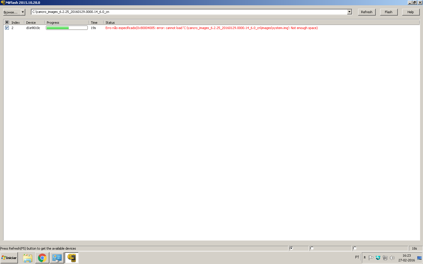

Yes as you mentioned your system is out of date better is to start with a mi flash of the China development then you can update safely.
Just update twice 5.12.17 as you would do as before it will do the right partitioning.
Then update with 6.2.25 it will install twrp automatically.
I tried doing it like you said but this happened:
Thank you so much for your help. I finally solved the problem by installing the 5.12.17 update to TWRP and then installing the new one !
