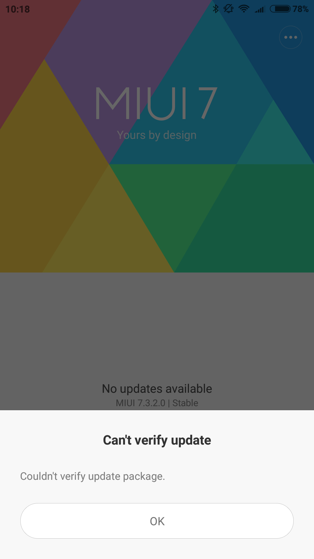

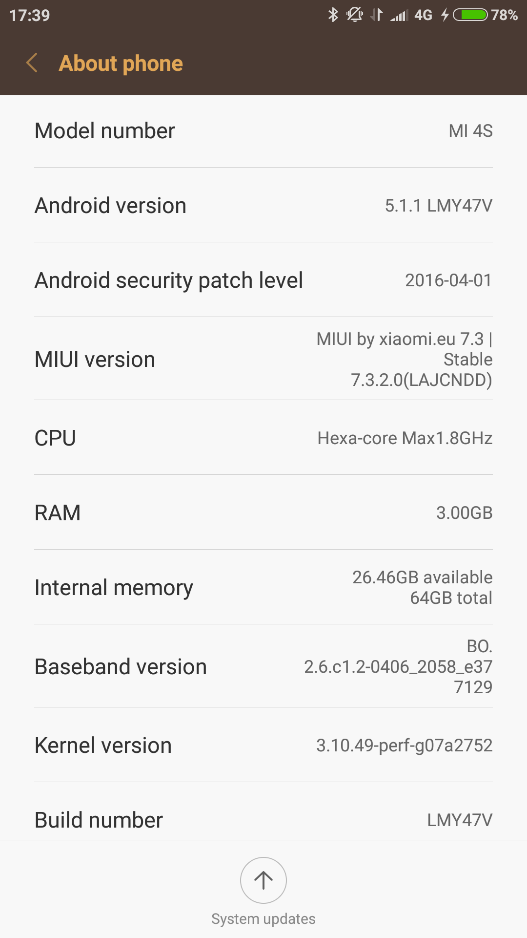

Hi
Sorry if it's already been asked.
I have Mi 4S, bootloader unlocked, TWRP 3.0.2-0 installed.
I have Xiaomi.eu 7.3.2.0 stable that I flashed via TWRP.
Now, when I'm trying to update to 7.5.2.0 via updater (downloaded xiaomi.eu_multi_MI4s_V7.5.2.0.LAJCNDE_v7-5.1), I'm getting: Couldn't verify update package.
Screenshot_2016-06-26-17-39-43_com.android.settings.png Screenshot_2016-06-30-10-18-04_com.android.updater.png
How can I update to 7.5.2.0 without losing any data?
Thanks.

Have you downloaded the ROM?
Click on the three dots in the upper right and select the download you did
reboot to recovery, Install - select zip - reboot
It will keep my data, apps, etc?
This is exactly what I'm doing.
I've downloaded a file named xiaomi.eu_multi_MI4s_V7.5.2.0.LAJCNDE_v7-5.1.zip, copied into a folder in the storage, and I'm selecting it. Getting: Couldn't verify update package.
Reactions: Stefano131270
Have you tried flashing it with TWRP instead of the updater app! If not then do try! And also you might have to completely wipe data, cache, dalvik and system before installing!
DO TAKE A BACKUP BEFORE DOING ANYTHING!
