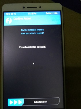

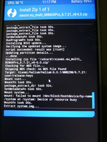

I want to try it on Mi Max Pro (Helium) but after unlocking bootloader and flashing TWRP using fastboot via ADB, when I flashed your rom 6.7.21, by advance wipe in TWRP I selected Dalvik / ART Cache, system, data, and cache, The I flashed the ROM see attached picture, when it finished
Flashing.jpg Reboot.jpg flashing, I want reboot system I get a message “No OS Installed! Are you sure you wish to reboot” I tried on ROM 6.7.14 I got the same message. Any idea what I did wrong?

I want to try it on Mi Max Pro (Helium) but after unlocking bootloader and flashing TWRP using fastboot via ADB, when I flashed your rom 6.7.21, by advance wipe in TWRP I selected Dalvik / ART Cache, system, data, and cache, The I flashed the ROM see attached picture, when it finishedView attachment 13152 View attachment 13152 View attachment 13154 flashing, I want reboot system I get a message “No OS Installed! Are you sure you wish to reboot” I tried on ROM 6.7.14 I got the same message. Any idea what I did wrong?
You didnt do anything wrong, just reboot, the OS will be there
( at least i on mine, i have MI 5 , same message, does boot )
