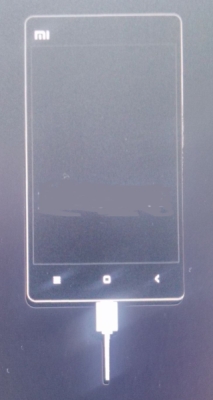

yesterday I got my new Mi4s, it came with 7.2.5.0 (LAJCNDA) xiaomi.eu stable. In order to install this new devrom I tried to reach recovery - but no success, the phone gave me a strange black screen with a smartphone and cable (see image)
view
View attachment 13357 for a minute and then started normally. No way to get into recovery (power + volume didn't function either).
What's the fault - is it possible that the bootloader is locked ? Don't know how to go on, would be pleased if someone can help.

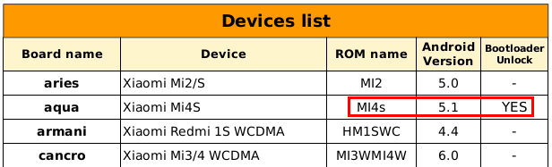

Your phone doesn't come with any EU ROM; I supose that's chinese stable version. You need to unlock the bootloader first in order to be able to install TWRP and the ROM from here. Read the first post!

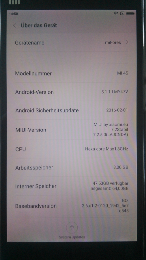

Hi piratzi,
thanks for your reply, this is what I found about the phone....
It came from honorbuy eu-shop.

As I said, your phone came with China Stable version. You need to apply to unlock the bootloader: http://en.miui.com/unlock/
Once you have it unlocked, you'll be able to install any other dev ROM.
