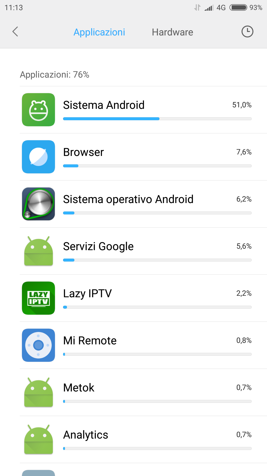

Is it normal this android system drain? Also noticed that the phone often overheating
Mi4c

No it's not. Turned it on 6 hr ago and it is already at 50%, doing litteraly nothing
GoT 2 Things:
Once i got a misconfigured WiFi Hotspot. MI3 got warm.
Second, i turned of location from google.
Maybe check Wakelock Detector to get your drain.

See my previous post. Flash the modem from previous 6.8.11 or stable to get the battery life back. It is a bug in chinese 6.8.18 modem
