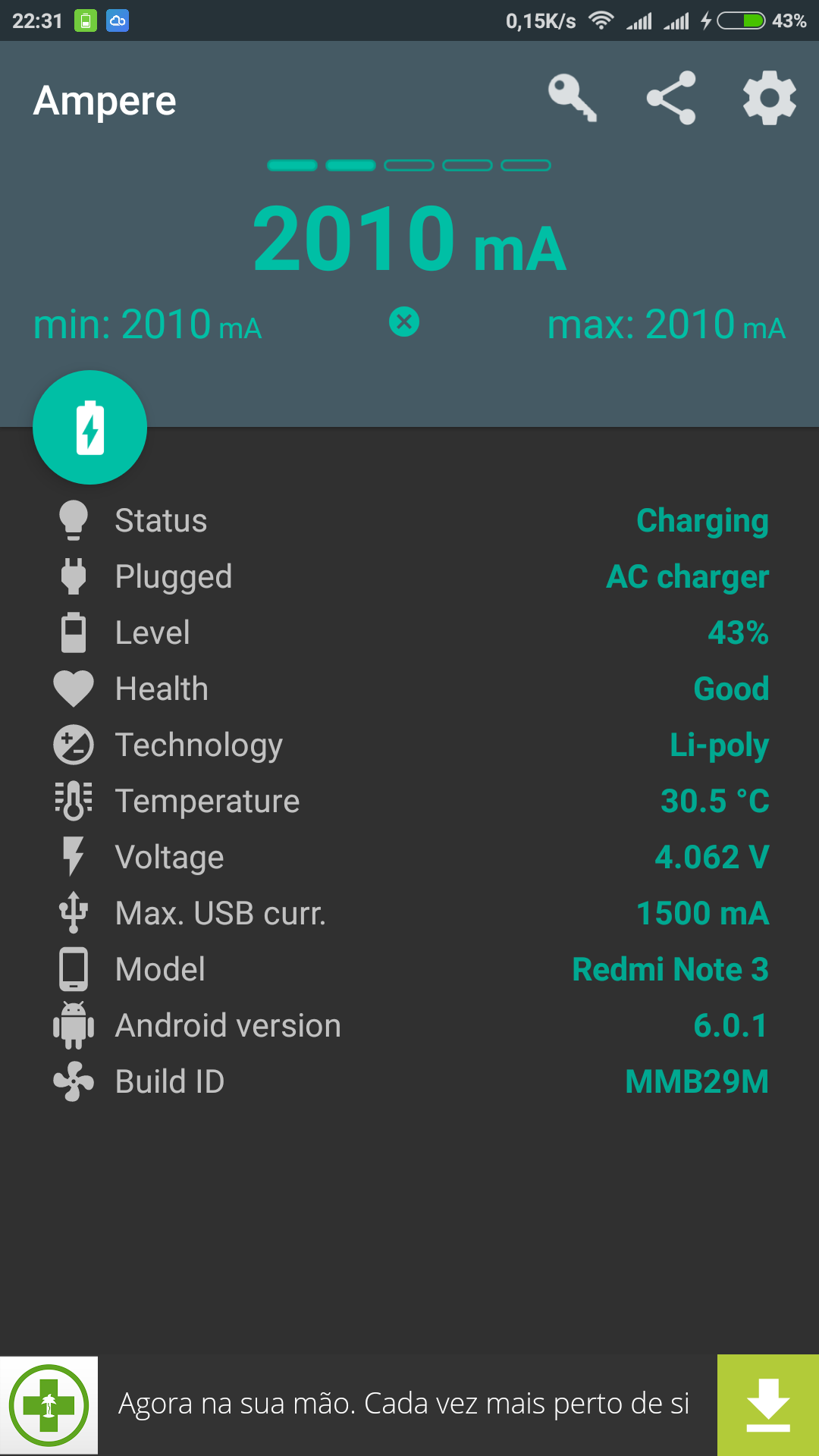

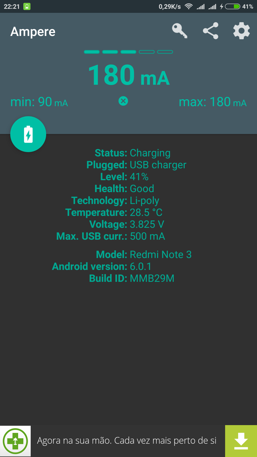

How is the charging speed, can u pls tell Ampere value..
Please take a look at the attached two screenshots.
Hope they're useful.
Regards and thank you.
-aurocha
