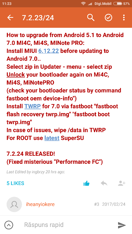

I unlocked my MI4c's bootloader on the 5.1 version via 'fastboot oem unlock' a year ago. Upgrading to newer ROMS never changed the status of the bootloader - it remained unlocked. But after upgrading to the new Android 7.0 ROMs, my bootloader is suddenly locked again, so I can't do incremental upgrades again (from 7.2.16/17 to 7.2.23/24, for instance). Can't get into recovery mode/TWRP, as usual. Only fastboot access is available, but the bootloader is not responding to a simple 'fastboot oem unlock' this time around.
Why does the bootloader get locked, when I'm purely flashing Xiaomi EU ROMS? It happened when upgrading from 5.1 to 7.0 ROMs.
When you upgrade from 5.1 to 7 it will relock the bootloader. If you proceed the unlock "officially way" it remains unlocked every time you do the upgrade with xiaomi.eu roms.

READ 1st post in every new ROM thread.... explained 1000x so far.
Thanks for the quick reply and explanation, mate.

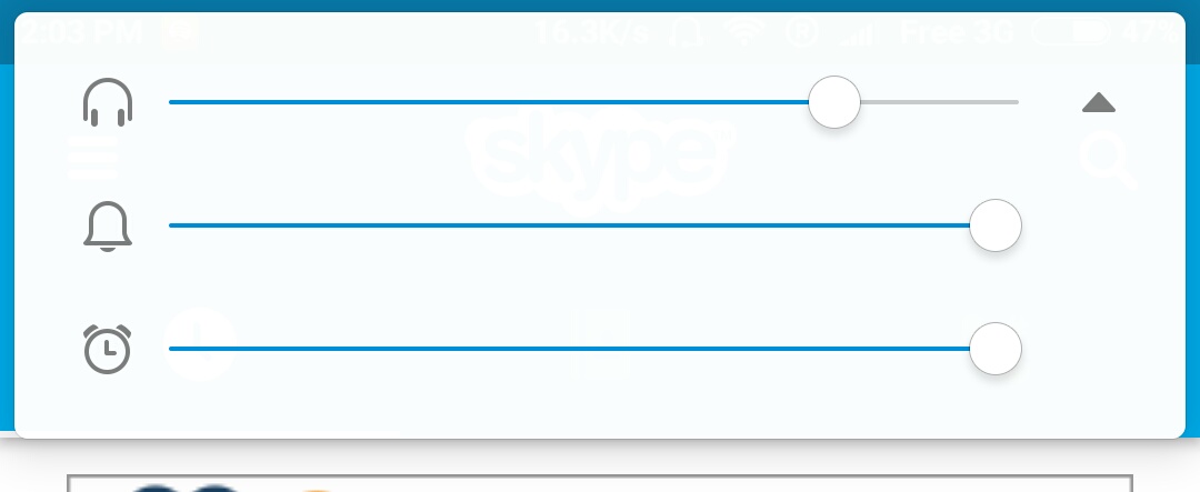

Does anybody has maybe a solution for that seperate volume sliders issue during a call (controlling media and call seperately)? Is it perhaps something that can be added to the .EU version? Thanks.
