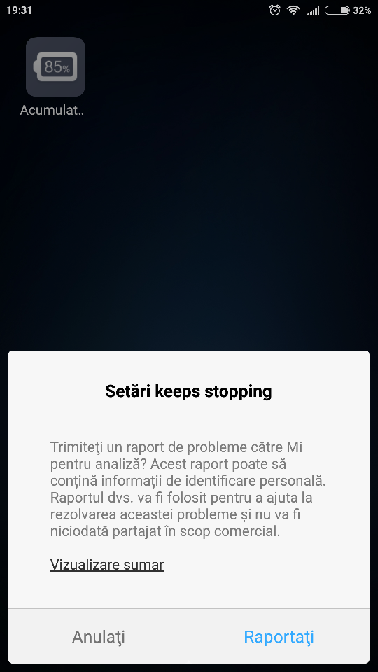

Mi4c battery widget error

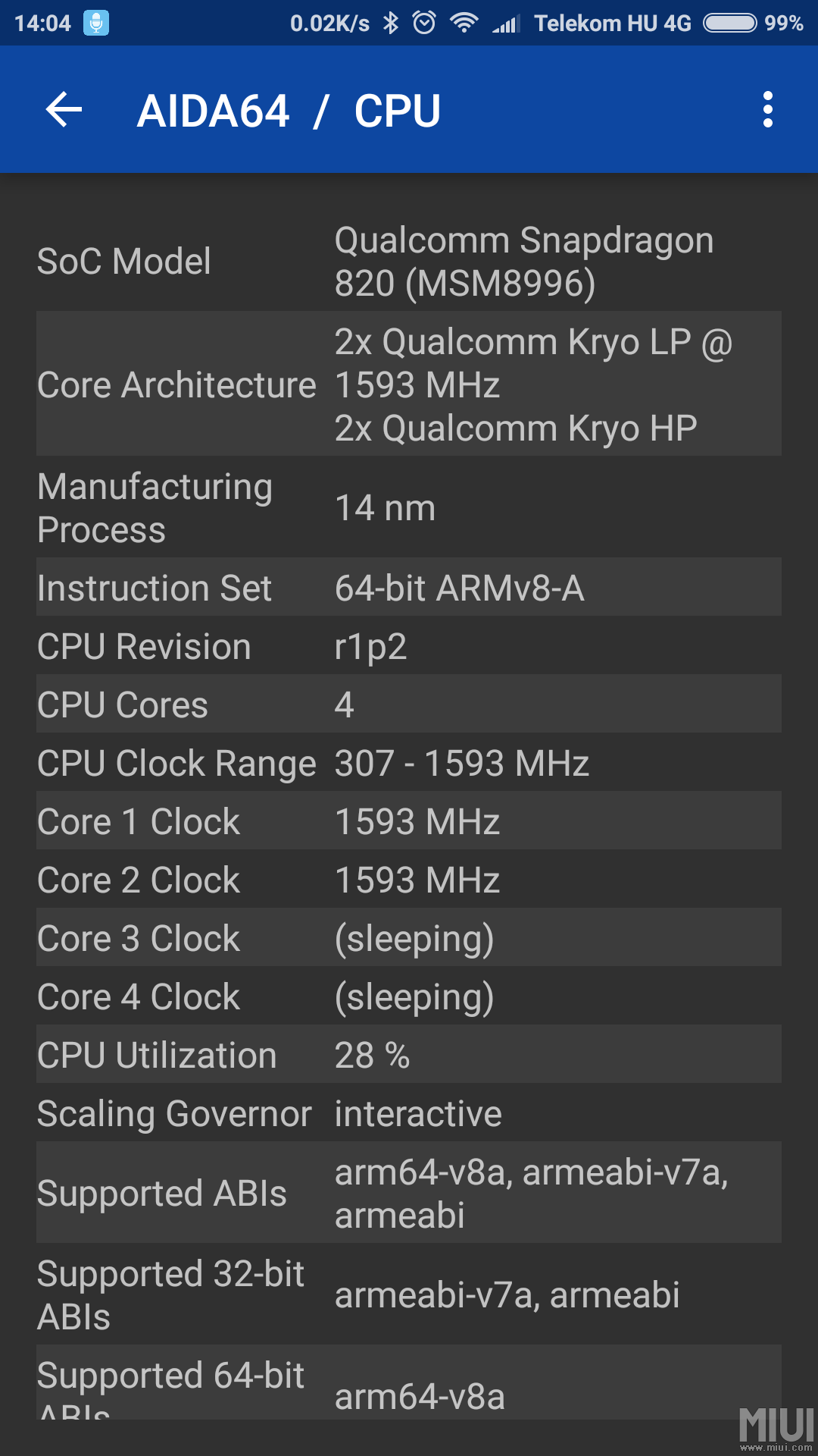

Anybody knows why only 4 A-53 Cores are working on Mi4S?
The 2 ARM Cortex A-57 are stopped under Nougat.
Any solution for this?
Ask xiaomi.eu team about it.. They don't want to fix it.

Check with Kernel aditorium app it reads cores correctly (you need root).
Or just test it with Antutu benchmark - if the score is good, than all cores are firing....
I've checked with AnTuTu, cores doesn't work, result is 47k. But on official roms and roms by Multirom all cores works.

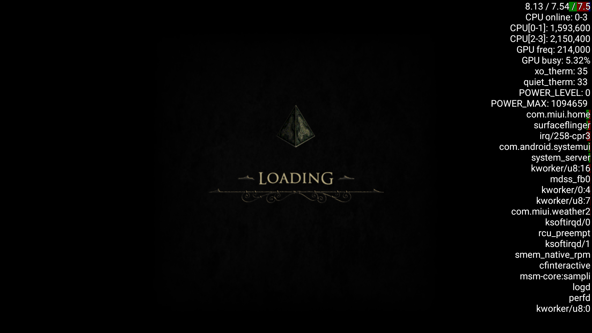

Regarding cores behaviour issue after upgrade to Android 7 based MIUI:
In case of Mi5 we have had the same issue that 2 cores are always inactive according to CPU-Z, AIDA64...etc 3rd party apps. But this is false result for sure because these apps just read the CPU state incorrectly. If you have doubt just enable "Show CPU usage" in "Developer options" and check the on-screen display result. It will display the correct CPU state as all 4 cores are actively running just divided to 2 clusters (0-1 and 2-3). Please check my screenshots below:
CPU state according to AIDA64 during heavy load (2 cores are sleeping and downclocked) :
CPU state according to built-in CPU information during heavy load (all 4 cores are active, divided to 2 clusters and running on maximum frequencies) :
So, nothing to worry about...
I know that and that cores are working, but utilities like aida64 works properly on builds by other teams, they shows all 6 cores in work on Mi4s. And only on xiaomi.eu builds there is a problem. And we still hear sounds in silent mode. Only on xiaomi.eu.
