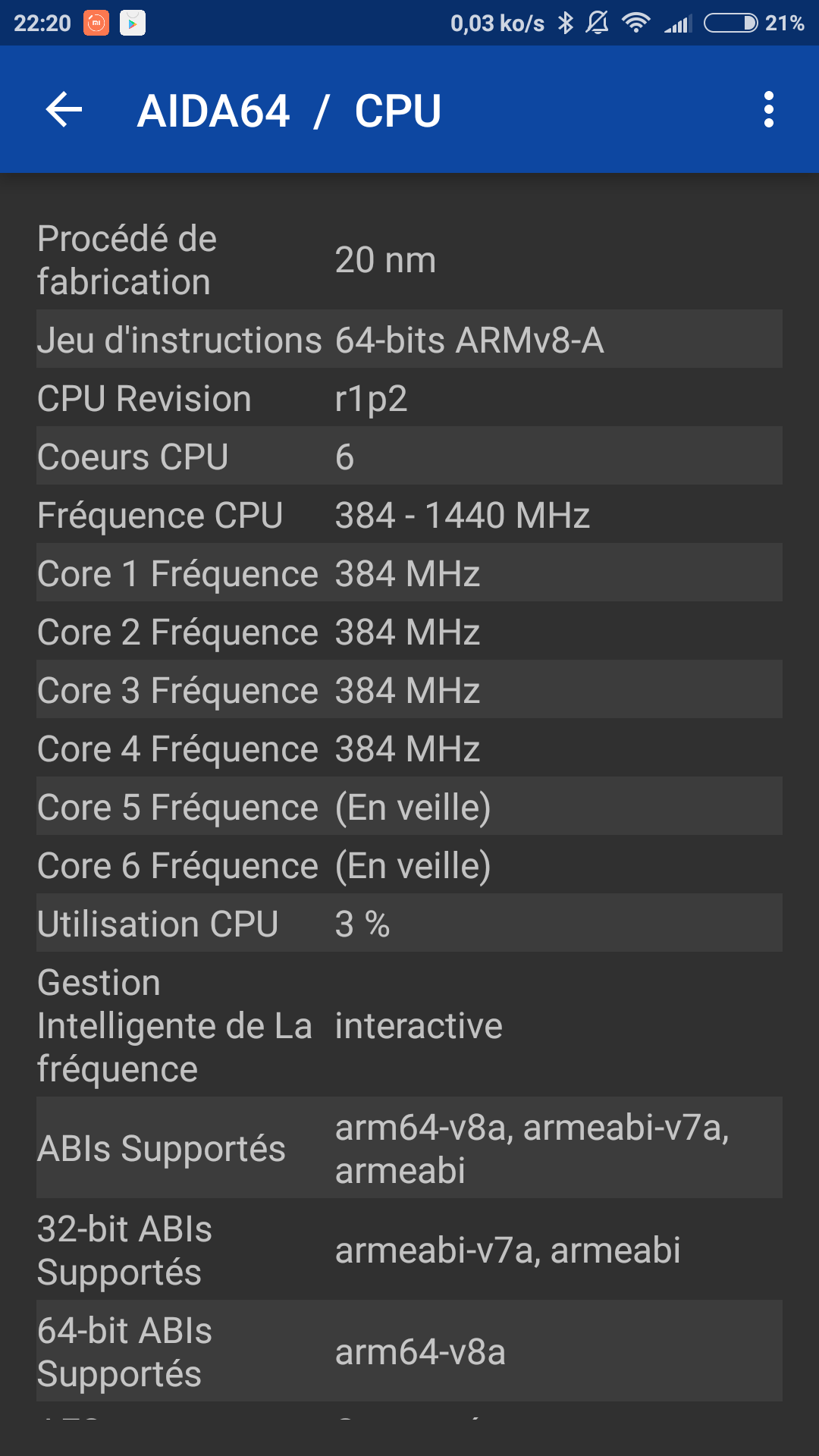

Sadly downgrade for me...
Installation on Mi 4c => OK.
Unlock => OK.
=> without waiting using MiFlashUnlock (unlock already done in March 2016 - after waiting Xiaomi validation).
Installation of TWRP 3.0.3.0 => OK.
Test of all applications installed => OK.
To do :
Monitor battery consumption and cores utilization.
Thank you again for your ROM's. The best to put my phone in French.
I tried official rom from XIAOMI ROM and custom rom from MIUI-FRANCE.ORG and you's is clearly the best (less space, less memory and less battery consumption).
