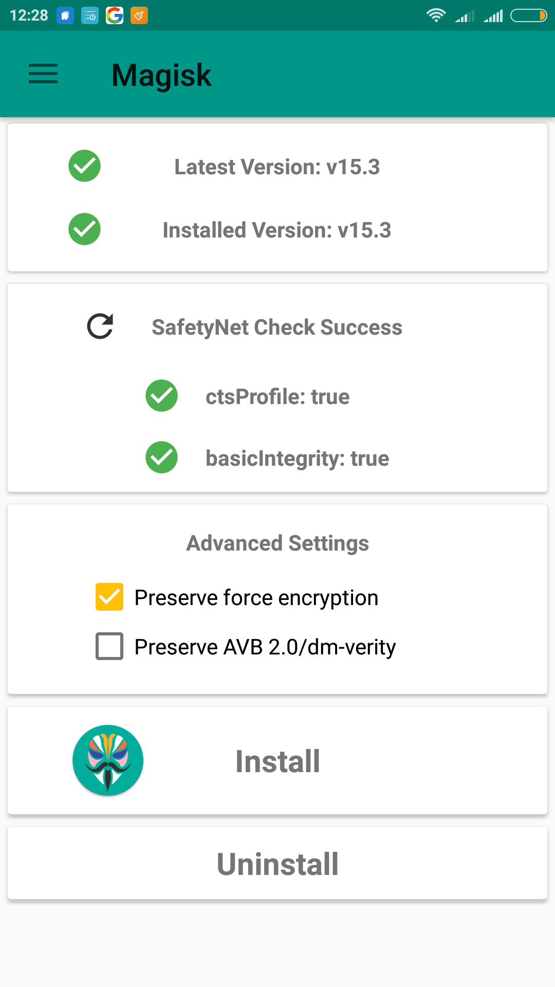

Do you use SuperSU? If so, flash stock the boot.img via fastboot, then install the Magisk and test it in the safetynet test.

If you do flash from rom 7.12.7, the original boot.img will be restored and you can install Magisk and you will have no problem with the safetynet test....
I'm using 7.12.7 on my Mi6 and replace SuperSU with Magisk and everything OK with banking apps.

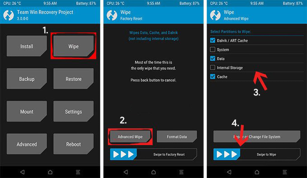

You're going to install 7.12.7 the way I did before. But need to perform a wipe data + cache. (Backup your data before)
