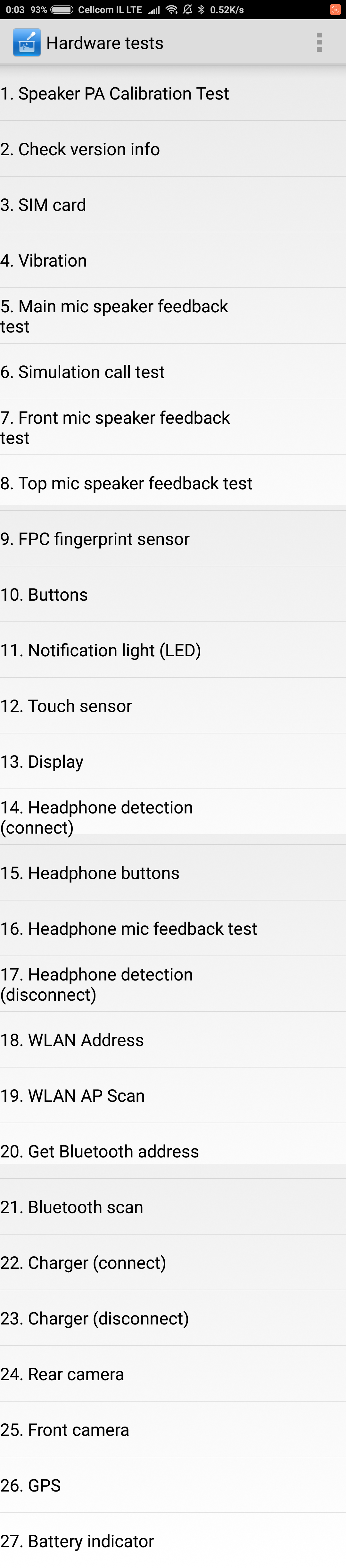

Thanks but..I already said.. that option is missing since I updated to Oreo...

I confirm this bug for MI5. I will tell you more: this bug varies between phones. I have a white one, manufactured 10.2016, and my sister has the gold one. The thing is, I have no problems at all, but she indeed has lost all sensors after update to oreo. And I have that calibration on test 9, she don't. She also does not have tests for accelerometer, pressure, gyroscope or light sensors. please help.

I really have no idea what is wrong as I read the comments and people say to get to CIT and recalibrate proximity sensor in order to fix it (MI5 Oreo version)
Well since I moved to 8.3.1 (Wiped data and cache..) and also in 8.3.8..There is no proximity sensor option on CIT!
So no way to calibrate anything..
Sensors still not working..Really have no idea what is wrong ;(
Do you use magisk?
Thats make proximity sensor not working. I found a bug from magisk 16.00 make proximity crash.
Uninstall magisk 16 from magisk manager, reboot your phone. If you want to root, use magisk 15.4, this release work with mi5 oreo. Your proximity work too. But becarefull with any magisk module, because some of module will crash with proximity sensor too. Don't use dolby atmos module for oreo, this module is crash too. Use viper for audio module, work perfectly.

Proximity sensor calibration option should have in CIT, see below (Mi5 Oreo 8.3.8):

I am use Magisk 16, before update and got problem with proximity. But ease to calibrate once, than reinstall Magisk.
