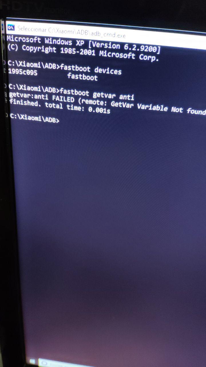

hello Thank you for your work, I've always been a fan of your roms. Currently I acquired a Xiaomi Mi Mix 2s, with miui10 global developer 8.7.5. How can I know if I have anti rollback?

You don't, read on the subject.
I've read about it and I see that if I have it, I'm screwed. I have seen a command for redminote 5 that tells you if you have it or not. but in the mix 2s it does not work ...
Attached photo of what I get
