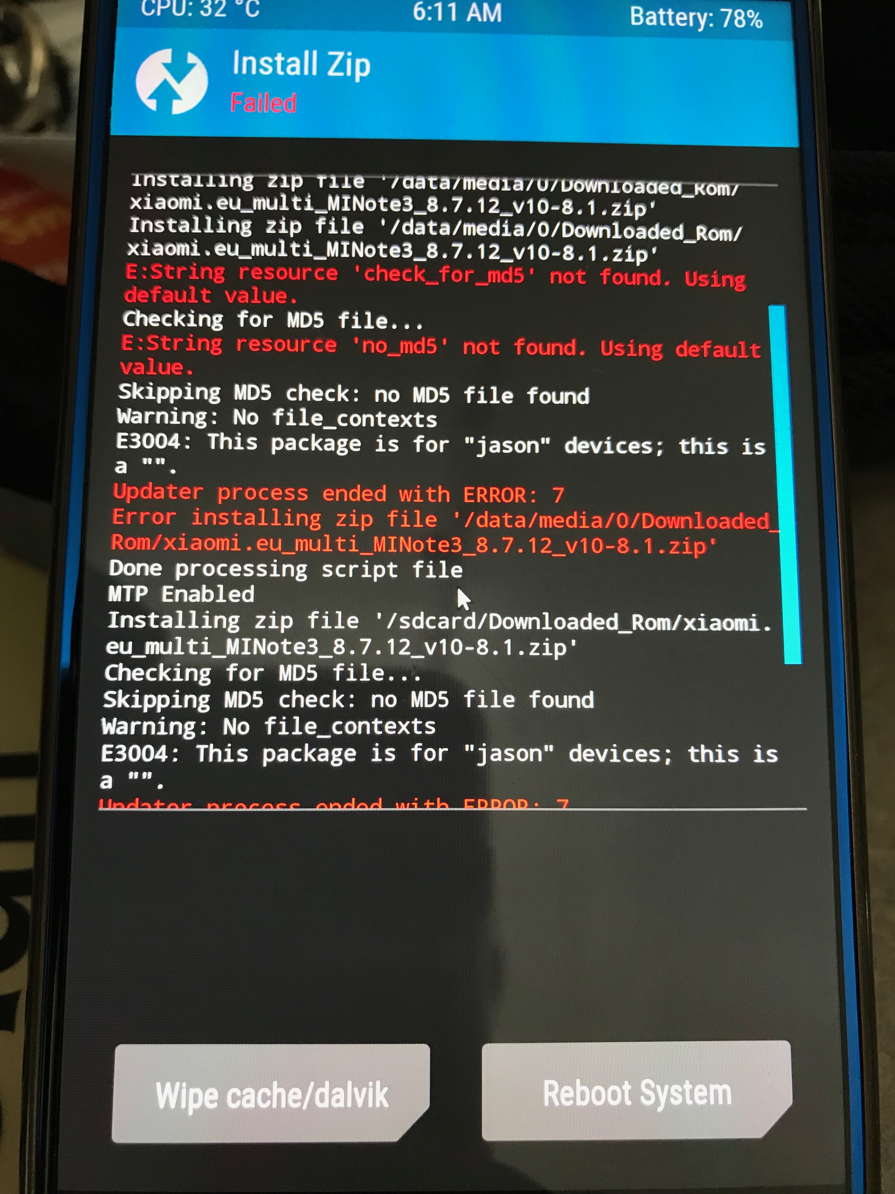

just downloaded the version for the Mi Note 3 but it does not work. The installation stops with Error 7
any clue whats wrong ?
I downloaded the file twice from different sources, same result
Tks
Henning
PS : an upgrade of TWRP to version 3.2.1-1 solved the problem
Tks
Henning
Some device or maybe twrp itself has this issue if you format system. cannot read device name. Try this workaround:
First make sure you download the right zip for you phone and the md5 is matching with the one on the host
1. Boot to twrp - do wipe - reboot recovery - go straight install zip(don't wipe data etc.). Or
2. Open zip from PC - edit the updater-script delete the assert getprop line.
