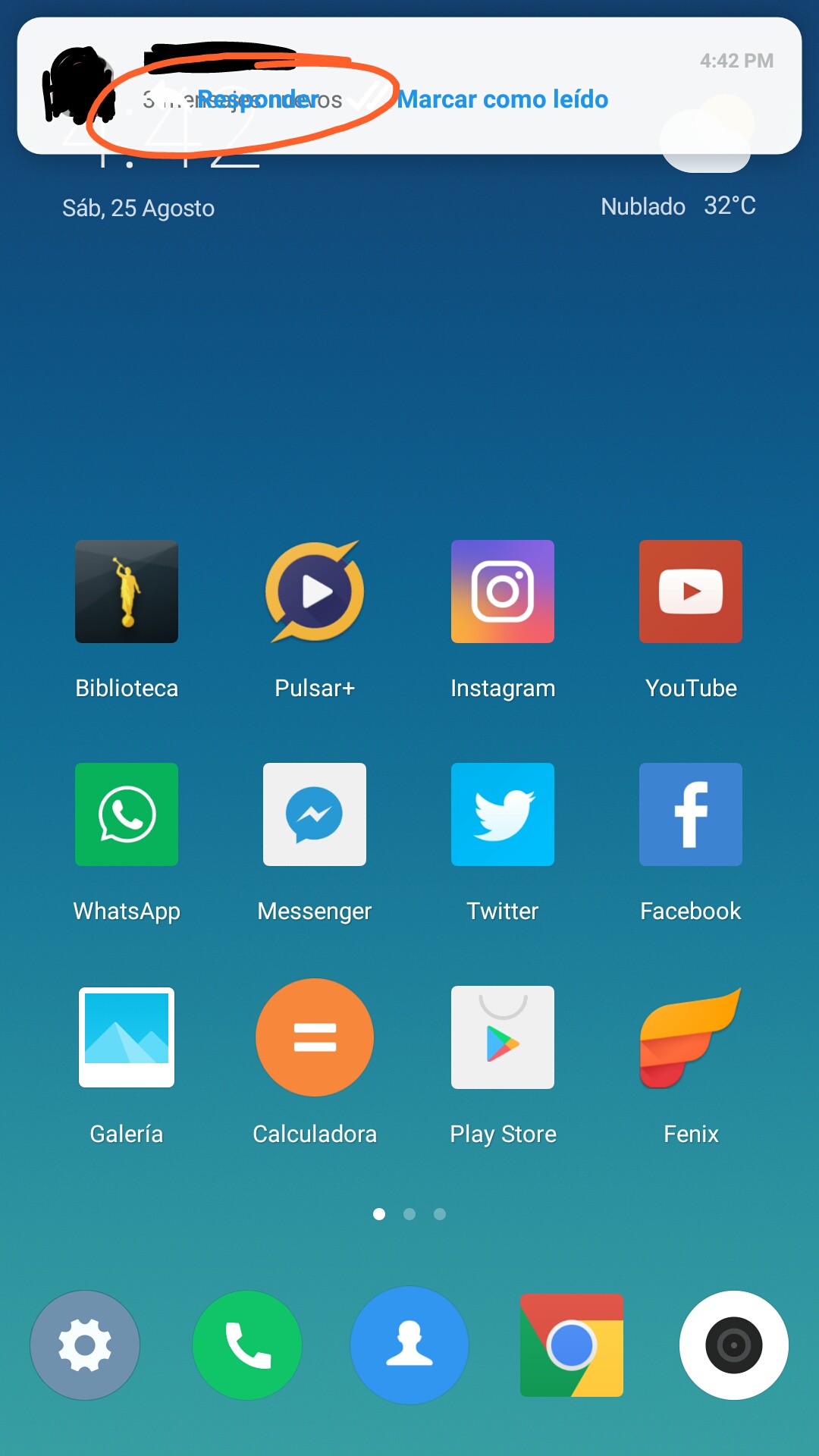

upon receiving 3 messages from any application, the letters are overwritten. when receiving two does not happen that. and there is an error. the sim card is not activated, redmi 4 prime

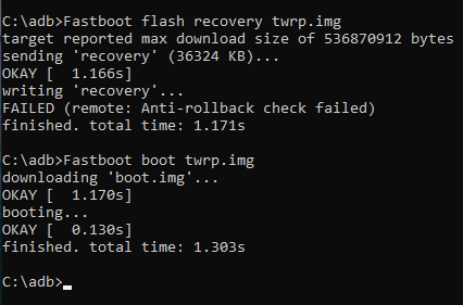

Hello. So I unlocked the bootloader after 15 days of waiting, flashed TWRP and then tried to update from Chinese miui 9 v9.6 before anti rollback update. Now I am in bootloop. The phone gets on Mi logo, then on Mi logo and android. Then it goes black screen and restarts. What do I do? Stupid of me, this is my main phone.
