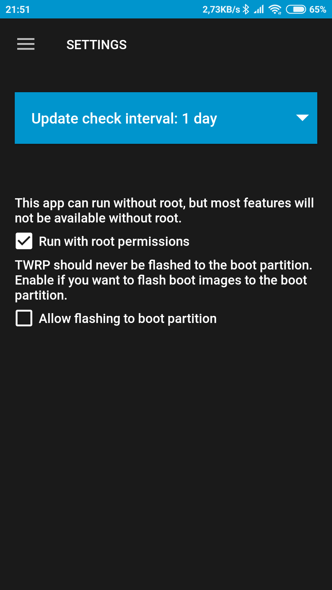

Should the lower option in settings of TWRP (allow flashing to boot partition) get checked or not?
Thanks in advance.
