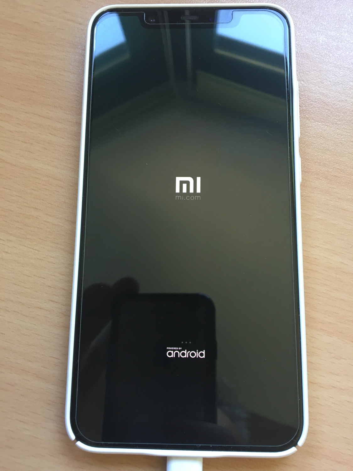

Hi, I have just upgraded mi M8 from 8.8.30 to 8.9.24 via TWRP,
DOWNLOAD WEEKLY 8.9.24 MI8
https://sourceforge.net/projects/xi.../files/xiaomi.eu/MIUI-WEEKLY-RELEASES/8.9.24/
however when it restarts it keeps on the inicial screen : MI mi.com the dots... powered by android, and does not start
any ideas???
thx!!!!
I need help... After that via TWRP I installed 8.9.20 to see if this way I could solve my problem, but still it does not goes beyond the loading balck screen!

I have the same problem, using the latest twrp. If you reflash 8.8.30 again, and if your camera doesn't work, the standalone firmware for dipper, you can at least use your phone again. I'm stuck on 8.8.30 as you, searching for a solution without wiping data.

You have to wipe data and start with a fresh installation after going from (Android 8 based) 8.8.30 to (Android 9 based) 8.9.24.
Did you do that? Wiping Dalvik and Cache is not enough.

So if I get it right, first I wipe Dalvik + Data + Cache
then i proceed to install 8.9.24
am i right?
thanks a lot for your help!
