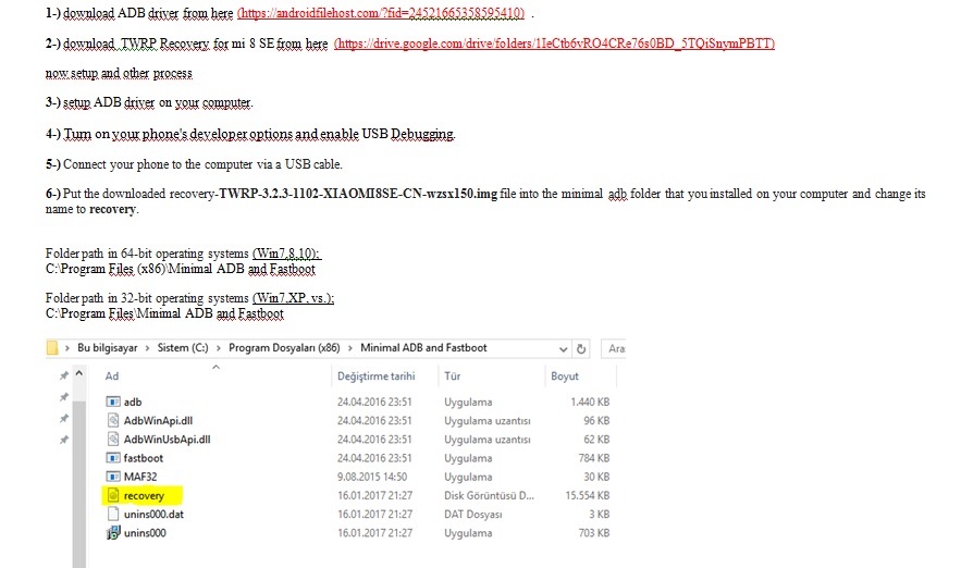

Ok, 24 pages on this thread and i cant figure out how to fix my fastboot bug on mi 8 se after flashing this last rom.
Can someone help me out, everytime i try to flash recovery, wen i try to reboot to recovery it always gives error..
Yes ive tried the suposed tutorial on page 10...
I need help with my Mi 8SE, i cant do anything. Im stuck in the fastboot, i cant boot in recovery and i cant flash a recovery, i feel so lost :( My device is listed when i type "fastboot devices" but when i try to run "fastboot flash recovery..." it doesnt work. Can someone give me a step by step guide how i can install a recovery now ? Hope someone can help me out
Just do flash via Xiaomiflash to last China Miui rom, flash recovery (twrp), install last Xiaomi.eu rom from twrp.
Yeah, I wipe the data,dalvik and cache before installing. What could i have done wrong else ? I am trying it again and again but cant get it work :(
Wipe isn't the same as format
