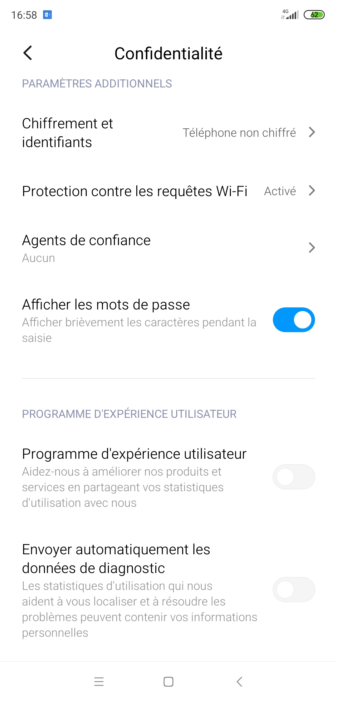

How to encrypt mi 8 ?
I clean flashed, charged battery, when trying to encrypt in settings, nothing happens.
Using orange fox recovery and Magisk 20.

I ask because my phone isn't encrypted, came from syberia os aospadb shell getprop ro.*****.state
So? What does it matter? By formatting data you remove encryption any way :) Just reboot to TWRP if it ask for pin, your data is encrypted and with EU ROMs like with official, it's encrypted by default.

Just saying that my phone is not encrypted, and when I try to encrypt it, just nothing happens. So I'm looking for a solution !
(No pin asked in twrp, settings in Rome says unencrypted. and yes I have a pin and fingerprint unlock)

Do you have access from TWRP to data/sdcard?
What ROM you have, what TWRP ?
No pin is asked in twrp ... 3.3.1-1 official or mauronofrio version, nor orangefox.
Full access to sdcard in twrp.
Rom is the one of the thread, obviously
And See screenshot
So like I said, I'm trying to get encryption working, 'cause my phone is not encrypted
And See screenshot
I don't understand the language :)
Have you decrypted it before of installed patches for disabling encryption or may be disabled force encryption in magisk?
When you saying clean flashed does it mean that you made data format?
Yes I decrypted phone, previous aosp rom I used, syberia os, wasn't encryption compatible. So just trying to encrypt now.
Formated all partitions, including data, before clean flash.
Then i would try to flash fastboot ROM and make clean flash of EU ROM. Something is not right, your device should be encrypted.

Decrypted as in formated data using adb in fastboot mode.
When clean flashed eu rom, I just formated using twrp, so it was just a wipe.
Thanks, I will format data and clean flash next version then, lot of work to get all back to work.
