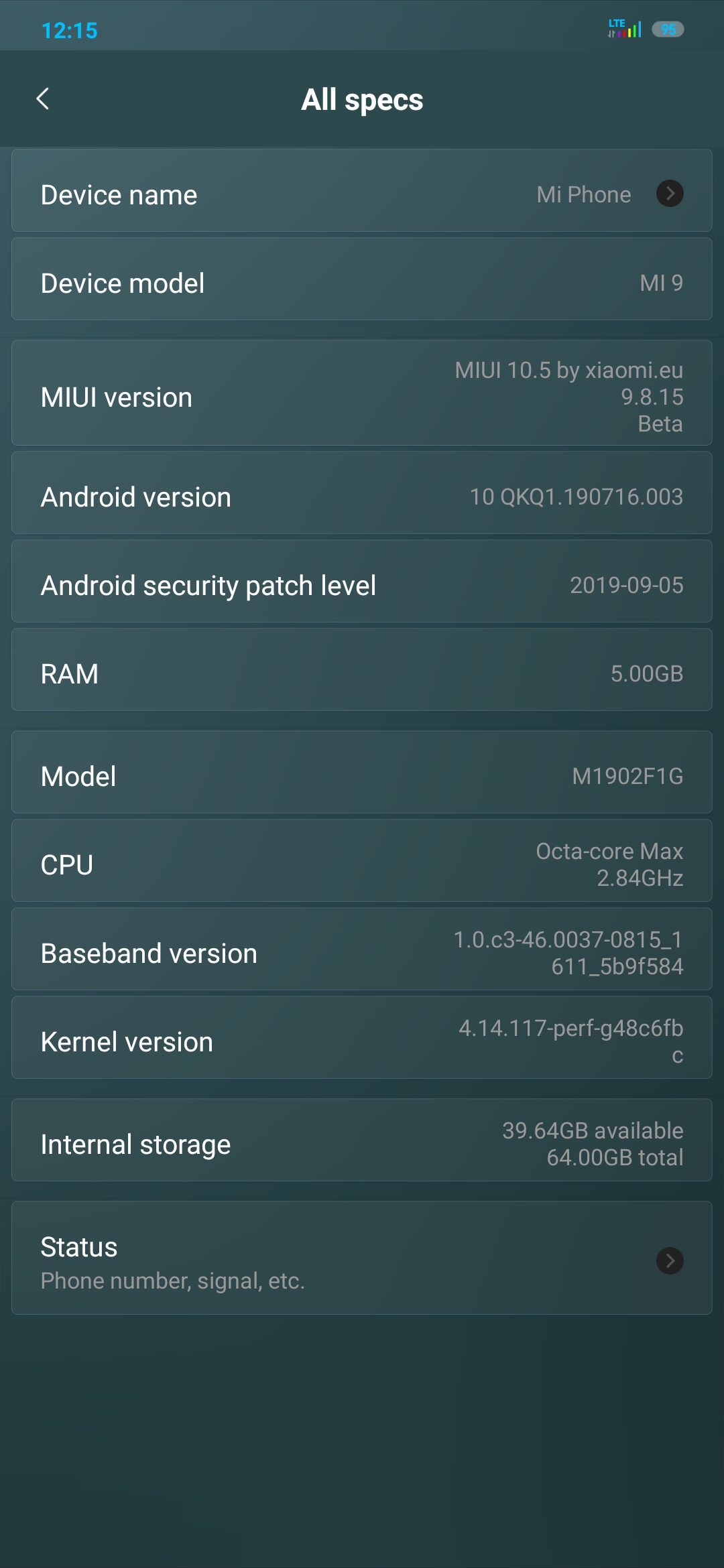

Why it shows 5 GB ram if my device is 6 GB ram.
