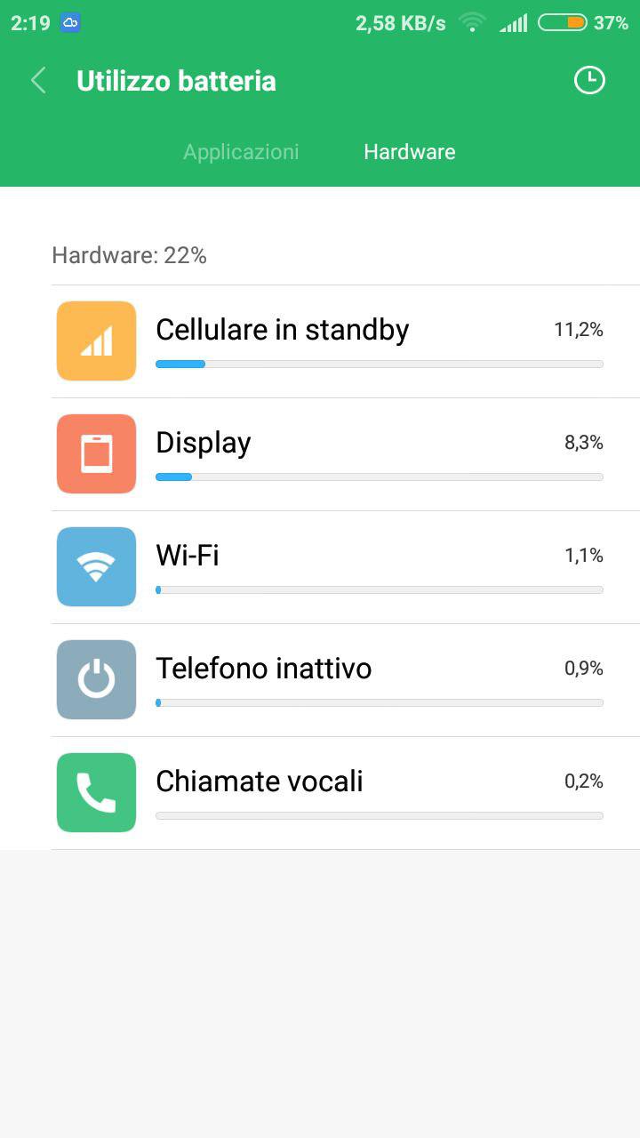

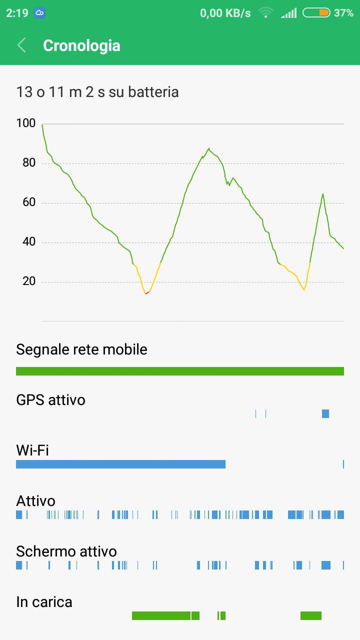

    This is my default day, notice recharg time is more than discharge
    Now I install and calibrate the new battery, in a few days I post another report for it [​IMG][​IMG][​IMG]

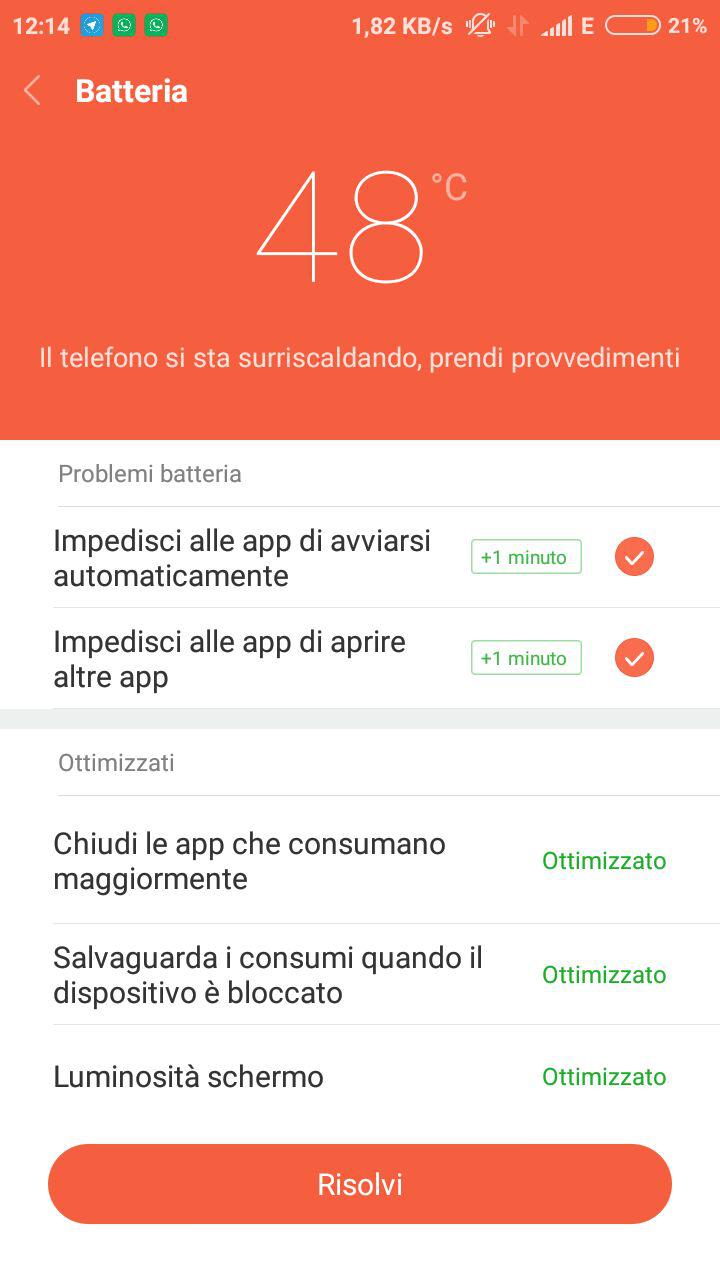

    After few days of testing I can say that anomaly battery drain and heating still present, I notice a little bit battery duration and a bit faster charging, but in this state is impossible to arrive at the end of the day without a plug.
