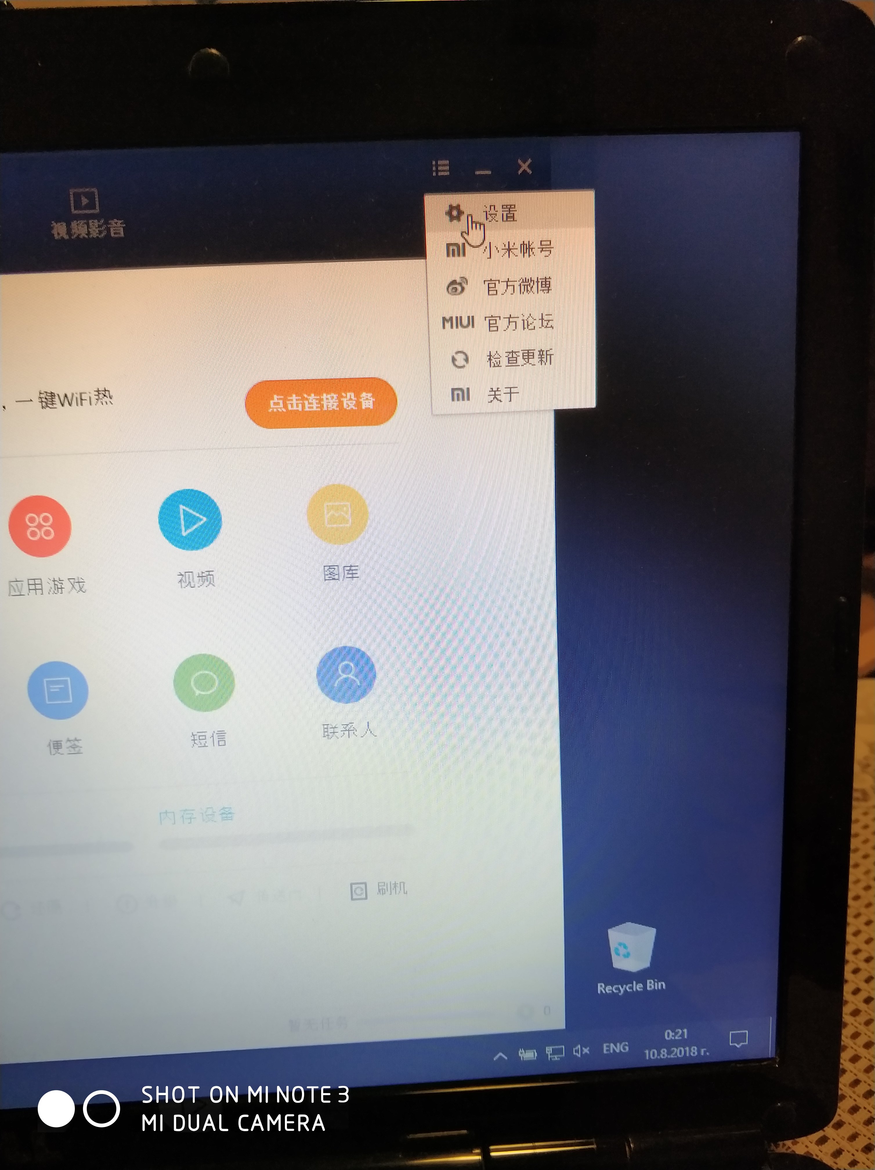

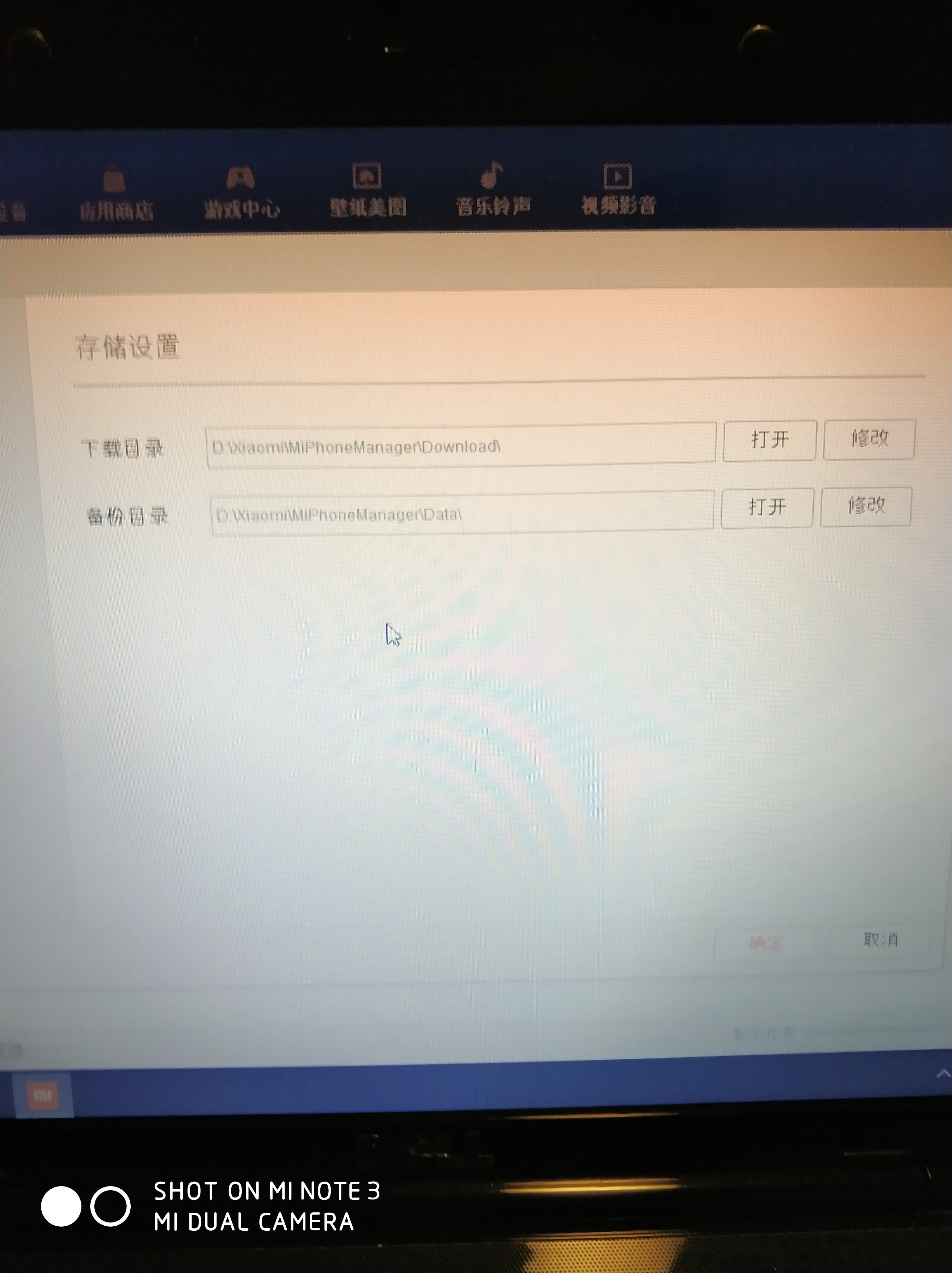

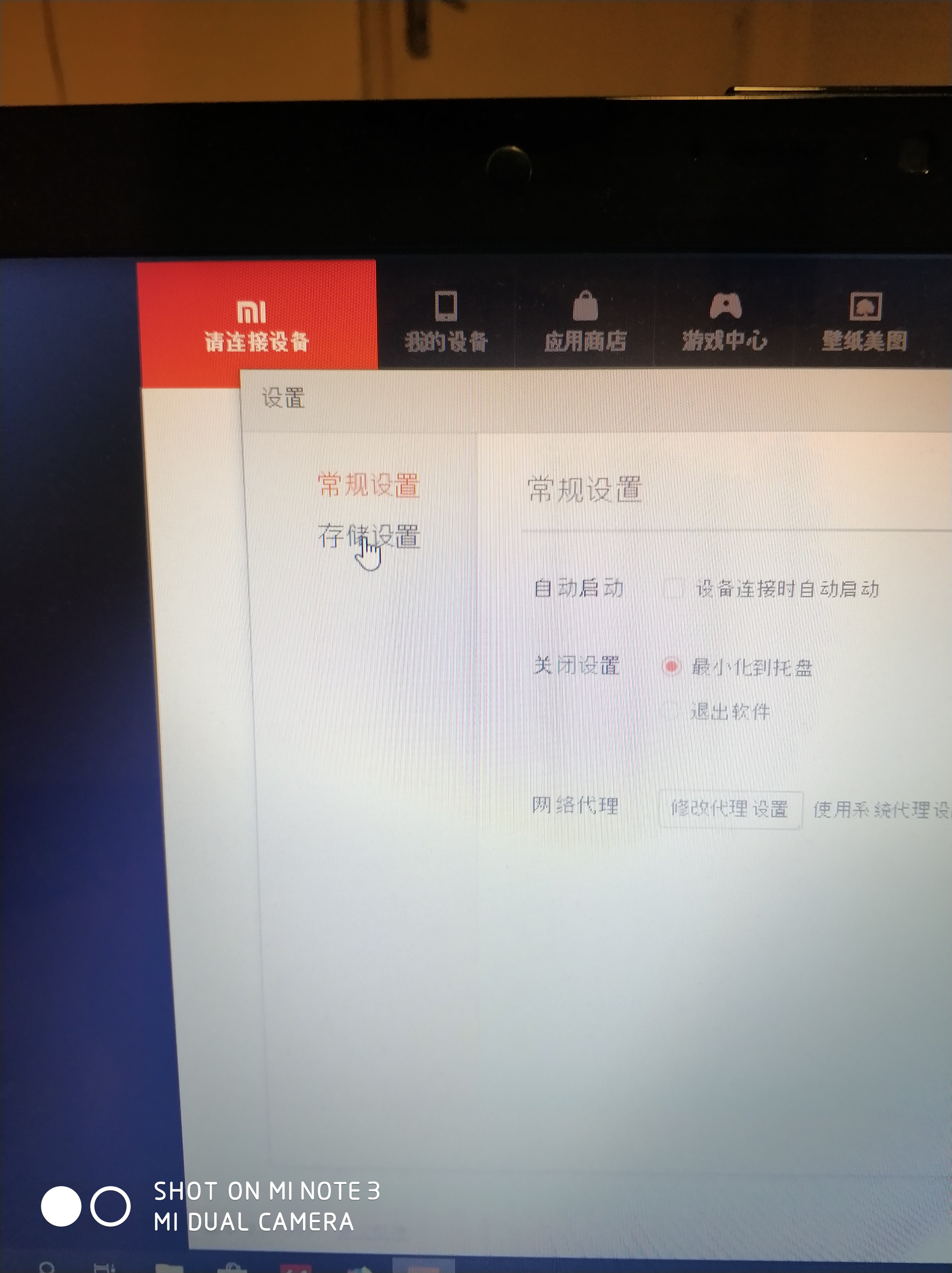

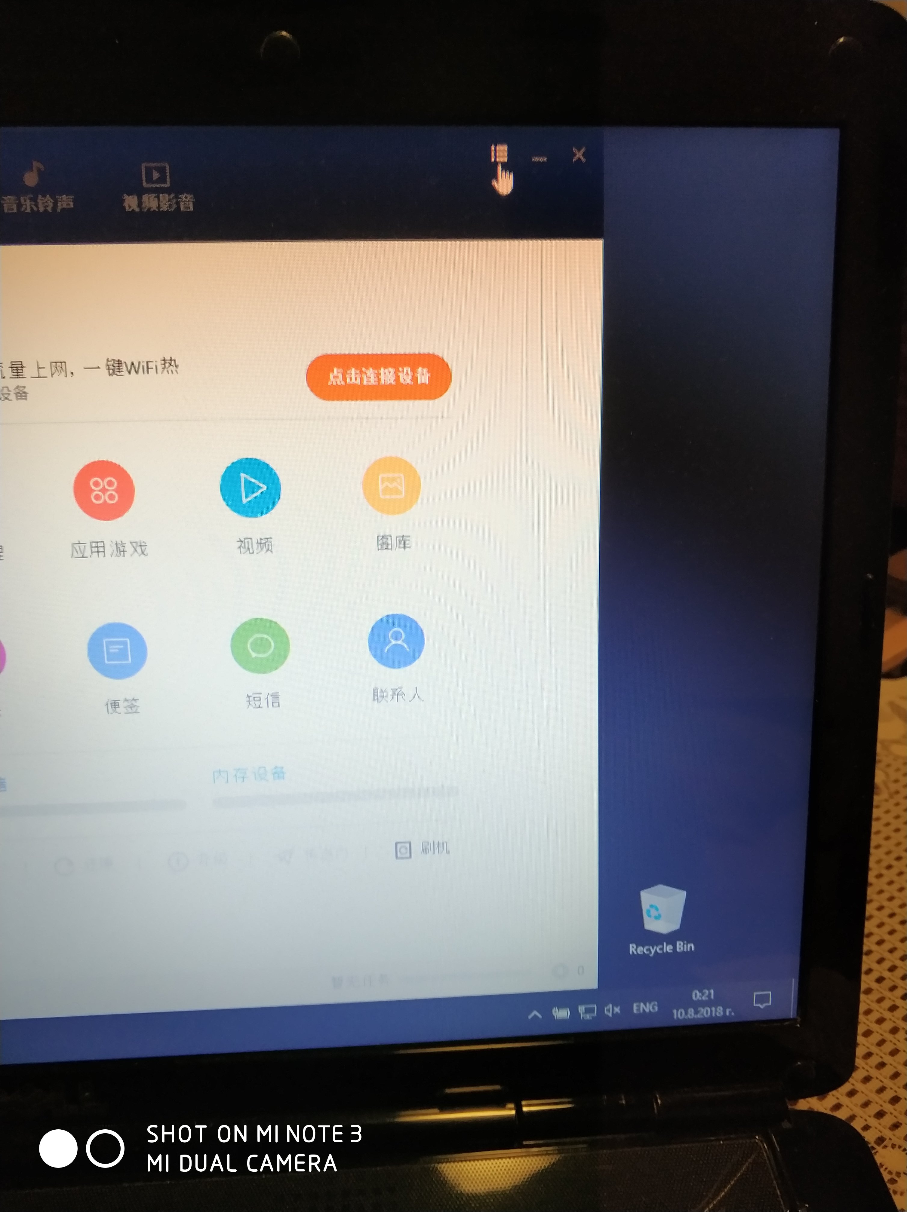

Download the rom manually and place it in the Download folder of Mi pc suite and try to install it. For me the Download folder was in D:\Xiaomi\MiPhoneManager\Download
I dont have a download folder in that path
Hi see the mouse cursor and you will find where the folder is:

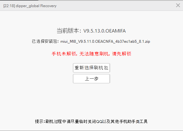

It allows me to choose a rom now but gets stuck at 3% or 11% and says somthing like retry (translated with google translate)
I got this far now
I read that (from the image): your phone is not yet unlocked, please unlock your terminal and try again
The problem is how to unlock it when the phone goes only in recovery mode. If the bootloader was unlocked it will be easy - flash fastboot rom with MiFlash.
