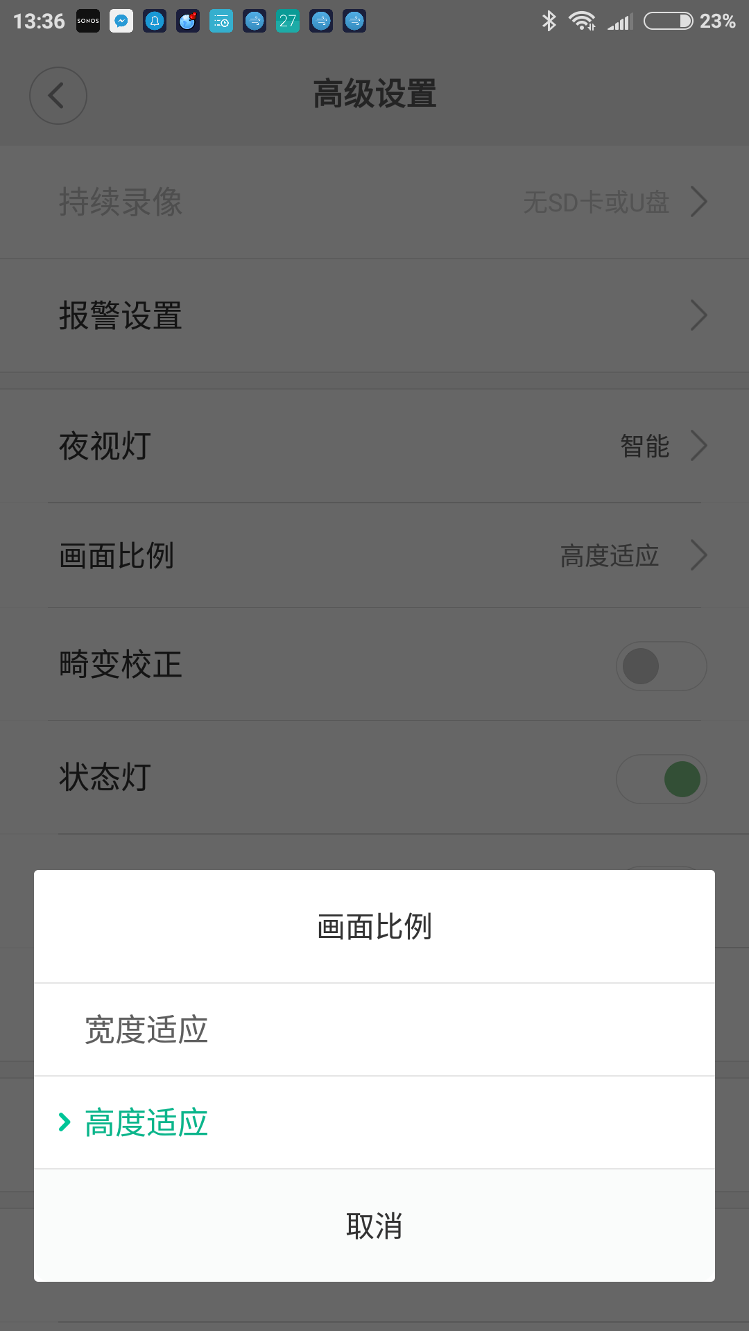

Hi fellow dutchies and EU neighbors :)
I guess it is no rocket science to let this camera work in Europe. If you follow the steps above from cpocarlos you should get it to work. Still, I want to add some things I discovered yesterday.
When I role back mihome to version 4.2.5 (app store) the camera worked and also the plugin. I knew version 4.3 wasn't working so I tried version 5. Strangely enough it is available and have a total different look. Maybe it's a beta or something. I found it here . So I installed version 5 (coming from the working 4.2.5) and I can look at the camera! Because mihome had a totally diffirent look you can see a preview of the camera images in some kind of popup. When you click on the popup the plugin is opening....unfortunately the plugin is not opening for the defang. All my other xiaomi devices (I have 4 :)) are working but not the defang. I guess if it is a beta there is no plugin yet or something? Maybe you guys can experiment with this ?
So now I'm again on version 4.2.5 so I can watch en control the camera. BUT...there is bit of a problem. Version 4.2.5 has very pore English translation and there are a few screens that are totally abracadabra for me. So I REALLY hope there are some Chinese speaking guys or girls around here that can translate the setting screen. I made some screenshots of the different screens .....
Would be realllly appreciated!

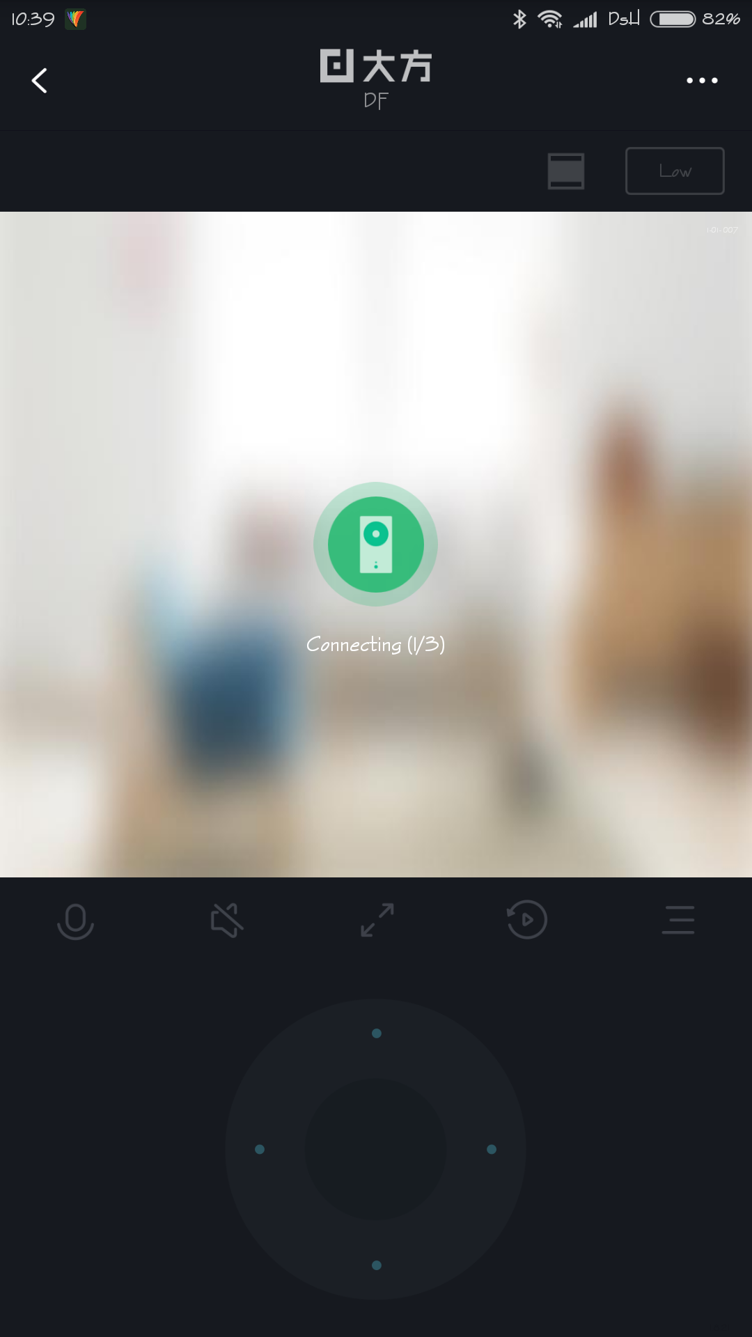

Hello friends.
Im getting kinda frustrated with this Dafang camera.
Im on version 5.0.10 now i can connect to the dafang camera's i have 2 when im on my Wi-Fi.
But when i try to connect from outside on mobile network or another Wi-Fi network connection failes.
While my Yi smart camera always works.
No mather where i am.
Sometimes it does connect when im outside but mostly it does not work.
I do get this message : connection time out retry after checking unobstructed.
And then the camera start again with connecting 1/3
Does anyone have an idea what the problem could be?

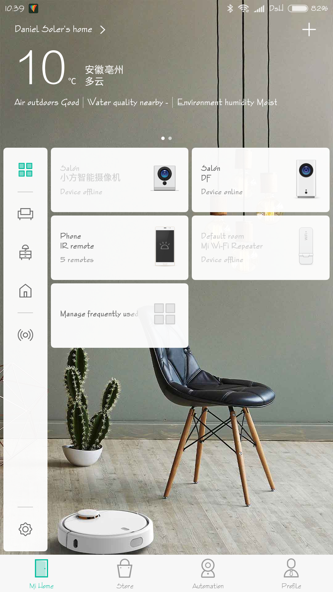

Guys I have exactly the same issue. I have added the device to the Mi Home list and is shown online. The light on the camera is blue fixed which confirms it is online. I'm using MiHome ver. 4.3.15 downloaded from the official Xiaomi Store (app.mi.com).
I have set the country as China Mainland and the language English.
If I click on the Dafang in the MiHome list nothing happens. If I click on any other items in my list, the relevant plugin starts correctly.
As nothing worked, I have tried to update the camera firmware and also to delete and re-add the Dafang, but same issue as before.

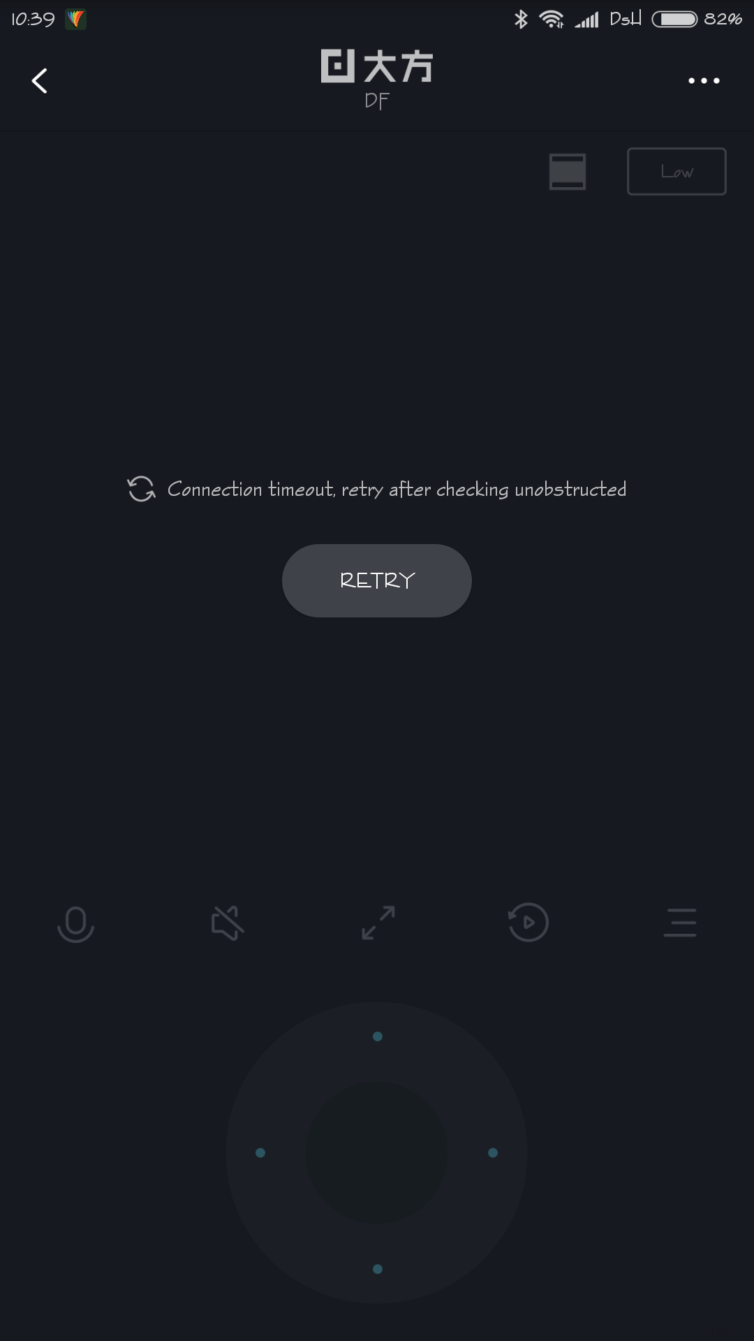

I have tested everything in here. My Dafang camera was working great for a month, now I have the "Retry" message. I can reset it , I can pair it, I can do everything but connecting to the live video image.
I have tried Mi Home 4.2, and the latest 5.0.19, no luck. I have the latest firmware on the camera also.
Any ideas?

Magic, it started to work again today out of the blue. Maybe it was a XiaoMI server overload issue.
