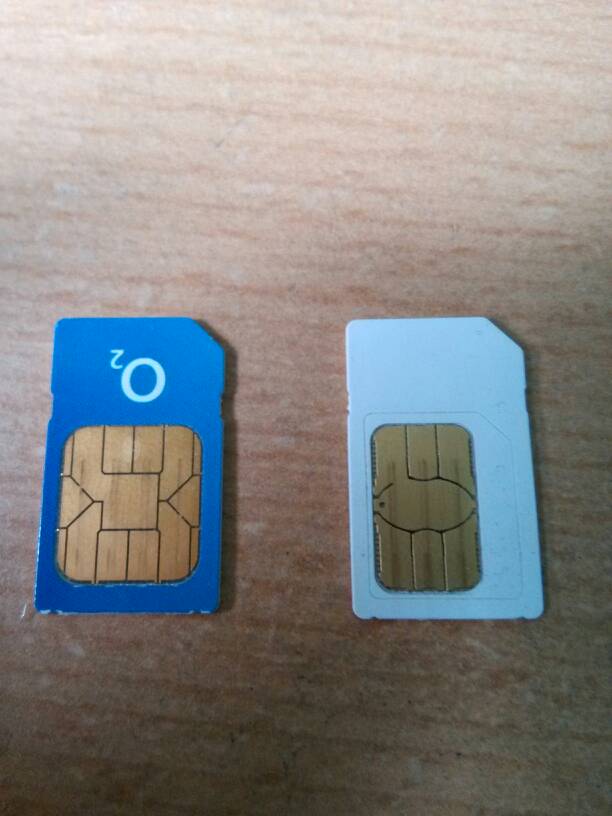

Apr 1, 2013
22
#14
on the left a normal sim card.
on the right a micro-sim (from congstar) with frame to normal sim.
if i put the normal sim card size into the mi2. All sim options work.
sim contacts, fdn mode .........
put in the right. No sim contacts.........
_______________________________
Gesendet mit Mi2 (ohne "s") via Tapatalk 2

I dont understand. As i imagine i need that frame to keep micro sim to not move
Sent from my MI 2 using Tapatalk
that's right. The only thing is, you cannot backup your contacts to SIM
