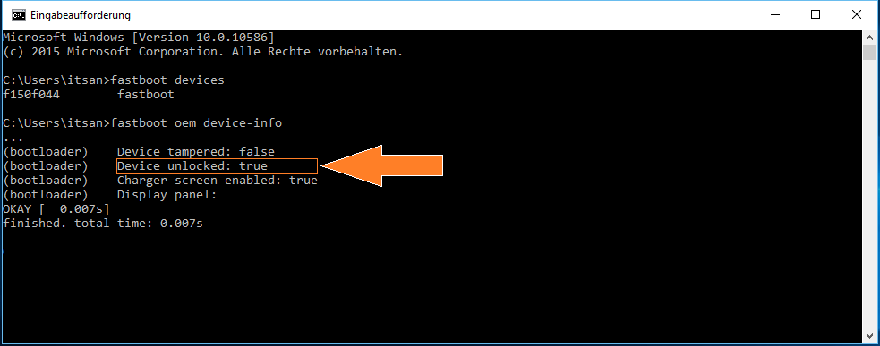

Check if your BL is locked in Fastboot mode:
Edit: He solved it in thread https://xiaomi.eu/community/threads/how-to-easily-install-twrp-recovery.30484/page-6#post-389559
