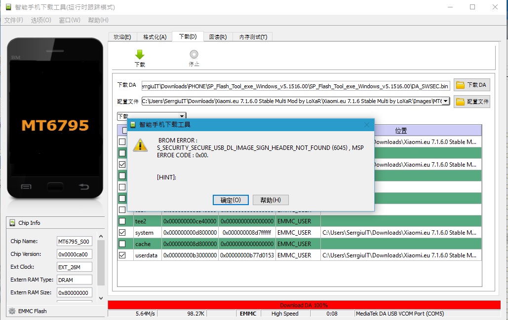

Did you install drivers? Anyway try again or change usb port or reboot pc...if I try to flash this on a locked bootloader i receive this View attachment 11294
is not from drivers because if I flash with the same spflash, official stable/developer miui rom, everything is OK, no error !Did you install drivers? Anyway try again or change usb port or reboot pc
Did you use another spflash? Because in your screen I see chinese language. You have to use spflash inside loxar pack that is in english.is not from drivers because if I flash with the same spflash, official stable/developer miui rom, everything is OK, no error !
I used the one from MIUI official because the one from loxar contain virus!...did you know where to get one virus free?Did you use another spflash? Because in your screen I see chinese language. You have to use spflash inside loxar pack that is in english.
No virus, don't worry! I use it with antivirus installedI used the one from MIUI official because the one from loxar contain virus!...did you know where to get one virus free?
..I have tested with Bitdefender and Microsoft Defender...result not ok !No that is not true. Virus free. I checked with nod32
