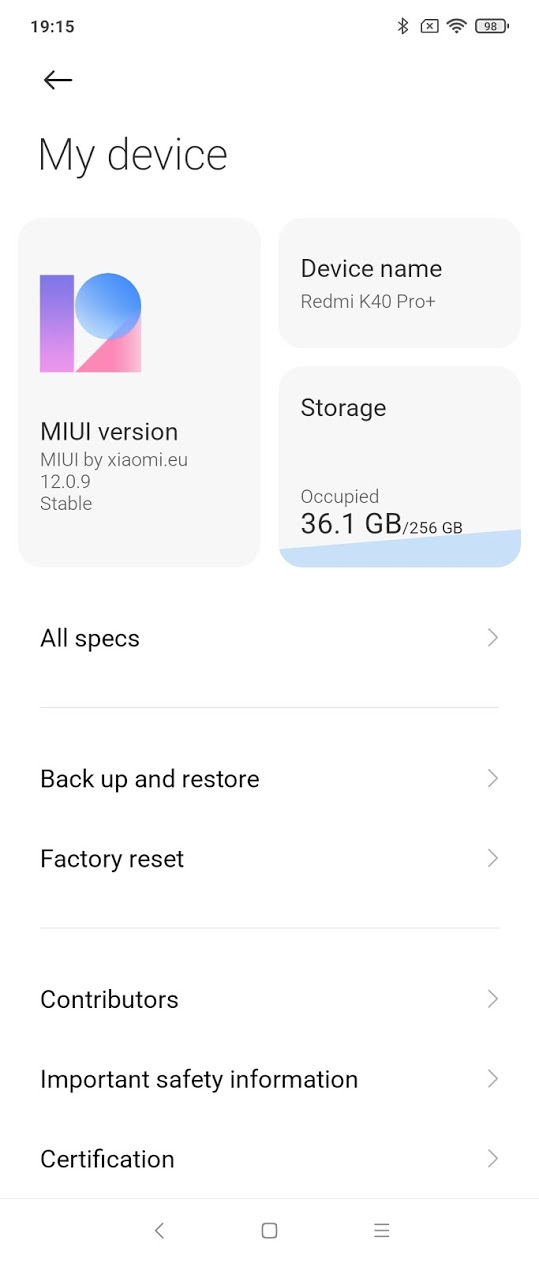

I stucked for two weeks.OK - LOL, I have no idea how I did that. I fixed the phone. 0_o
Just random flashing with various combinations of images resulted in it working... Don't ask me how - suddenly the behavior changed. Been doing it for like 2 days straight. I am on Xiaomi.eu V12.0.9.0. Not gonna flash the newest ROM cause I'm scared now.

I believe I flashed Xiaomi.eu latest, it failed (on slot-switch), flashed Xiaomi.eu latest, it went through but didn't boot (Bootloader bootloop) and then I flashed Xiaomi.eu stable (same slot) and it suddenly worked... 0_o
Cool! So together with @max.ouyang 's observations we're getting close to a reliable solution to the bootloop problem. I have to admit, I managed to soft-brick my phone again after fixing it by trying to flash Xiaomi.eu 21.4.22 but also managed to unbrick it as well by using a similar procedure. I think Power + Vol- is optional, so is the slot-switching, the important thing is:I had same problem followed above
I flashed Xiaomi.eu stable on slot b, it completed but still in boot loop
Flashed Xiaomi.eu weekly on slot a, it hanged on Setting current slot to 'a' so I rebooted phone into fastboot (Power + Vol-) it finished but went to fastboot again
Then flashed Xiaomi.eu stable on slot a and it rebooted correctly into MIUI
Why it works ? ¯\_(ツ)_/¯
Anyway thanks for tip man![]()

I was on the latest China ROM through the updater and the first ROM I flashed was the weekly ROM, which never worked for me, even after a cycle of 2 successful flashes/unbricks. Now I'm at V12.0.9.0.RKKCNXM indeed.Your story scared me the most ngl chief :')
If I'm on 12.0.9.0 then I'm supposed to use xiaomi.eu_multi_HMK40Pro_MI11i_V12.0.9.0.RKKCNXM_v12-11-fastboot correct? Like nothing else is actually needed? Also did you flash the correct rom yourself that had a stable release before u got the brick? I was genuinely confused as to what caused yours
Generally, if your flash fails (e.g. upon swiching slots, which is what most people got hung up on according to the thread), you should still be able to go to Xiaomi.eu V12.0.9.0.RKKCNXM.
Funnily enough, I'm unable to go back to China stable anymore though.
