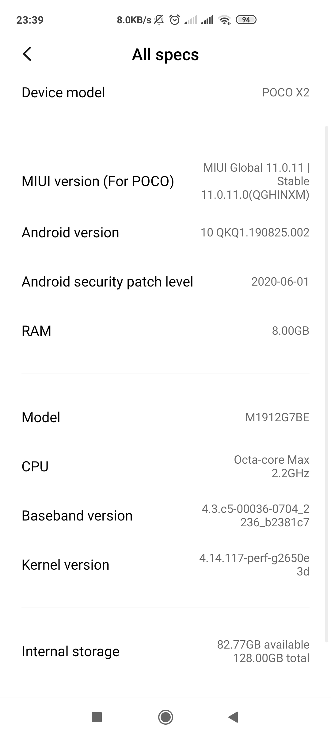

Hi, i have poco x2 , as far as I read its k30
This is indian version what i was told on xiaomi forum.
Can i flash it to use normal eu software as Indian have no updates or they are very slow. All the rest are on miui 12 but indian ver still on 11.
Screenshot shows different ver of baseband and kernel.
Thank you in advance

All is working fine . No Magisk, no Root
